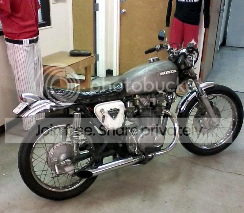

A few pics. I am trying to build this bike using as many parts, pieces, tires, etc that I have laying around as possible.
As I found it.
A few mock ups and mods. Humble beginnings.
Bike is now running and starting with the electric start, neither of which was functional when I got it. The original wiring harness was butchered with no switch and quite a few dangling wires. I scrapped it and have built my own simpler harness that uses a keyed automotive type switch with a momentary starter switch(that I mounted in the right side cover, Brit style). I have yet to wire in the charging system but so far, so good.
I have pulled the rotor off 3 times so far to attend to the starter clutch as the plungers were stuck in their holes and one re-stuck after cleaning, polishing and reassembly. I figure one more stuck plunger and I will have to spring for new rebuild parts....sigh.

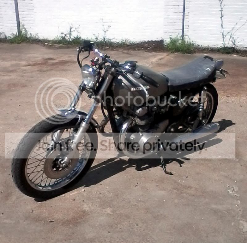

Flugtechnik said:
Interesting headlight mount.
Yeah it is, I'd be making sure those clamps stay tight as the bottom fork clamp does all the weight holding pretty much. If they slip that top clamp just might snap instead of holding them.
I have considered flattening those ends somewhat in their final version and getting slightly longer bolts, maybe locktite them to. Very good point.

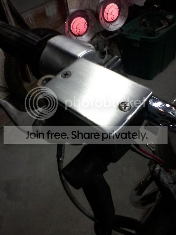

Good lord why does it have such a long ass brake hose? :o
Like the key in the side cover though, what are you using for air cleaners?
I want those bars too.
The hose is that long because it's what I had. In the final rendition it will get an appropriate length braided line. I'm using Unifilter foam clamp on filters. Those bars are Norman Hyde "M" bars.
I added some OOS (Old Old Stock) aftermarket shocks that still have damping and are sprung close to right. No doubt they are of top quality since I did see "Made in Mexico" on the shock body when I stripped them...lol.
If you look at this thing from just the right angle, with the right kind of eyes and squint, it looks almost pretty good...lol. To me it's crying out for a set of chrome Triumph style TT pipes that exit under the engine.
