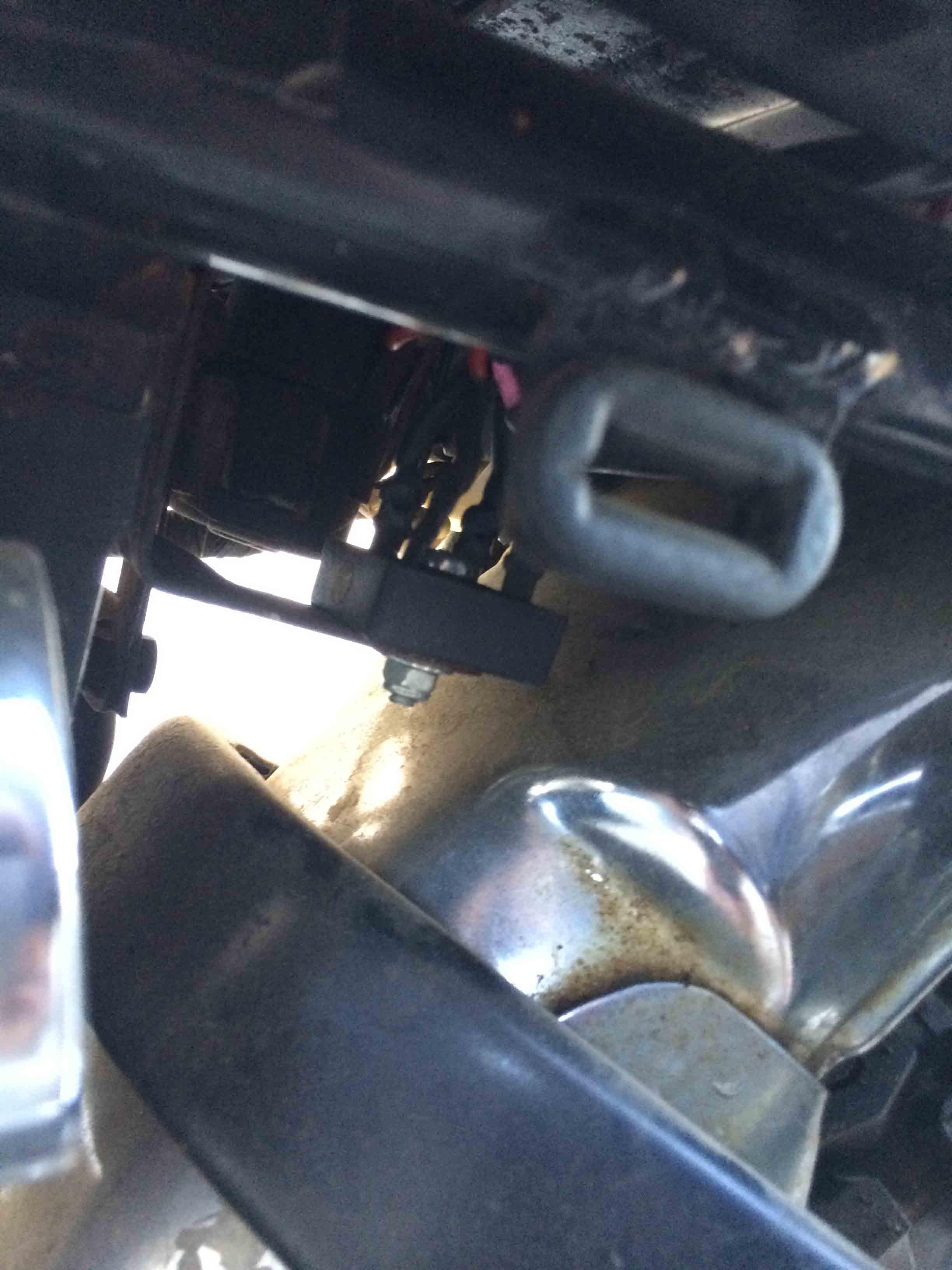

Ok I have one more question for the CB450 gurus here, I have been trying to get my rectifier replaced with a regulator/rectifier combo unit and all i found was this thing where the rectifier should have been. From the cmsnl page (http://www.cmsnl.com/honda-cb450-super-sport-450-k4-1971-usa_model452/partslist/F++25.html#results) it doesnt look like either of the rectifier they have listed there for cb450 k4.
I am not sure if I am looking at the right place, Help!
The first two pics are of the rectifier (?) on my bike and the other two are the pics of the two rectifiers I found on the cmsnl site for cb450 k4.

What you have is a new modern silicon rectifier. The PO replaced the old silenium one. The one you have is much better. I did that mod.
If you want a new modern reg/rect combo a member on here, sonrier sells the at a great price.

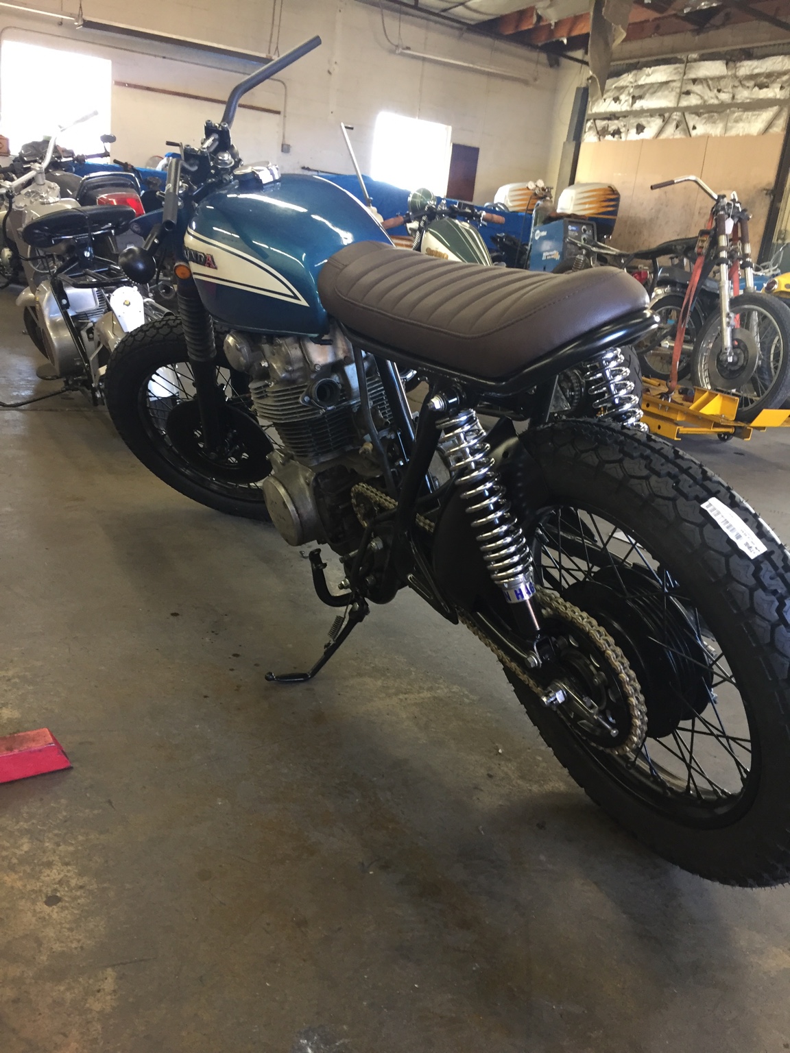

Finally got some time to work on the bike and got it to work with the new mikuni vm32 carbs. Also got the all important registration. Now I can test ride the bike. Also got new mirrors :)
It also seems like carbs needs more tuning as bike dies when downshifting to a stop.

I'm jealous, 450's are one of my favorite bikes and you have yours looking pretty cool.....

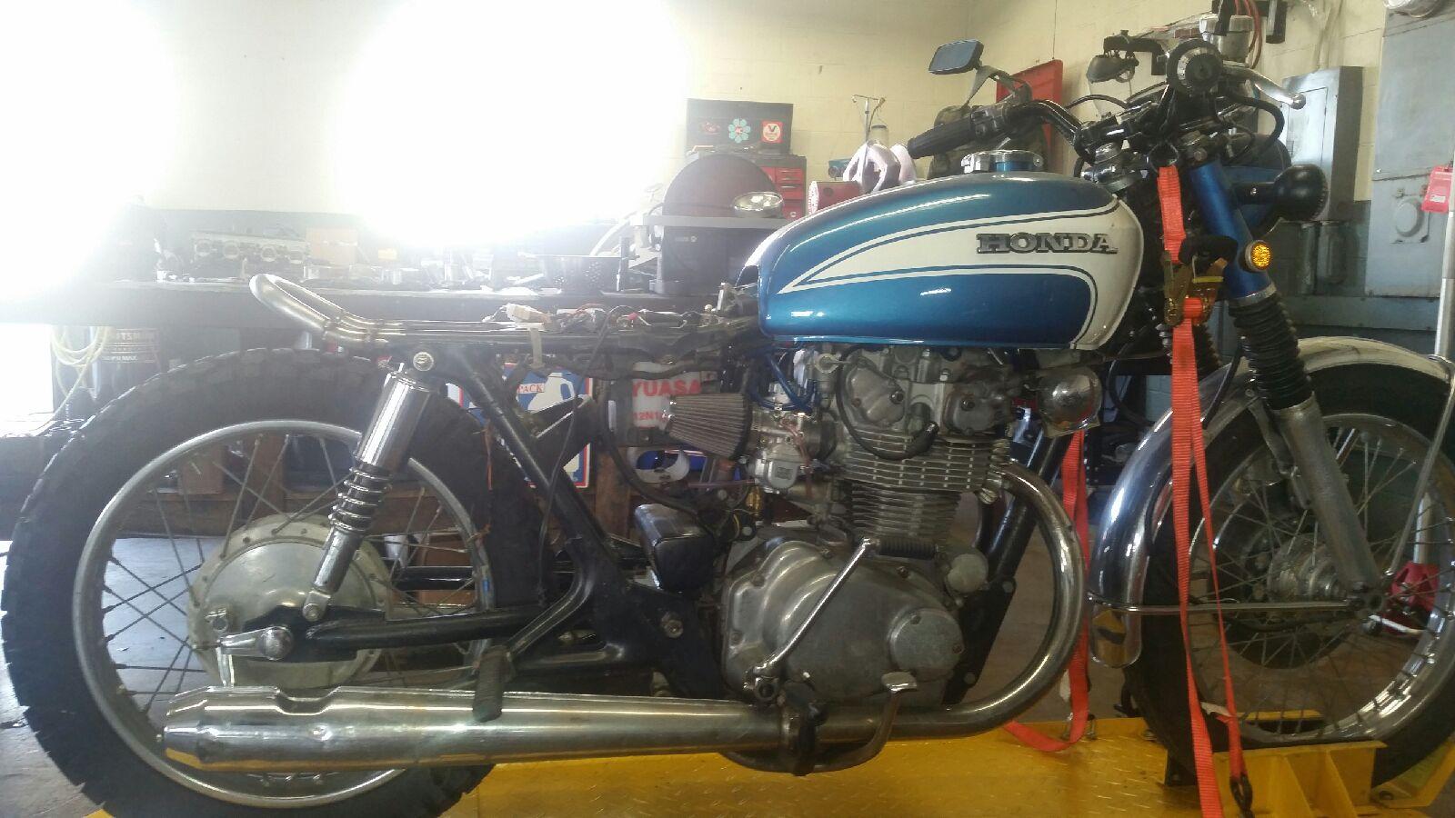

alright some improvements. Got the rear loop tack welded in there and swapped out the swing arm with that off a cb360.
Next up battery boxes and electricals.

finally got the seat all tucked in and also new rear fender.

i don't think you have enough clearance between the fender and the tire. It looks like only an inch, your shocks will compress more than that.
I haven't replaced my shocks yet. I have nice 13.2" hagons which I am gonna put on instead of the stock shocks. that should give enough clearance :)
Also the fenders are not yet attached to the pan in the pics, once that is done there should be more clearance
