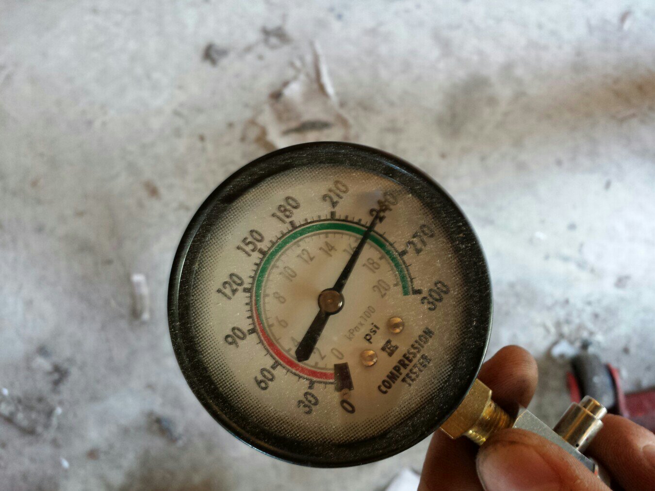

last time i've check the compression was new at 200psi. I'll recheck them.
For the noise, I've tried the screw driver trick but still I can't really tell what noise should be there and what other not....
