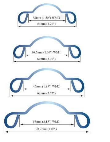

FYI:
wow. you have no idea what a help that graphic is.
much, much obliged.
the dark clouds of ignorance have parted. (at least in this one, very specific part of my life)
