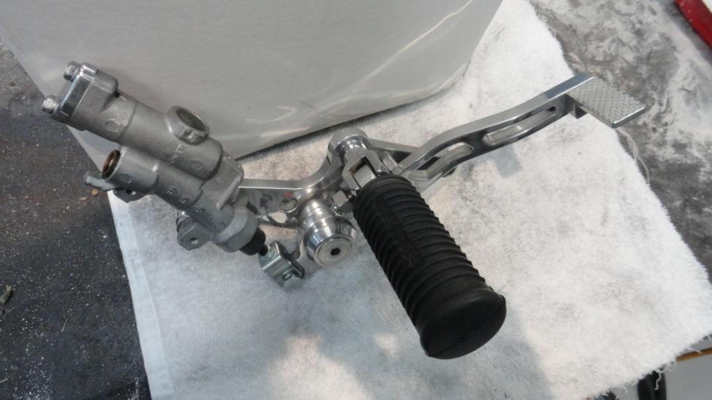

My brother came over today and started sanding all the aluminium back and I started buffing it. We assembled the right hand footrest and it looks pretty good. Onward and upward from here haha...

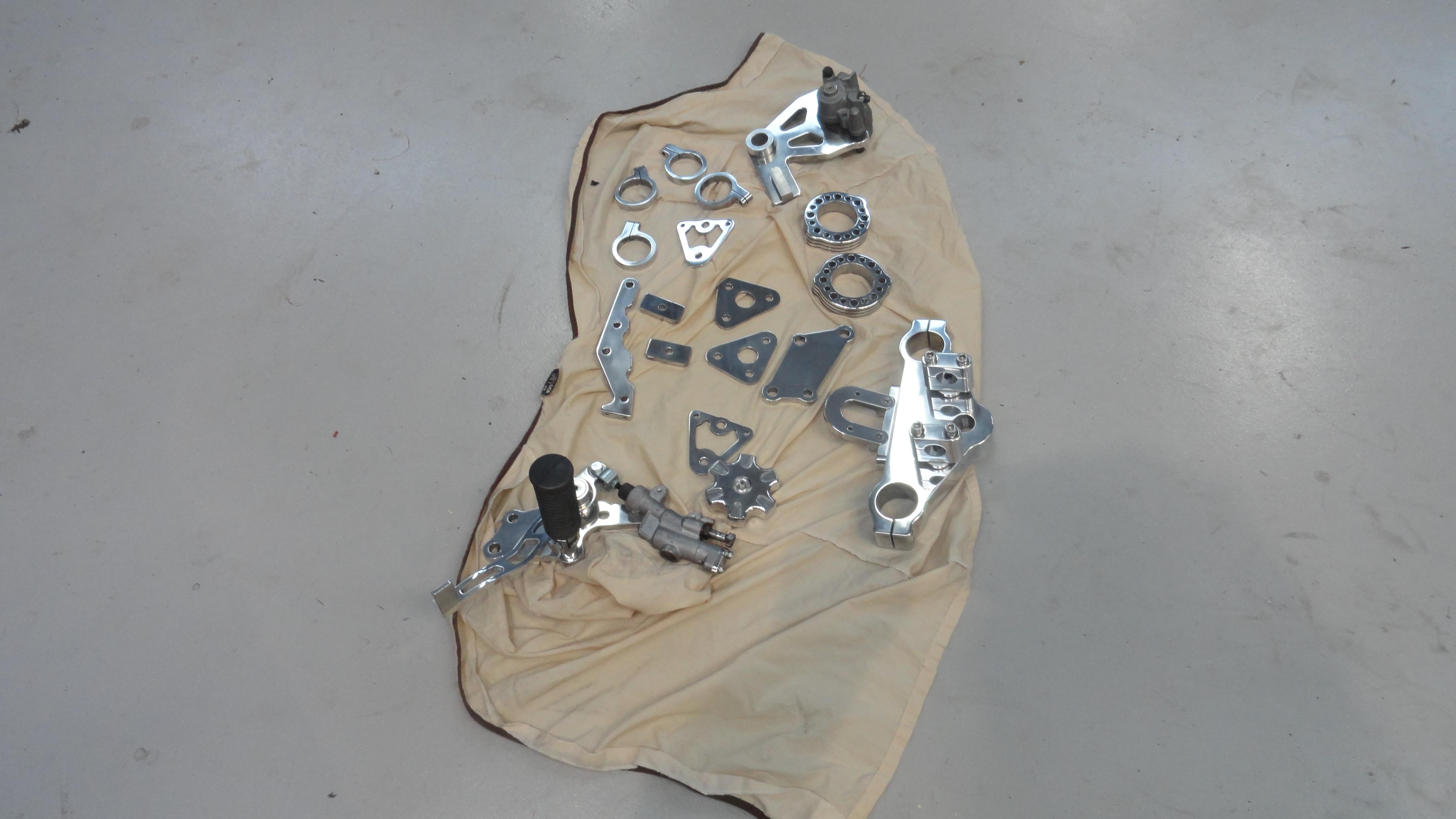

Spent the day today with my brother, he sanded, I buffed. The bottom triple tree is finished, just not in the picture. All looks OK, we'll start rebuilding the motor next.
