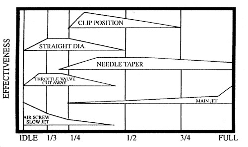

You need to do a plug chop to determine where your a/f ratio is. Below 4000 rpm (and above about 1/4 throttle), it will be needle clip position. Main jet sizes are affected by the upper throttle position to full open. The lower part of the throttle is affected by the slow speed jets. Surging could also be float height.

I found this chart to be a great help for visualizing which circut is doing what at a given throttle position:

I was going to post that same chart but didn't have it handy.
