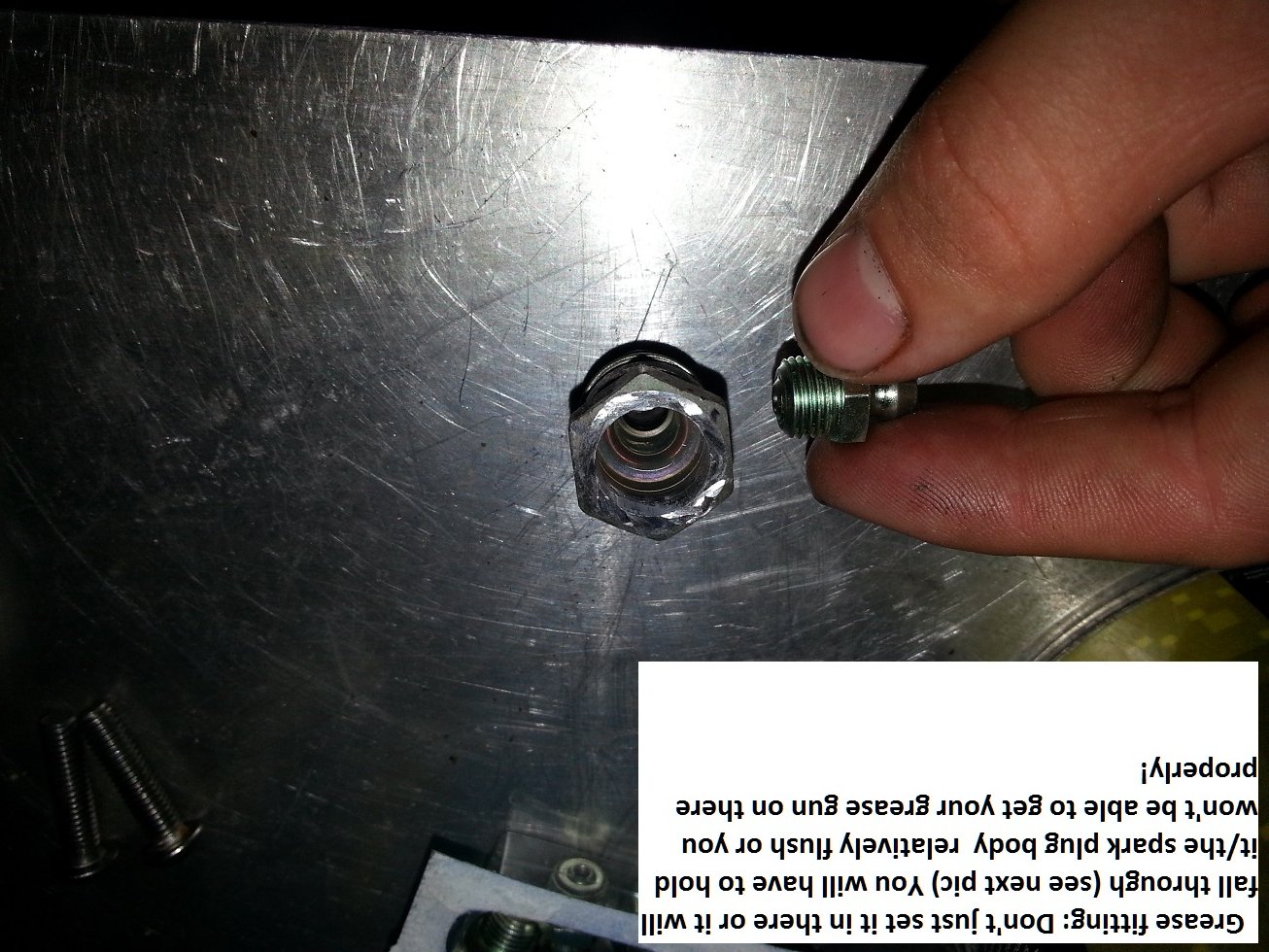

Redliner, for you my friend, I have got the parts needed and will get cracking on it. My apologies for the slowness of it all...house projects as my first kid is on his/her way in less than 9 weeks now! I'll post a little how-to with pictures if you haven't seen it before.

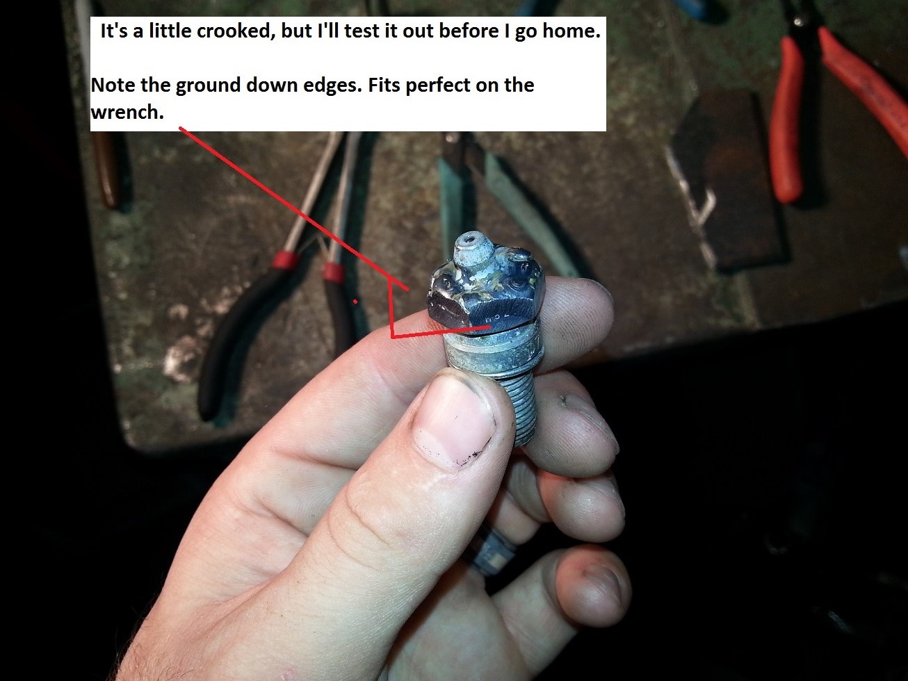

Here we go! Got some time on a break here at work. Will weld before I go home tonight!

Second set of pics.

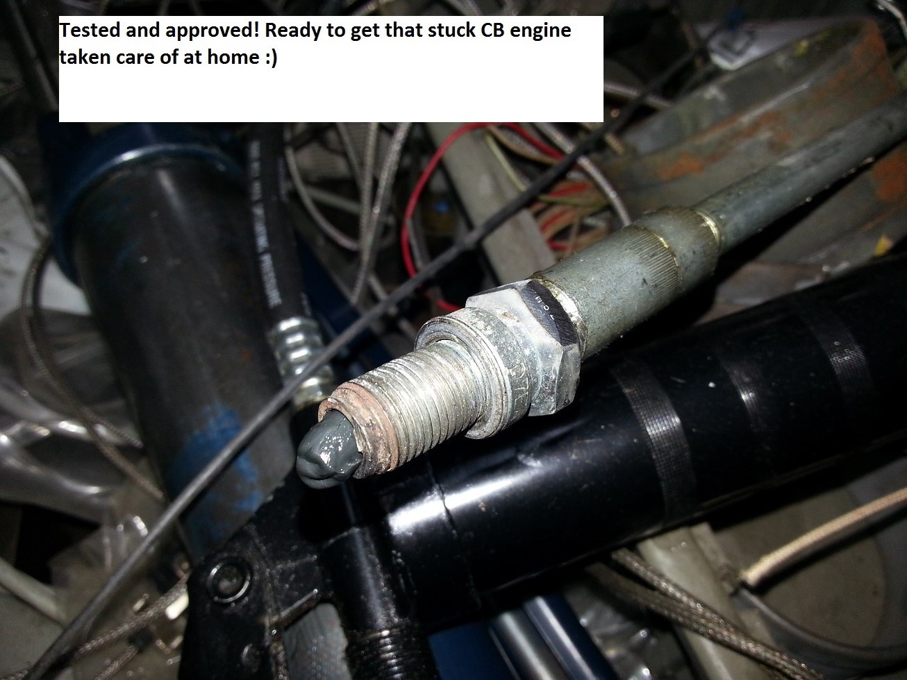

Thought you might like it! All finished up.....
I want to note that this is NOT my invention by any means. I haven't seen the best write ups so I thought you guys might like this if you haven't seen it before. Worked like a champ before. Crossing fingers this time! (I've got that CB550 engine and another CB500 engine to free up too! ) ;D ;D
