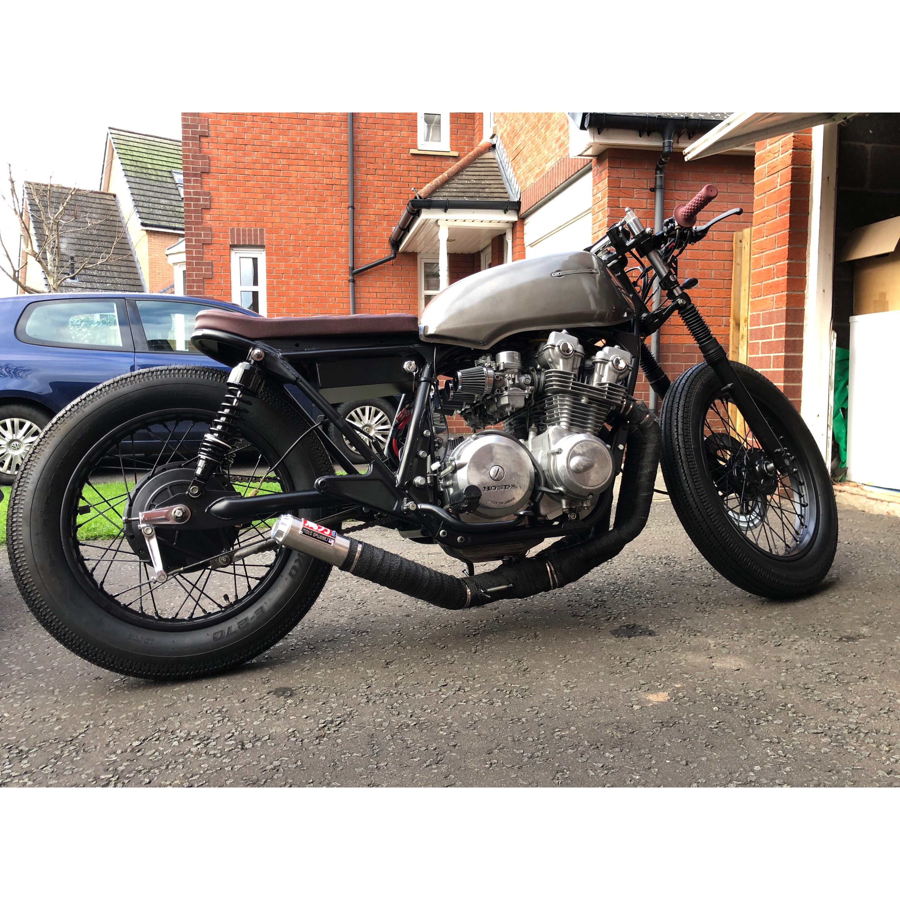

Hey Guys,
I'm in the middle of a rebuilding a CB750 1981;
This is my first ever build and It's been a whirlwind of forums, google, youtube and a local motorcycle shop to get me on track to this point.
However, I've hit a bit of a snag; the bike wont start / fire, and I wondered if any of you can help out with some advice...

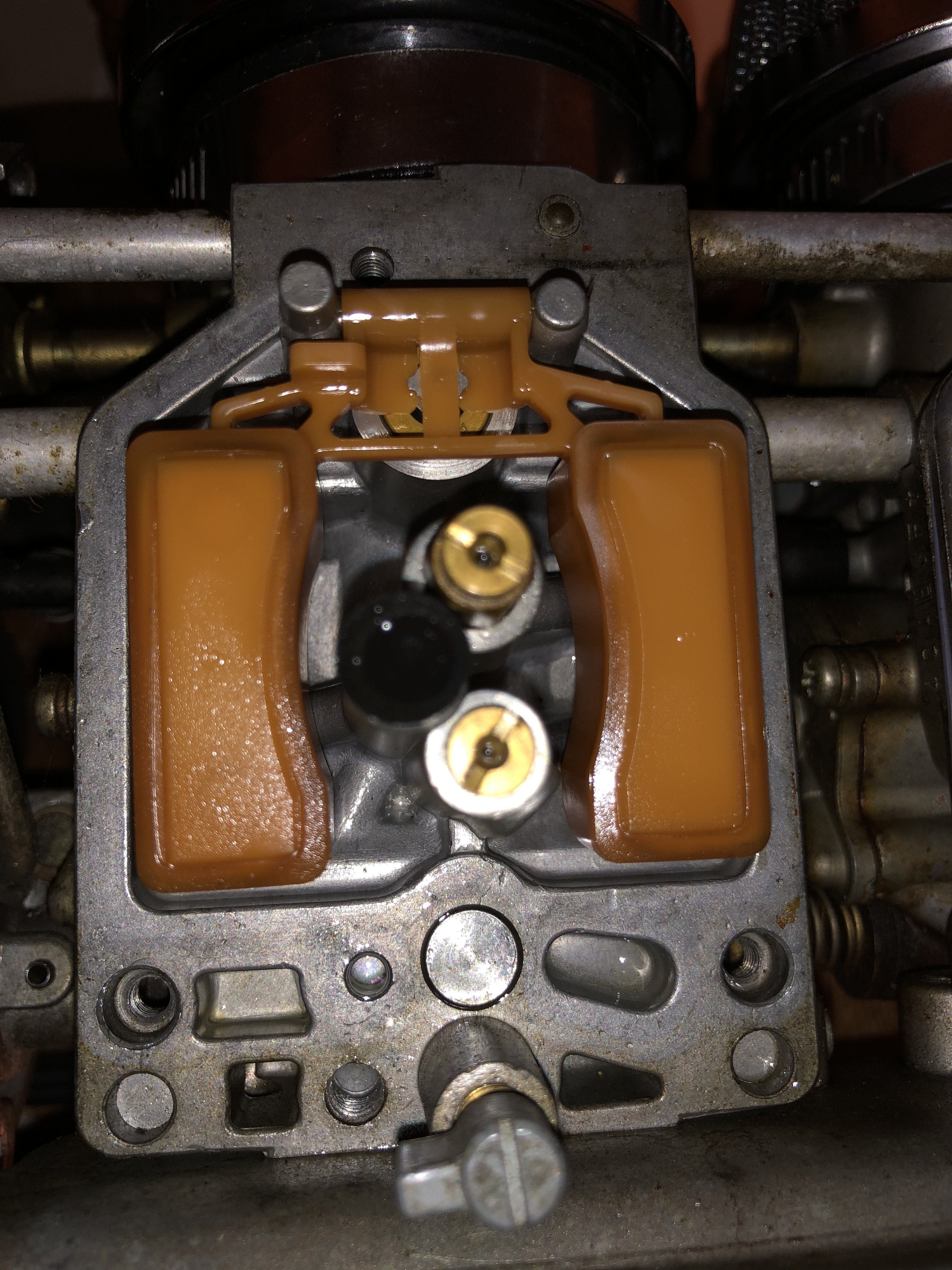

Opened the Carbs again to check float needles and floats themselves - Pics attached.
They seem correct and in good working order - they did only overflow when I bypassed the vacuum fuel valve and turned the tank petcock to ON; so figure there isn't actually an issue with this area when that valve works correctly.
I did spot there seemed to be an ever-so-slight amount of leaking fuel on the outside of the gasket seals at the float bowls. This wasn't enough to drip or anything, but was damp to touch. I'd replaced those gaskets with brand new ones previously, but they are not like the originals which sat in grooves, they covered the full area. As this is different than standard, I'm going to replace these again with the original style and see if that fixes that issue.
I also checked the vacuum valve is unblocked - which it is.
The rubber carb holders also appear to be in good condition, they provide a tight seal and are not cracked - again, picture attached.
I did wonder; if all of this happens to be in decent enough condition, would the issue be as simple as a fuel / air mix?

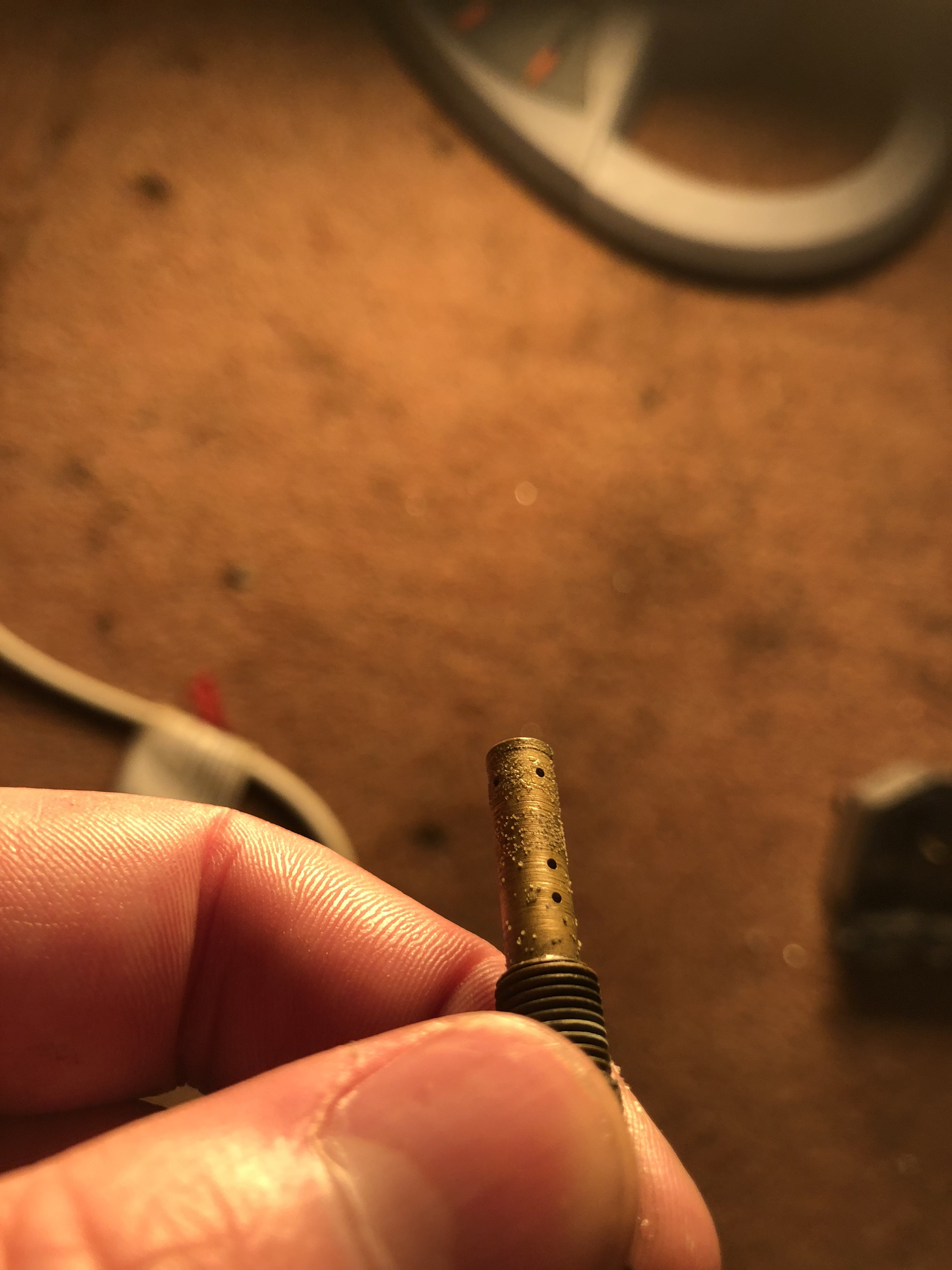

Sorry yeah, should've said - I'd only popped it out to take a look everything seemed clear underneath.
When I'd taken the entire Main Jet out of the furthest right side carb (from being sat on the bike), it did appear to have some sort of dirt on it - which I assume is old fuel? (pic attached).
