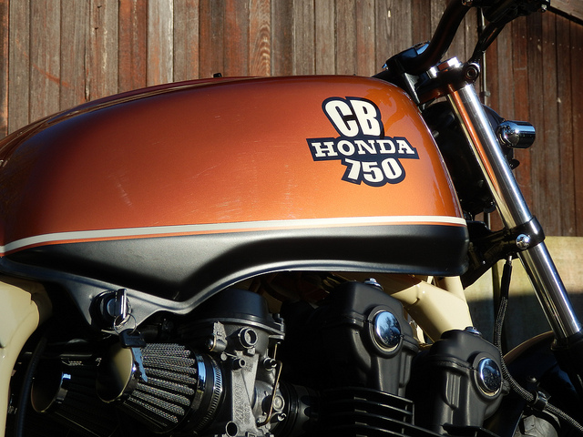

Its 2mm aluminium plate. Made a template first from cardboard. I used a mig gas bottle to form the curve, mounting bolts are fixed in with epoxy. Bought the leather and foam on ebay and used a local lad to me to stitch and fit the cover.

love your build man, looks so clean.. would be awesome if you could have a cnc shop make your tank logo out of aluminium. i love the logo, but just looks off with it just painted on the tank IMHO, having an actual emblem on there would be unreal! great work, look amazing
