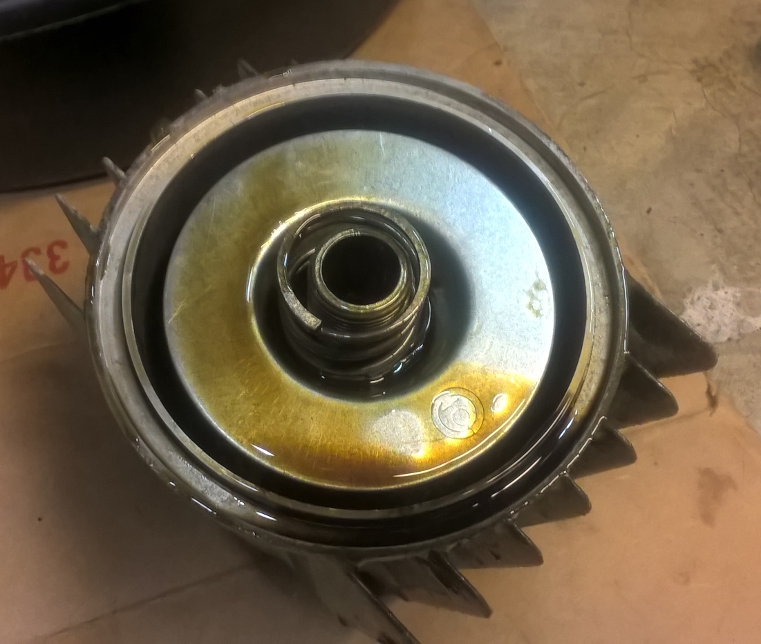

Shims on order, oil and filter changed (photo to come), and initial compression test done. MUCH better than I had feared. Was afraid there would be some ~20 psi or even Zero. Lowest dry was 90 psi, but they all went to over 150 with a squirt of oil, which has me hopeful for rings needing loosened up. Pretty amazing considering the spread in valve clearances. Starter cranked happily with no refurb needed. The outboard valve cover bolts had been swapped for standard bolts, so new ones are on order and the inboard bolts all now have new gaskets. BTW, in case it is new to anyone, the trick to geting new gaskets on the bolts undamaged is to soak them in HOT water for about five minutes, then the bolts pop right through them.
And here is the promised photo. Anybody? Bueller?

Howdy - not sure what the question is regarding the oil filter housing, but there should be an o-ring in the groove that runs around the outer perimeter.
Also that spring should be on the other side of the filter as well should it not? Pushes filter onto engine just like the gl?
Bingo! With the sping like this, all oil bypasses it and on to the engine unfiltered. BTW, the big o-ring was still stuck to the case (guess they didn't coat it with clean oil on installation).
I have found that same thing on all 3 of my hondas. The GL was wrong, my CM had no spring installed and the CX was backwards too.
