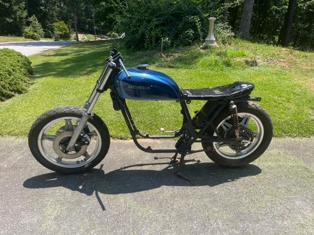

Early Goldwing forks make a relatively cheap and easy fork conversion. This is a 750F I'm building using 75-77 Wing trees and 79 Wing fork tubes/lowers with Comstar wheels. The 75-77 trees are a bolt on job for a CB750. You can also use the 75-77 fork tubes/lowers. You can run spoke wheels using the stock 750 front hub with the Wing axle and brake discs. I happened to have the 79 tubes/lowers and the Comstar front wheel. A fellow inmate Irk Miller provided the Comstar rear wheel to make this a roller.

I did similar on a '79 CB750F. GL1000 forks, trees, etc (from a '78 as I recall). Comstars, disks, calipers from a '78 too I think. Drop-in conversion. GL1000 legs are bigger and better handle the weight. All Balls roller bearings dropped right in, too.
