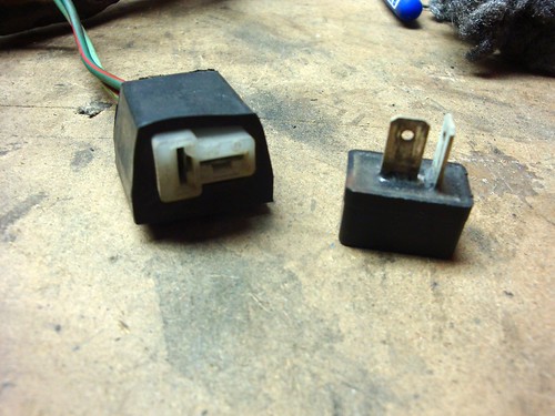

The last photo is the diode that works with the neutral safety switch and starter switch. Allows you to start only with neutral or clutch pulled in....

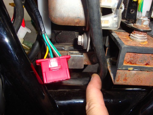

There are no wires/plugs on the new harness that fit or go to the diode except the red plug. The red plug will certainly not fit the old diode. All the other plugs on the harness are white and this one is red and has five wires.

The red plug is the unknown . . . . no plugs to connect to.

The red plug is a stumper, as the schematic doesn't show plug color. Where does it come from, and what color are the wires coming out of it?

the last pic in your post shows a diode and the connector for that diode.....Yet you said it didn't fit...looks like it fits...

M - the last photo is off the old harness and diode - I disconnected it to show. Not sure what replaces it.
I'll get a photo up today of the colours coming out of the red plug. Going to have a look at the schematics I printed off last night and will report back tonight.

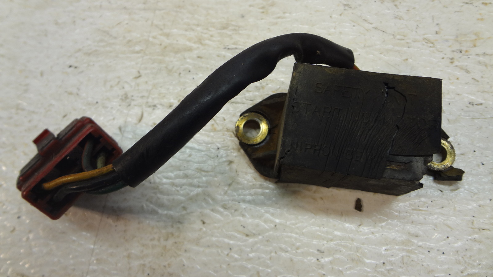

What year bike? Looks like the harness that I bought, mine is for a 1975 CB750k5.
That red plug is for the starter safety switch, that forces you to pull the clutch in to start the bike.
The plug looks like this:

yup, that's the plug.
Spent some time this afternoon going over the schematics from the shop manual trying to figure this out. K3-K7 use the red plug, 76-78 (as far as I looked) use the two wired diode.
My bike is a '73 but has a '76 engine. Before ordering the harness I checked the switches (not carefully enough) and figured that it was just the engine that was put in and the PO left the '73 switches, etc. (everything else on the bike is '73). However, I was wrong and now the two wired dioden makes sense.
So . . . . now what do I do? Harness is mostly already set up. Can I use the '76 diode by trimming off the wires from the red plug (black, yellow/red, dark green) and kept the two that work with the diode (green/red and light green/red)??
