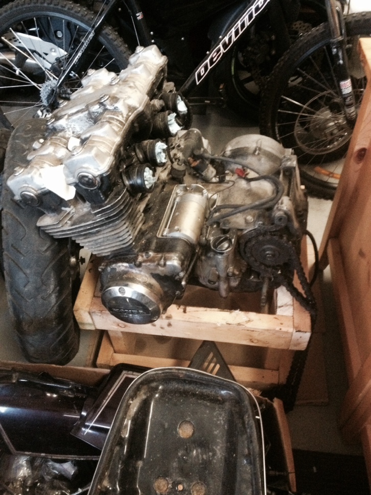

I have already started the build/tear down and haven’t taken as many pictures as I have hoped for but here are some pics of what I have so far and will be posting more as school is winding down for the semester.

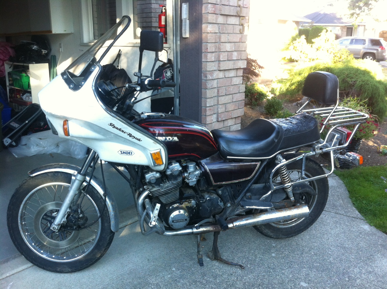

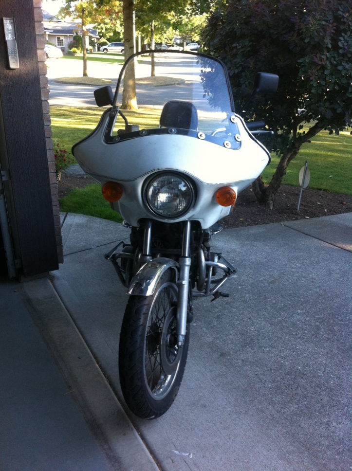

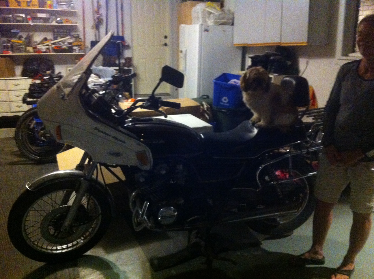

The Windjammer had to go first!

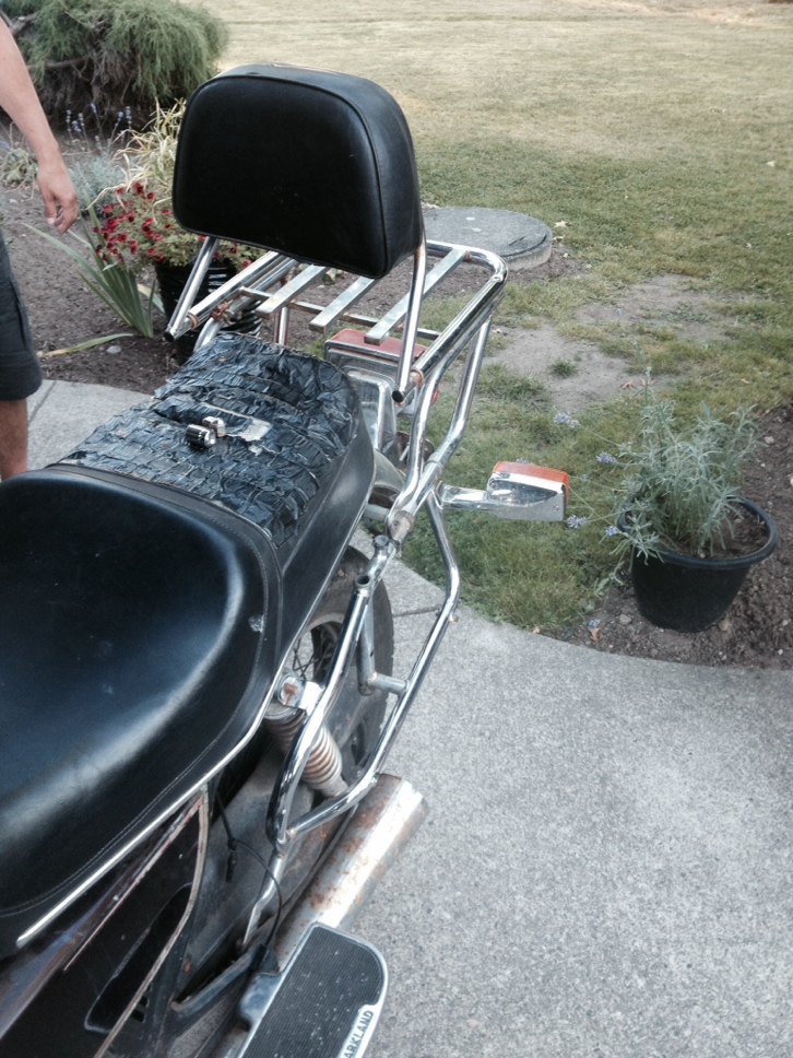

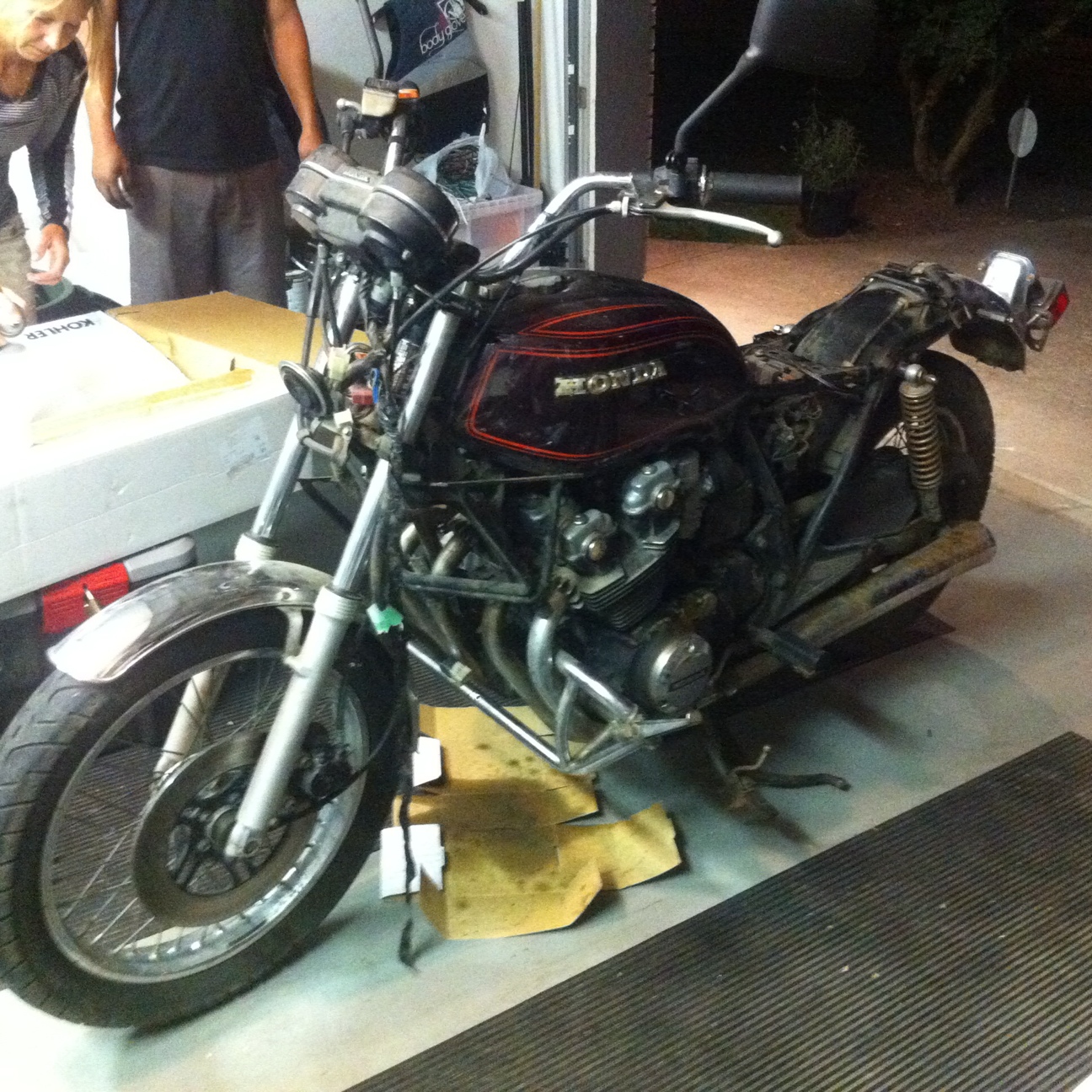

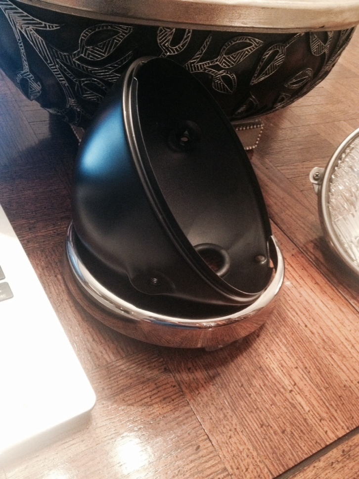

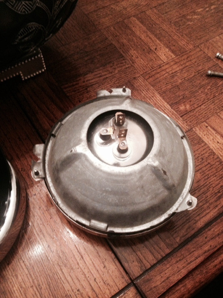

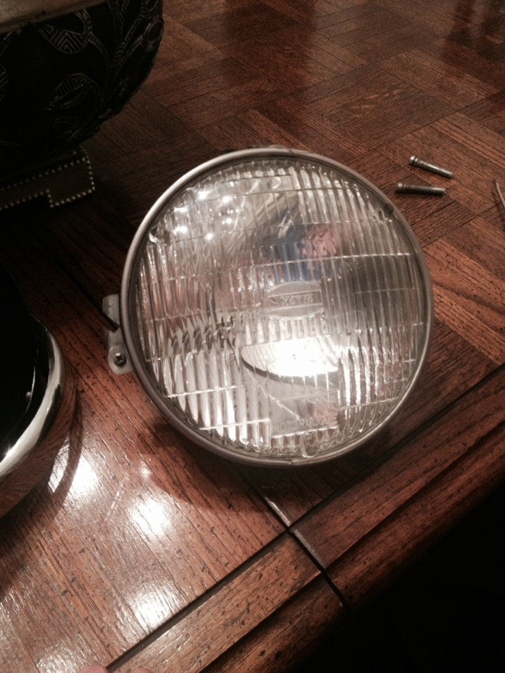

ended up taking the headlight out of the windjammer and picked up a brand new bucket off CL recently and fitting is so close to perfect but I have no way to secure the headlight in the bucket as there are no mounts...any suggestions? I can post more pics if needed of this dilemma

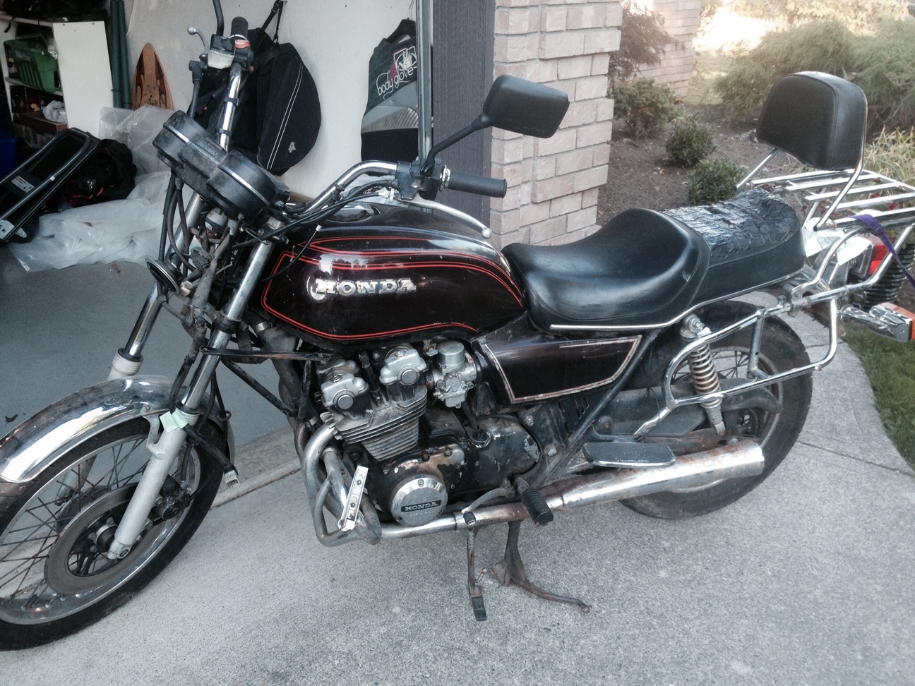

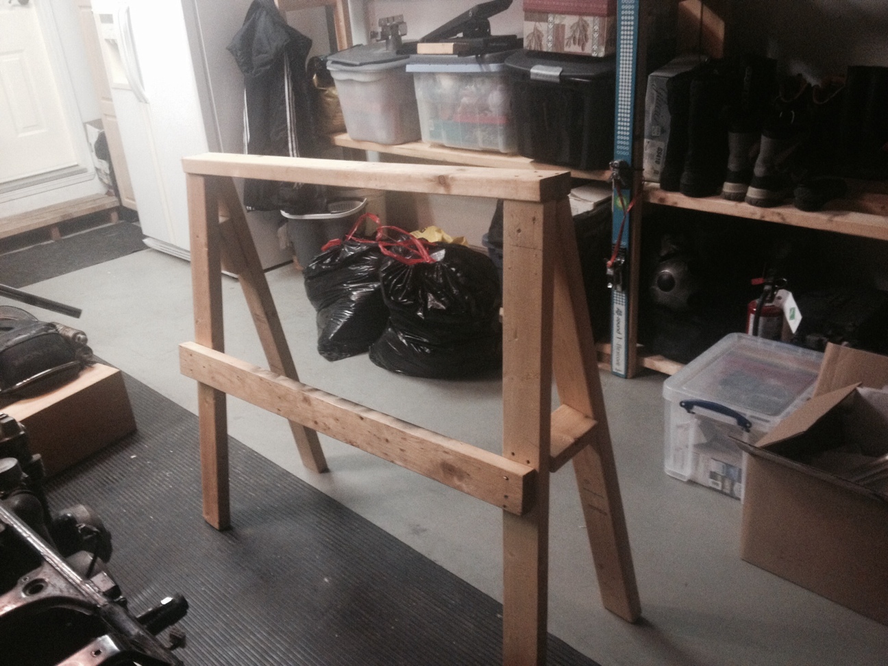

As i mentioned in my first post, I am in university so money is gonna be pretty tight on this build
also being my first build I dont have any fancy tools, jacks, and lifts that some of you guys have.
Parents recently did a reno in the house and ended up having some spare 2 x 4's laying around so ended up building an engine mount and a saw horse which is doubling as a my tank holder at the moment ;D 8)
they are pretty ghetto but are proving sturdy and handy so far!
Yep. I ran into the same problem with my CB125S.
Grab a 7" H4 reflector (I think it's a 7" for the CB750s... grab a measuring tape and check!) and use some silicon caulk to attach it to the trim ring. Make sure to clean everything really well and have it perfectly lined up before using the caulk and it should work nicely.
H4 bulbs will be a lot easier to find in a pinch than a sealed beam.
Here's a link to a 7" reflector with a short writeup of the things you need to consider when putting an H4 into an older bike:
http://4into1.com/candlepower-7-quartz-halogen-motorcycle-headlight/
Ah ya thats what I was thinking.. some sort of caulking.
glad to see someone has some experience with it!
Ill give it a shot and hopefully it will work out!
Thanks for the link as well!
Here is some pictures of the rest of the bike and how it sits at the moment
the seat is in pretty good shape but the passenger spot is all torn up in some weird grid pattern ???
but will probably be changing the style of the seat to get that flat look to it...probably gonna make my own.. never done it so should be interesting ;D

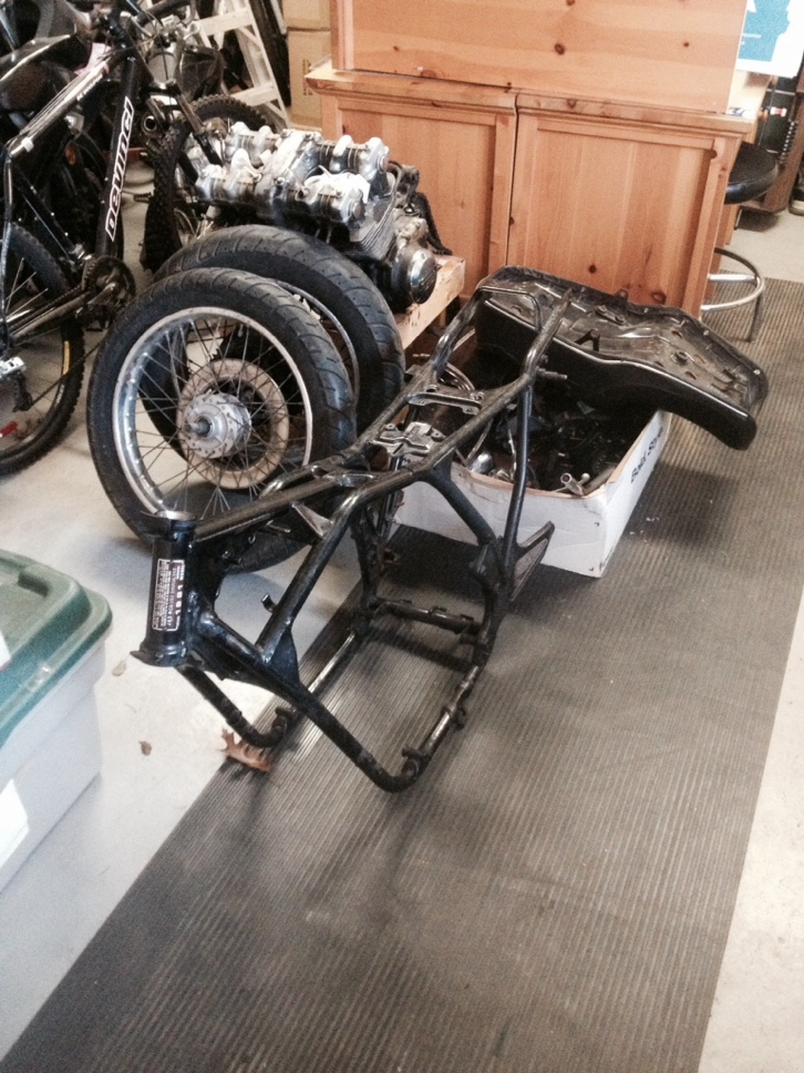

got the frame out of the engine a couple weeks ago as well havent touched it since then however
frame is in the process of slowly being degreased then I will be taking it to a local sand blaster to have it cleaned up fully and then i will be repainting and coating it
will also be keeping stock rims but will have to polish them up and make it look somewhat new again

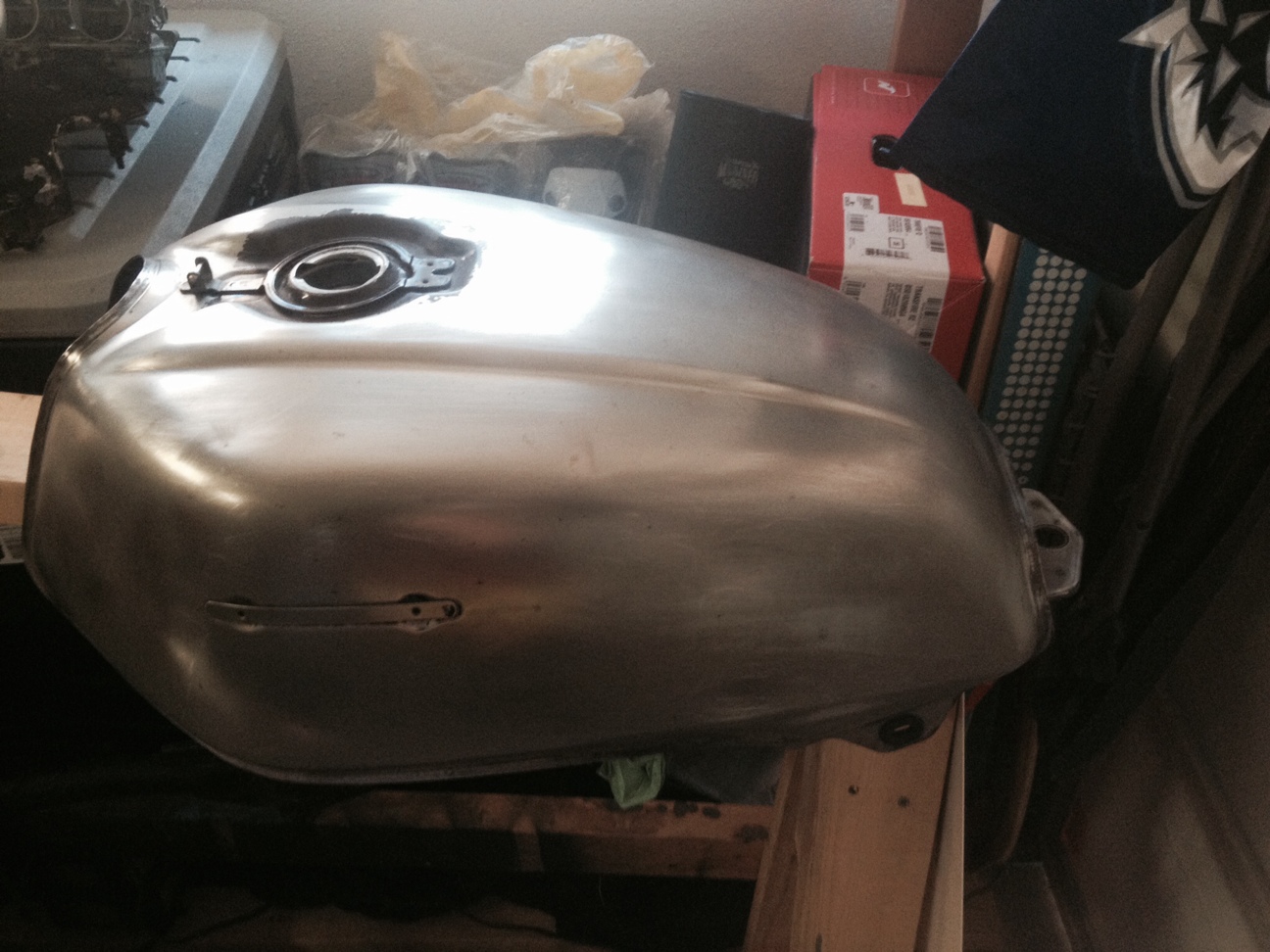

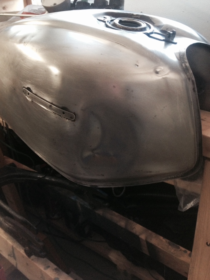

also here are some pics of the tank after i stripped it and a look at its dent as well...anybody got sure fire ways to remove the dent? ive tried a few off youtube with no luck so far

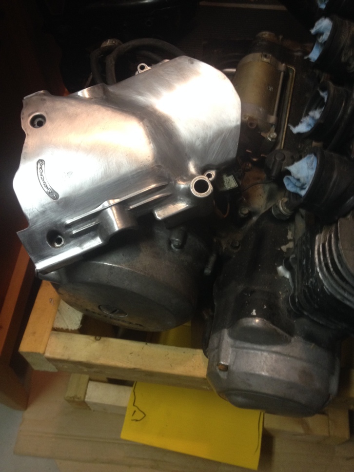

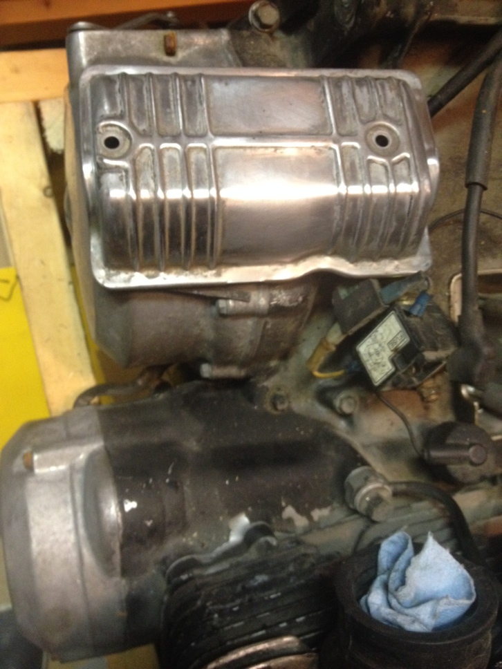

So i recently lined the trim of the headlight bucket with some silicon caulking
I think it turned out pretty well as everything is still very clean and there is no excess amount of the stuff on outside or inside
also im still able to remove the trim from the bucket with a little bit of care to make sure not to apply unnecessary pressure to the headlight
Im sure there are better ways of doing this, like getting the correct bucket but for now this seems it will hold great! so i am happy with it ;D

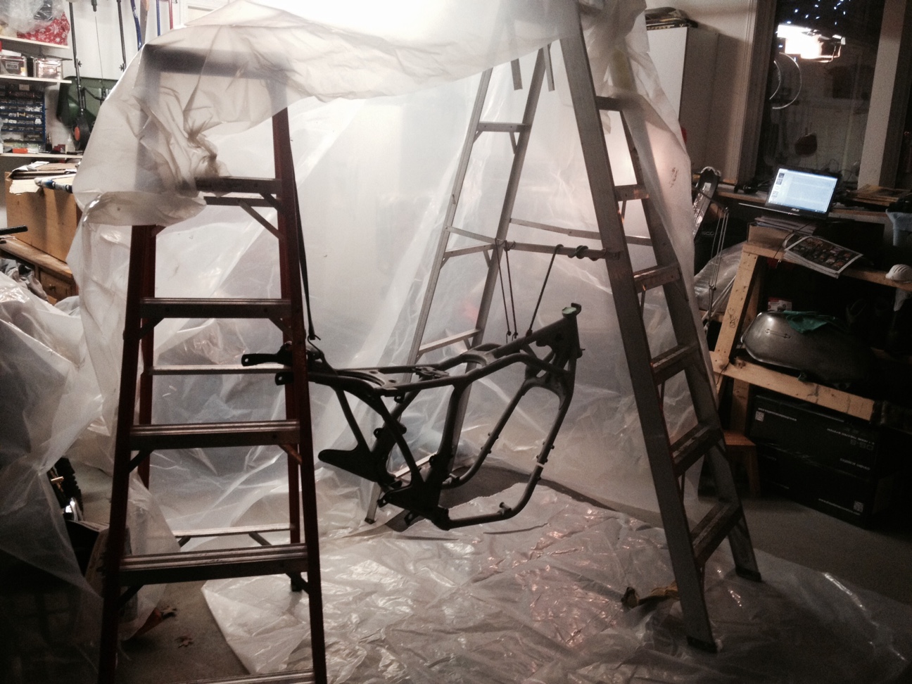

So a few days after Boxing Day, I took my frame, swing arm, and center stand to the local sandblaster with the girlfriend as a nice little date 8) she blasted the swingarm and stand while i worked on the frame. First time have sandblasted anything and it was a pretty cool experience. Definitely better than paying the "professionals" to blast it for me and it was cheaper as well. I felt we did a pretty good job as well. However, once we were done the guy who worked there mentioned we should prime it within a couple days to prevent flash rusting which i was unaware of occurs so quickly. So off to Canadian Tire to pick up some primer and straight home we went. scuffed the frame and parts, rinsed down, prepped with some denatured alcohol, made a make shift booth to prevent over spray from getting on everything and pissing off my mom, and got to spraying.
Have done quite a bit of research on painting and what not and this was my first go and spray painting and priming anything. Was a bit stressful and a quick learning curve on how far to hold the can away and how much to spray without causing drips and runs. After a day of letting the primer dry, looked it over and touched up any small imperfections then let it sit for another day again before wet sanding it down washing and prepping the frame for paint. So last night used the VHT Roll bar paint which seems to be the most popular choice from the research I have done. It looks great so far and went on to the frame really well. It is not super glossy but still has a nice shine to it. Have yet to paint the swingarm and center stand yet but those were primed during this process as well. Its not a show room quality paint job but I am more than pleased with how it has been looking thus far.
For those wondering on good steps to follow, the post on this forum called RATTLE CAN BLING by tWistedWheelz was a great source of information. I followed his post pretty well but not to the extent of 12 coats that he suggested. Rather took information from a variety of other sources. If anyone has any questions on the process I used feel free to ask and Ill answer to the best of my knowledge.
Again I have never done any sort of paint job such as this and yet the results, to me, are pretty good so far and am more than pleased. Just a bit of patience and attention to detail.
Will post some better pics, possibly later today, but the snow is starting to fall here in Vancouver suburbs and do not feel like going out to the garage at the moment! :P

Something I forgot to mention...
in the haste to get the frame primed due to the fact that I didnt want it to flash rust and was unaware this would occur...I never got around to cutting up the tail section of the frame in preparation for a rear loop and seat pan mounts. I guess I will have to retouch up the paint once i cut and have the tail loop and mounts welded...anybody know of a specific way to do this to avoid any unnecessary damage to the paint (mainly in regards to the welding process as I have never welded or been around much welding).
kind of a weird question but do not feel like rewording it haha any help is appreciated, thanks!
Yeah always a good idea to get all your fabrication done first. Make sure you get any mounts or hoops or anything else that will be permanently afixed on before you paint or powder coat anything. A little flash rust won't hurt anything along the way
Ya i wanted to do some fab work but ended up sandblasting and once that was done and was told about the flash rusting I wasnt sure how much of an effect it would have so I played it safe and got it all primed
unfortunately I will have to touch up the paint once I do the fab work and I hope others reading this thread will learn from my newb mistake ;D

- take dents out of gas tank/bondo/prime and paint
any suggestions on best ways to remove dents? I have tried some youtube methods and would like to try a couple more before I am forced to take it to a shop to have done...any suggestions on other areas is greatly appreciated! :)

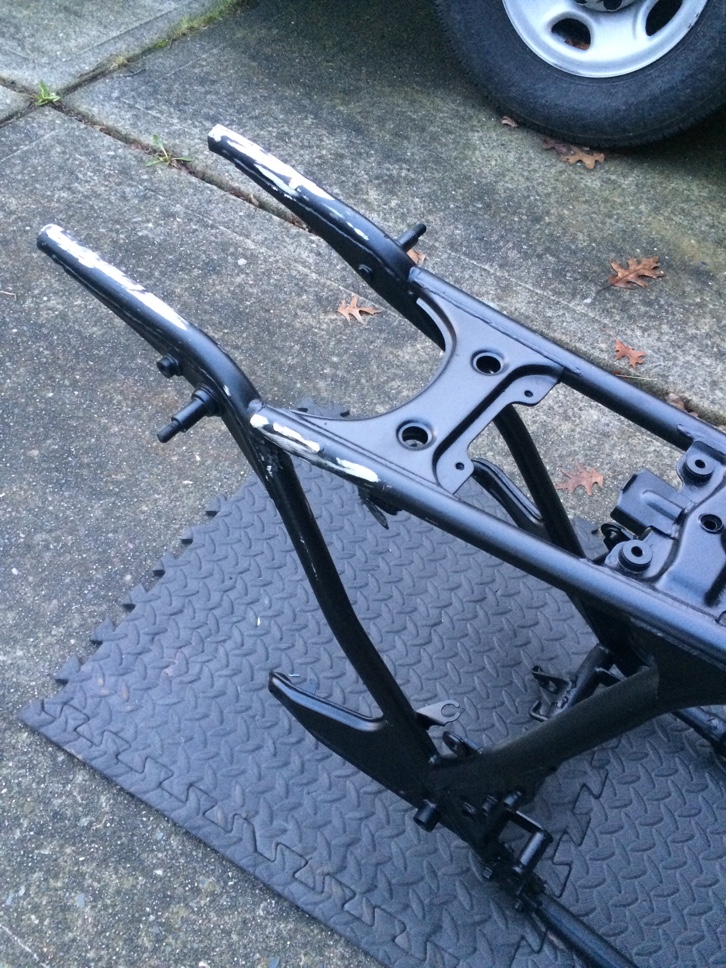

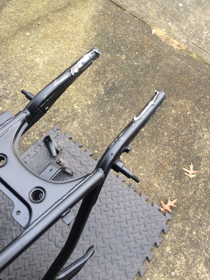

Hey guys
so got my hands on an angle grinder and managed to cut the rear of my frame in preparation for ordering and welding the rear loop on. First to go was the passenger seat bump then the pinched tubes at the back and then a helmet lock and another small tab. here are some pics of what it looks like. hopefully its up to everyones standards here and I know it could be better but at this point in time I am not too worried on getting anywhere near showroom finish on such a small aspect of the build :)
just remember you cant put a flat seat pan on there the tire goes up there when you hit bigger bumps
be prepared for this,do this now before you go any further
bottom out the suspension, ALL THE WAY down hard and observe where the tire is and leave at least an inch vertical clearance
an easy way is to put on just one shock with the preload backed off then ratchet strap it down hard
the best way is to do the build with the springs off the shocks so you can easily check and verify as you go

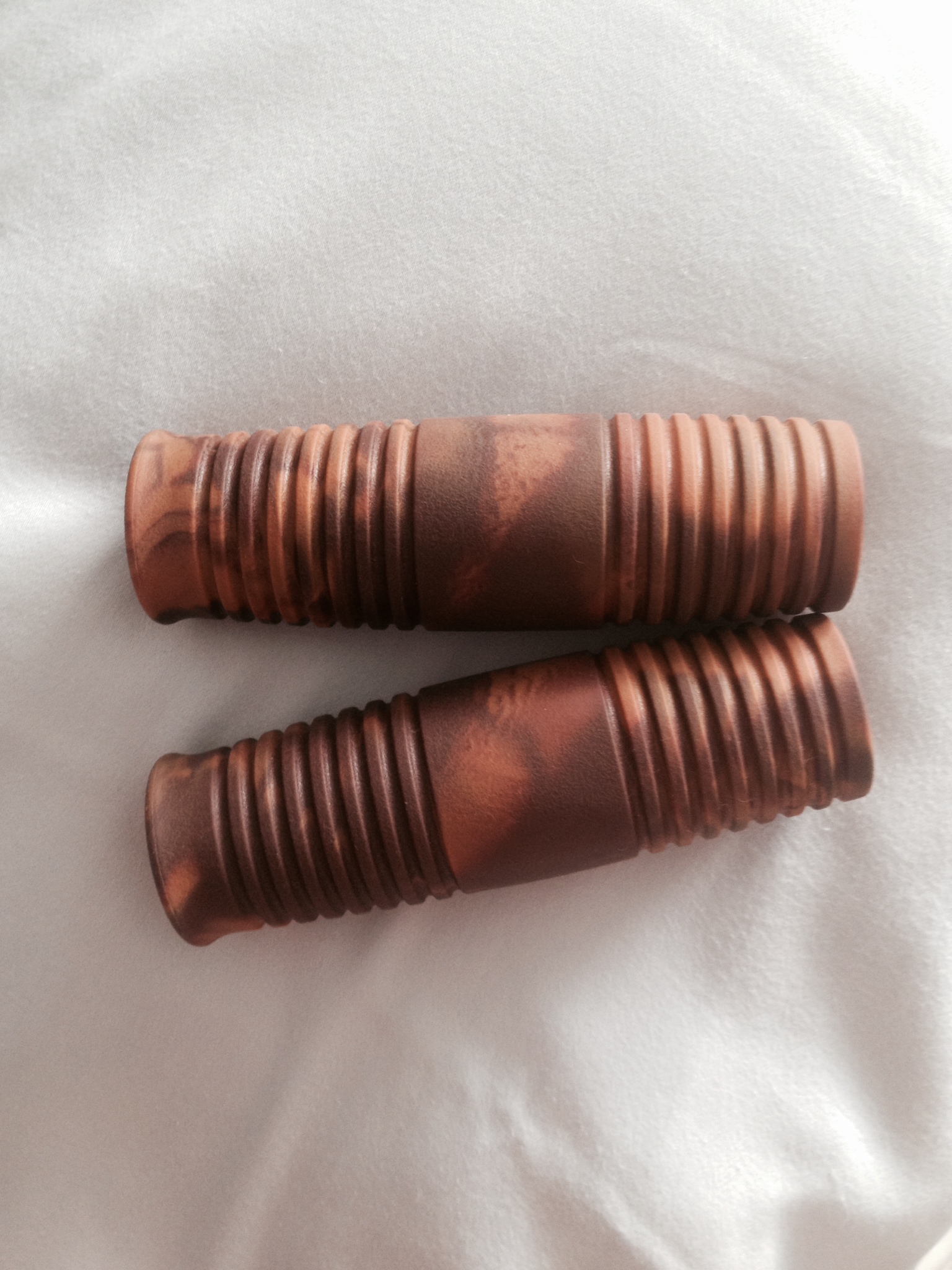

Just wanted to make a quick post here regarding my new grips that I ordered from TownMoto.
They are the Mocha Marble and I am quite happy with the way they look. Slightly more orange in the brown than I had anticipated but I believe it will suit the look of the bike well. Shipping was incredibly fast from Toronto to Vancouver and would order something from them again. Anybody have any experience with these grips on the length of duration? Either way for the price and look I dont think you can go wrong with them.
