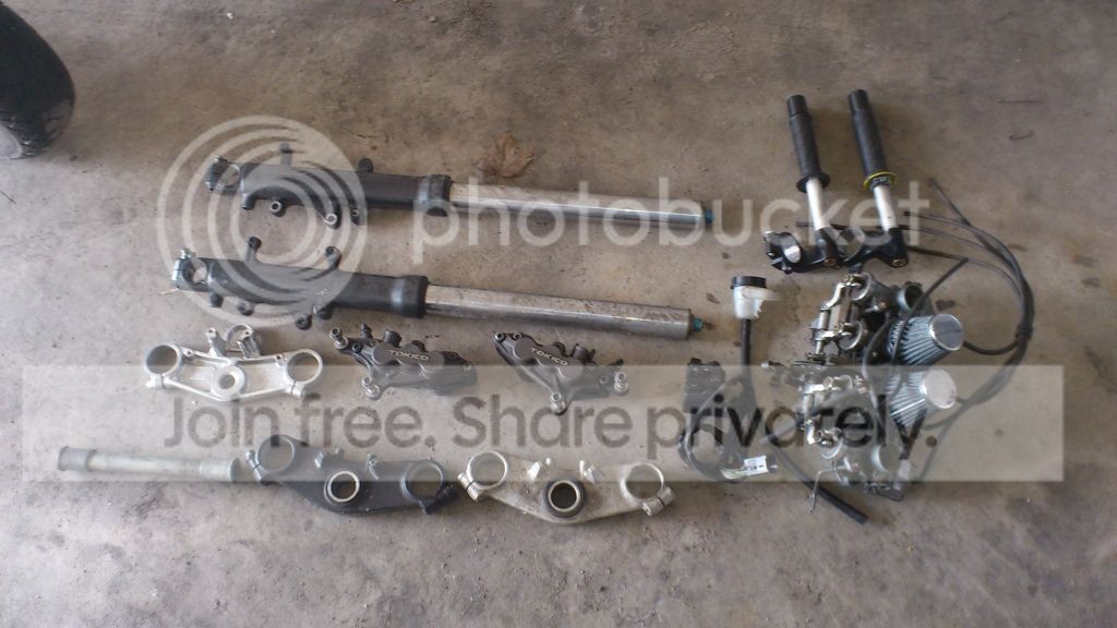

I have some zx-6 stuff
And and some CBR stuff
