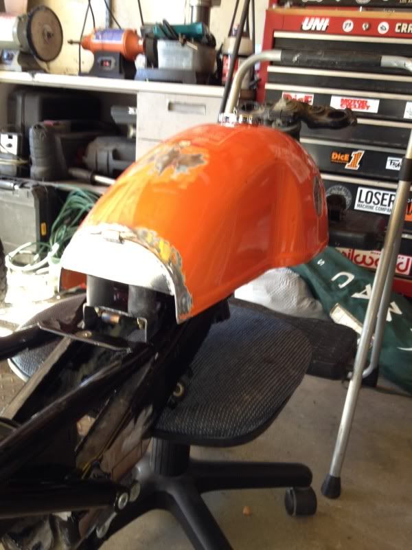

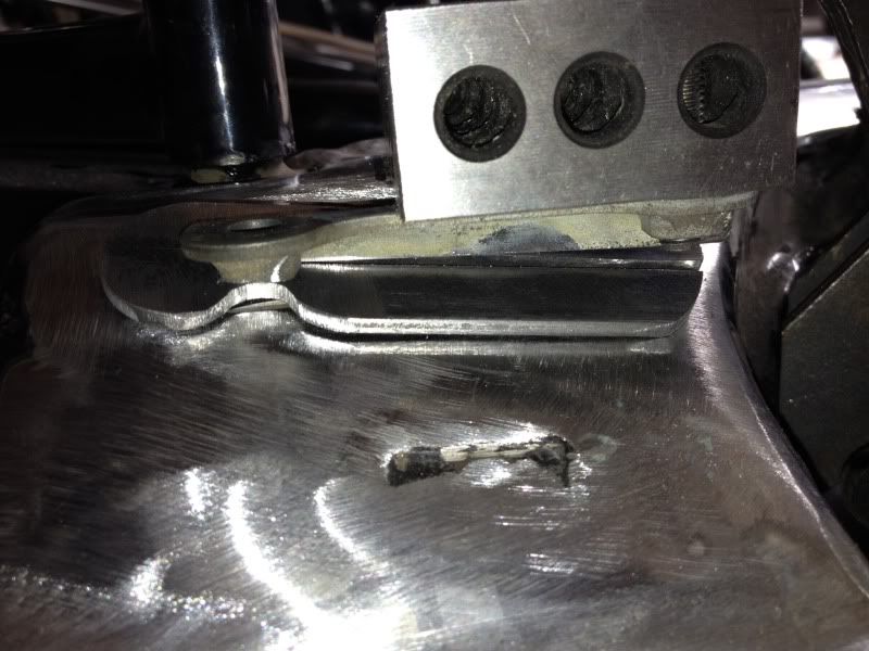

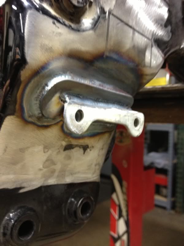

Update - I dont have a welder so I went to visit my friend Wompy.
I purchased a Benelli Tank back in 2011 before these became a hot commodity. We needed to widen the tank a bit to fit over the frame and fill in the ugly gap on top. He then CNC'd some brackets to secure and lift the tank. He then welded a bracket onto the frame that holds the rear shock rebound adjuster.

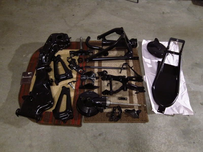

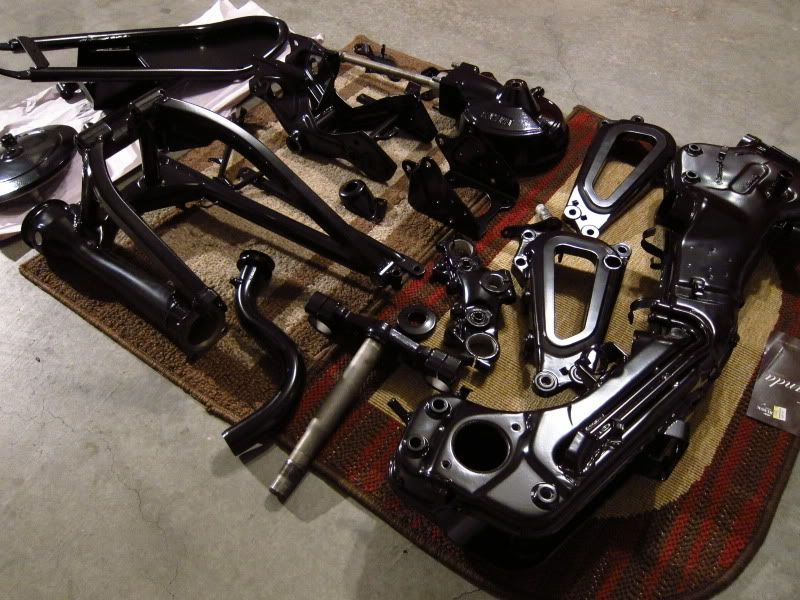

- Removed tabs and brackets not needed
- Powdercoating finished 60% Gloss Black

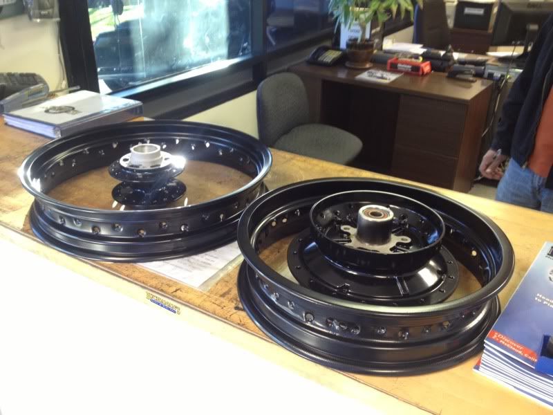

- 78' XS650 36 Spoke Front Hub
- 86' xv700 36 Spoke Rear Hub
- 18x3 D.I.D. 36 Spoke Front Hoop from Bucannan's
- 15x3 D.I.D. 36 Spoke Rear Hoop from Ebay
- Powdercoated Hoops 60% Gloss Black
- Custom Stainless Steel Spokes by Bucannan's
Took a snapshot of before I dropped it off. They needed the rear hub to measure to my specs. Rear hoop needed spokes and lacing 10mm from center of spline.

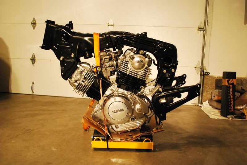

Wow man, this will be awesome!
Love how the engine came out.

Thank you sir. As always, its a tedious and you can't shortcut the work, otherwise it'll look like poo.

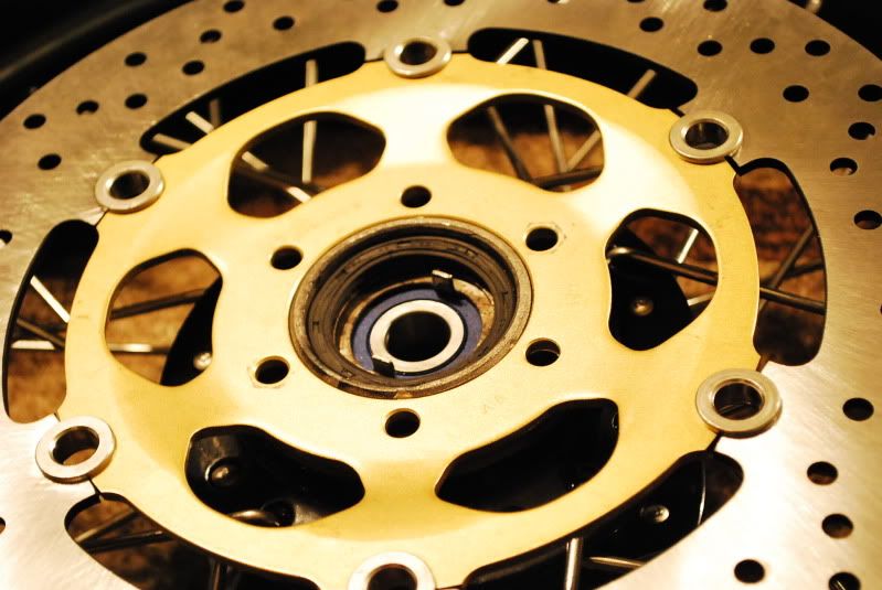

Got to assemble part of the bike night. I picked up my wheels from Bucannan's today. They look amazing!!
- Frame mounted
- Installed All Balls Tapered Bearings
- New All Balls front bearing kit
- Test fitted new front wheel (D.I.D Aluminum 18 x 3)
- Machined steel spacers to test fit new front rotor (MikeXS)
- Mounted Bridgestone Spitfires F&R
I am thinking of just of leaving on the machined spacers instead of CNC'ing a solid spacer. They are spaced correctly and the center of the rotor still fits in the hubcentric part of the hub. There is no wobble and within .002 inches of room when spinning the wheel. What do you guys think?

If the existing spacers work OK - I'd use them. But then I don't have facilities / skill to make a bespoke one ! ::)
The side view pic of your frame / engine has given me some new ideas on modifying the main frame - thanx.

I'll go with that for now. Once the bike is running, I have a better idea of what direction with the spacers.
