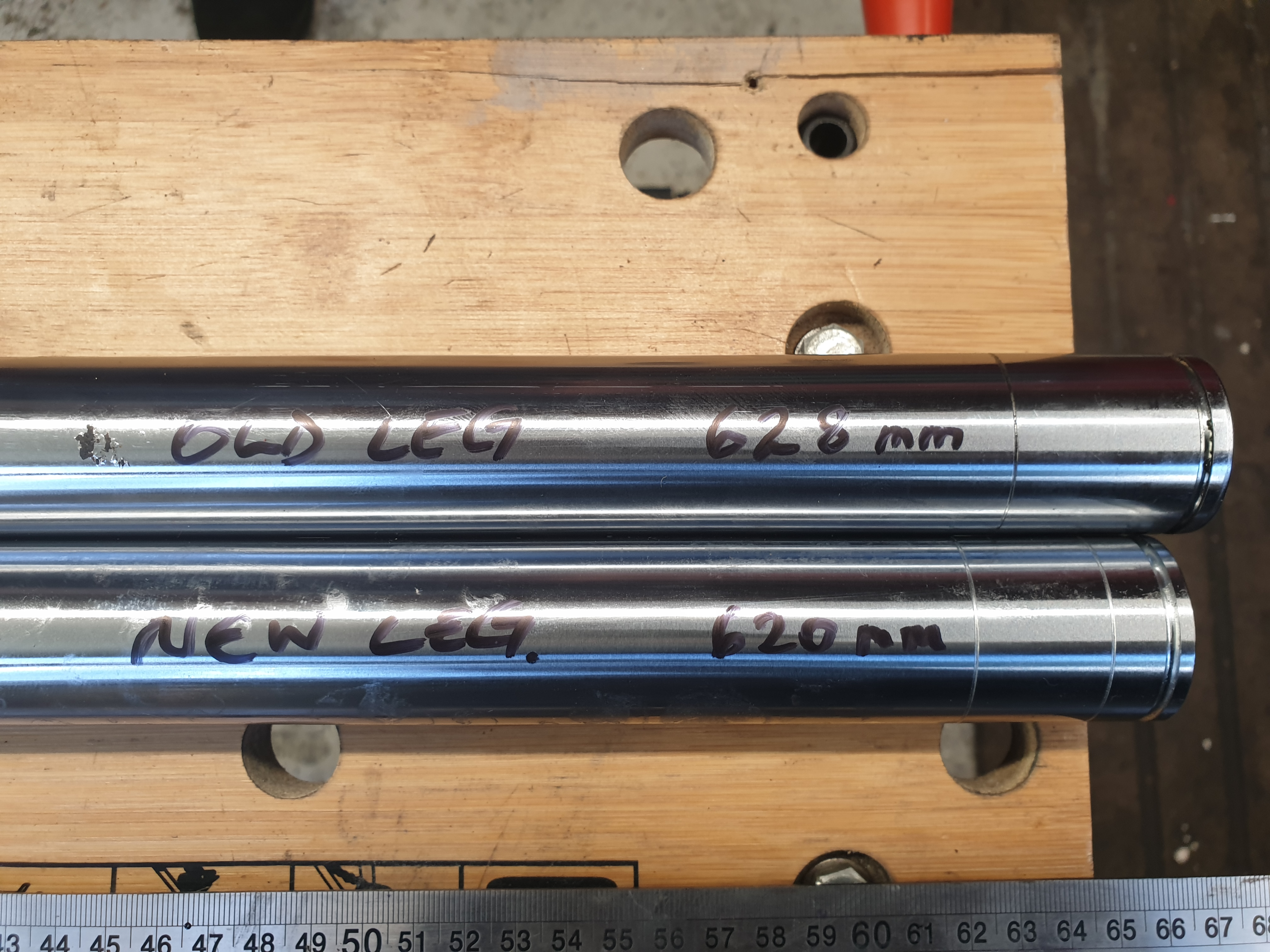

The time has come......to change the leftside forkseal.It's been progreesively getting worse and pissing oil out of the gaitor for a while now.....snuck it through the MOT but the puddle of oil is getting bigger.
Ordered a repro fork tube from David Silver in the UK, apparently they have a good rep as I asked on the Facebook CBX550 group.
So, happy to pull the trigger on the order to include OEM seal as well. Hoping this might give me the best chance of a reliable seal/repair going forwards.

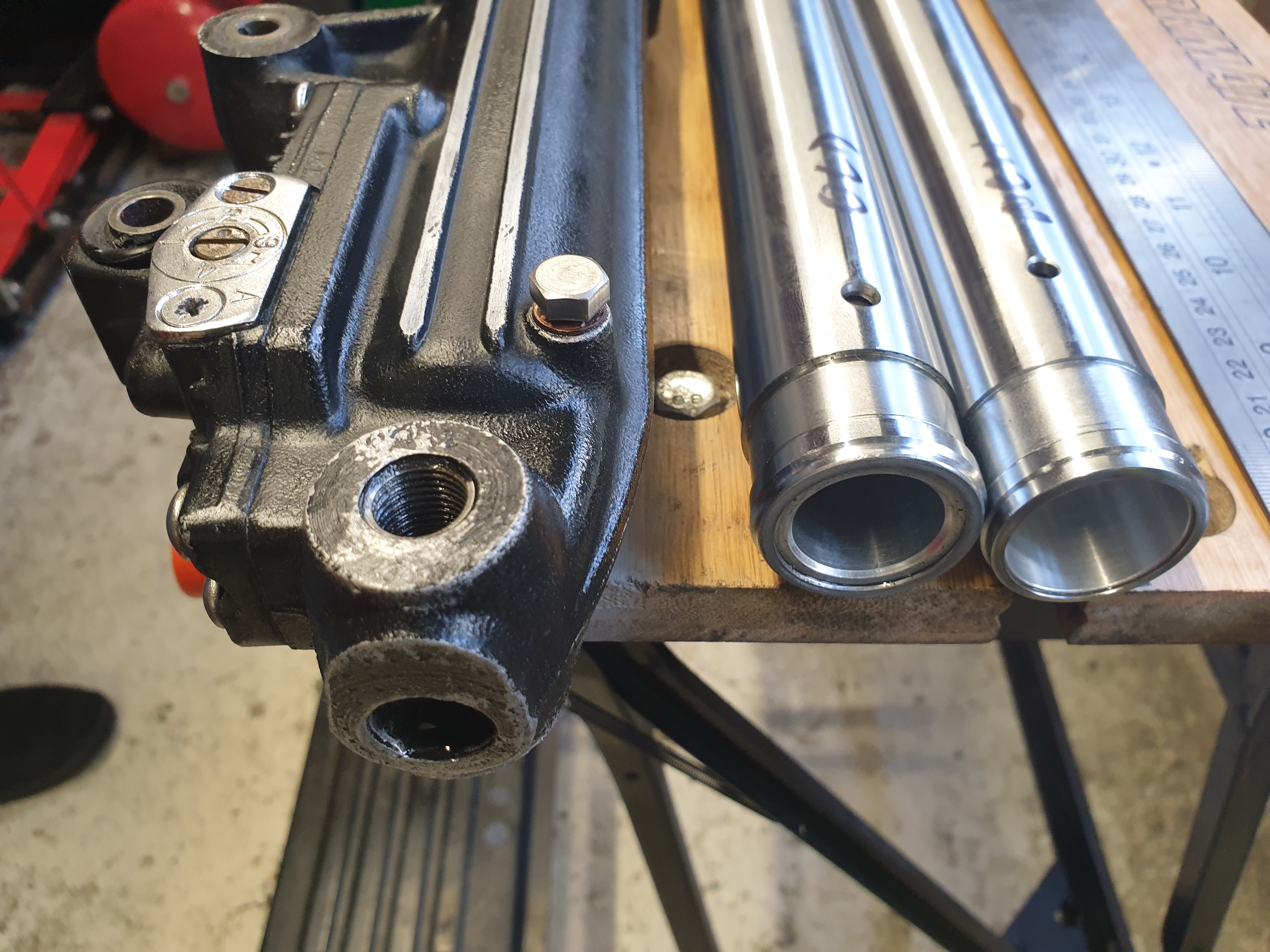

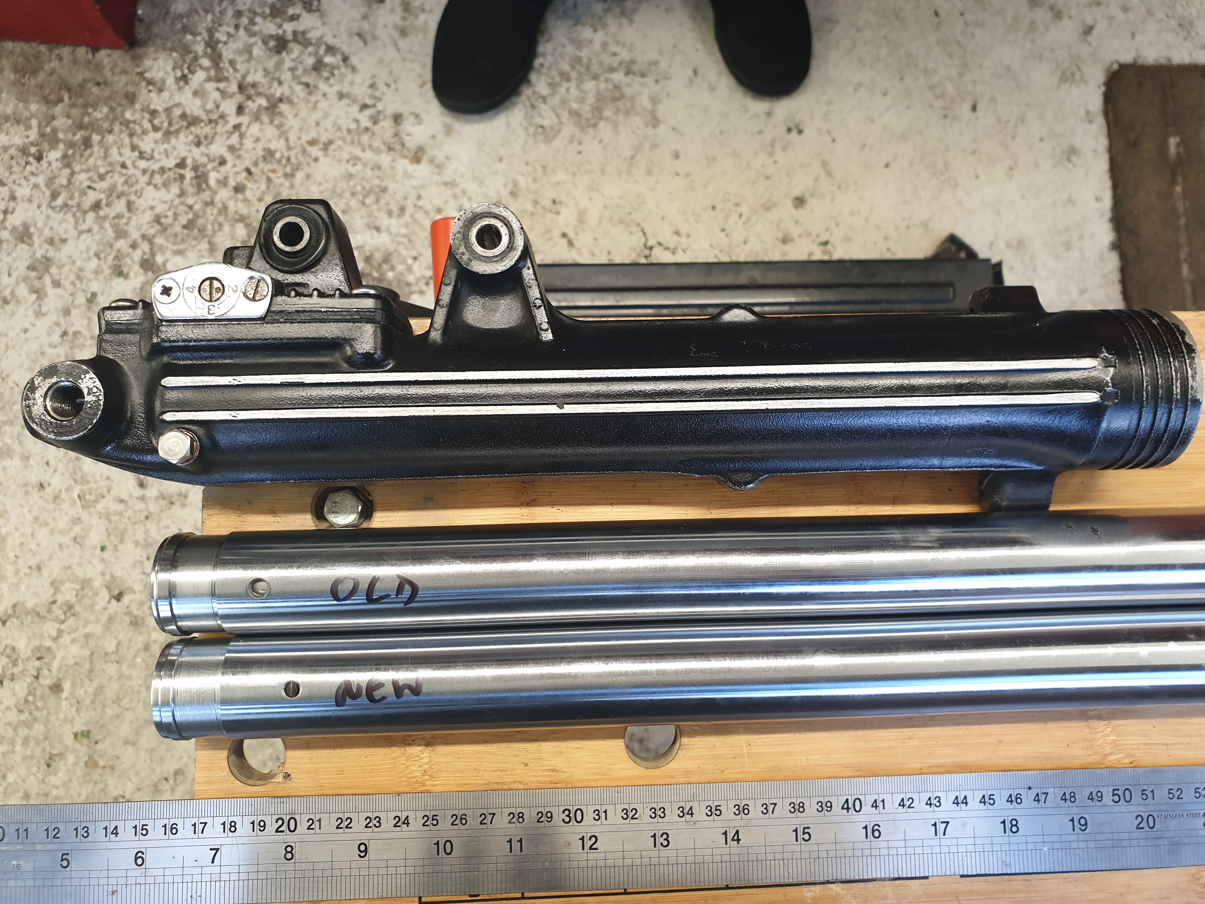

If anyone is following my CBX550 fork misadventures...here's an update:
The first repro fork tube turned out to not match the tube we removed...odd?? the new, leftside tube was shorter by 9mm than the one we took out......quick call to DS and subsequent email/image exchanges turned up the old tube was in the wrong side/leg.
I must've mixed them up when I stripped and cleaned them 5-6 years ago...cannot remember if I did them one by one or both at the same time, not realising they were handed.
So, with the help of DS (thanx Tim) I have purchased a rightside tube too, so now I have an asymetric pair that replicate what has been removed. Along with OEM seal/ductcap kit and bushes we now have everything to rebuild the entire fork set up.
