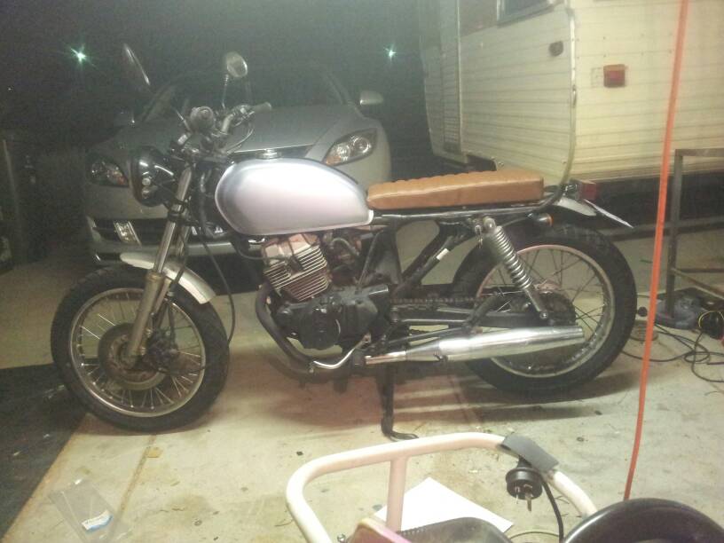

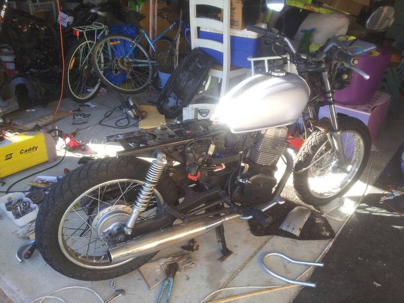

It was pretty standard when I got it except for small indicators and some paint. This pic has my new huge tyres

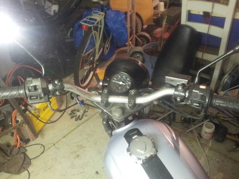

I've done a few mods that I'm going to change again like concealed cables in handle bars and removing the useless other gauge and dropping the spedo a bit.

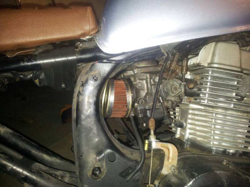

I've only got 30mm from carb to frame so.... Custom pods,, I'll high five myself

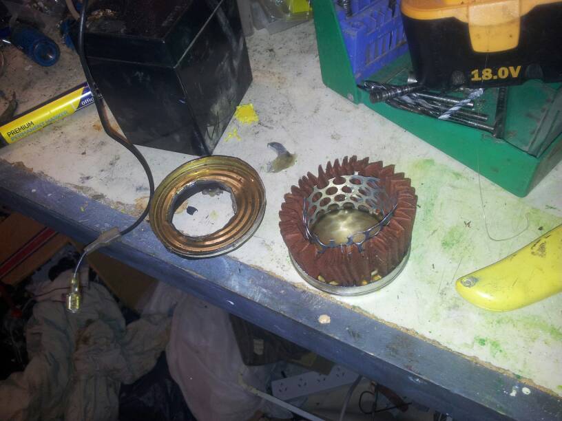

Stock filter on the chopping block
Some baked beans cans the intake baffles and
See how it runs tomorrow
