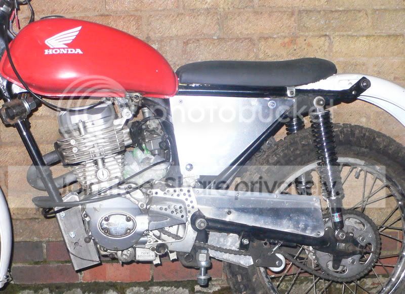

I'm holding out on the eyebolts, a couple of people went out of their way to source them for me, so I don't want to get a rep as a time waster ..... In the meantime while I wait I got on with the side panels today. They're looking a bit box fresh and squeaky at the mo, but I'm sure after a few adventures and with the addition of some stickers they'll chill.

I've been getting the bike re-commissioned and general snagging. I made a new ignition loom with fresh wire and connectors, to replace the old one which was simply hacked out of the original loom and had no less than five (5!) earth wires.
Fired up after about a dozen kicks on a dry carb with stale petrol and 0 degrees air temp.
It smoked like a locomotive for a few mins then started burning clean.
Still need a rear brake rod as well so a trip to the breakers is due.
Look at the picture and think 'putt putt putt putt putt putt putt'
