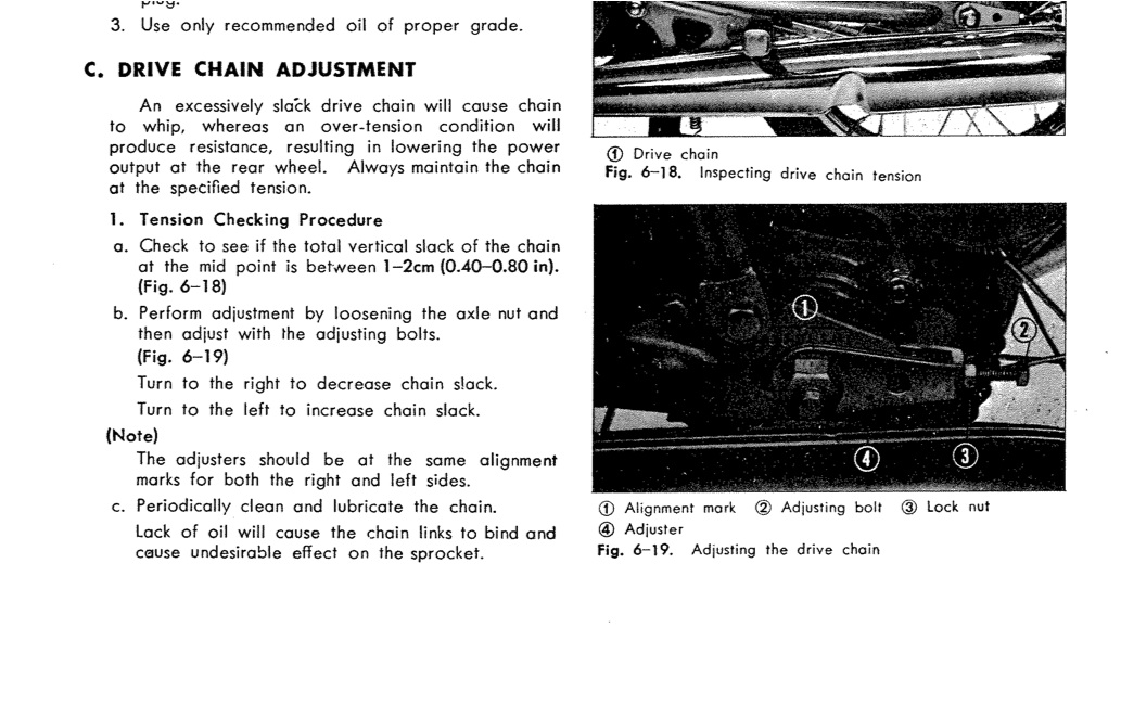

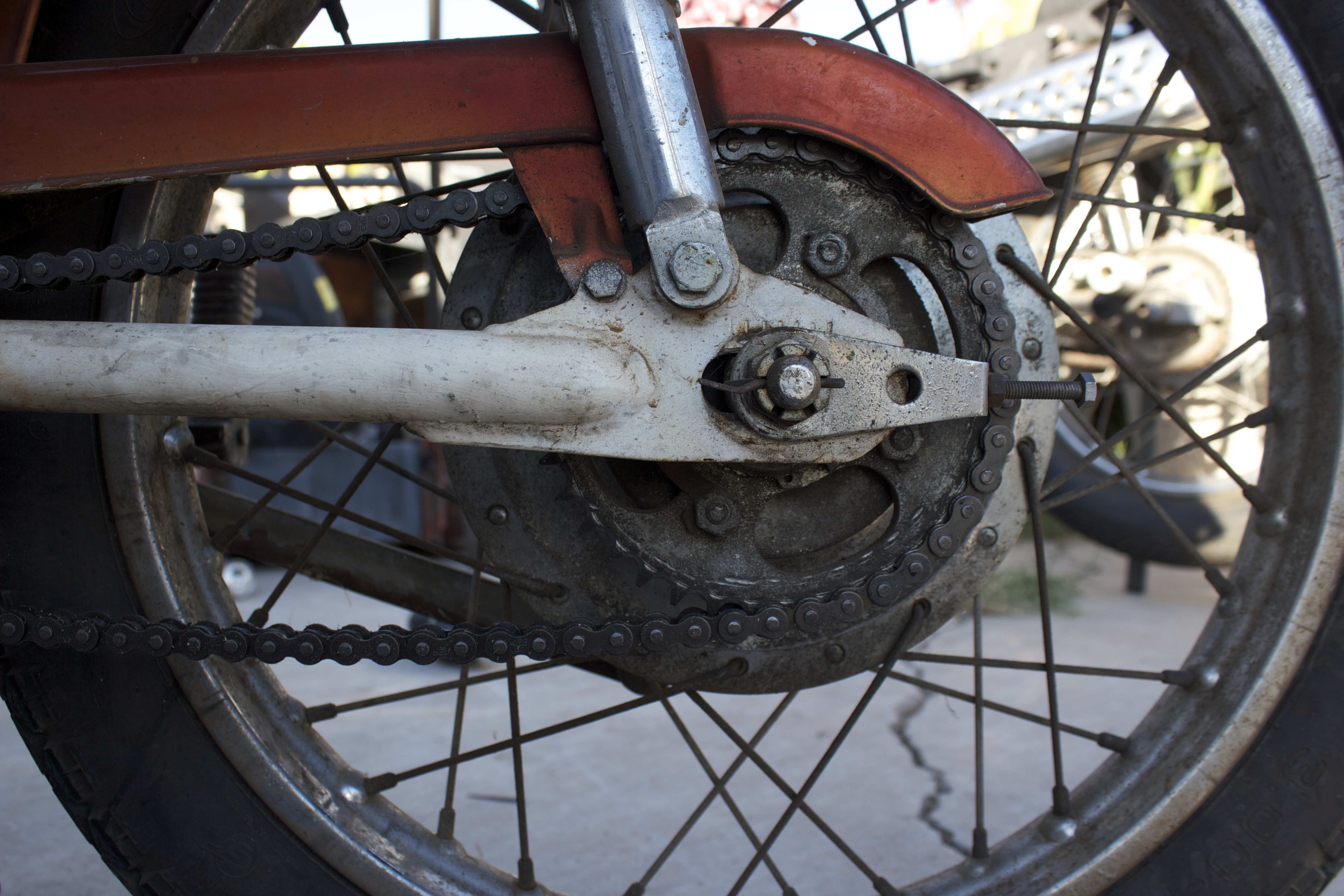

I looked at manual and says .8 inch of vertical slack. Remove pin and loosen axle nut. Then adjust with adjusting bolts. looks like wheels crooked by the notches.
Again, not sure what you mean when you write "wheels crooked by the notches." But to adjust your chain, you'll first loosen the nut up against the adjuster at the rear of your swing arm, then tighten the adjusting bolt to pull the wheel back. A little goes long way here. If by saying the wheel looks crooked you mean that it's off center, the two bolts can help you set it straight (and you can use a straight 2X4 or other straight edge to line up your front and back wheels to make sure they are in alignment). This stuff's in the manual.

You need to break that chain, take that wheel assembly off and clean it, bad. The save up 125$ and buy some new sprockets, then buy a correct fitting chain and properly adjust it as per manual instructions :) That rear end has seen much better bays. The "teardrop" things are your adjusters, there should be notches on the tops that line up to notches in the swingarm. Adjust the bolts that thread into the back of them until both sides have all the notches lined up the same, then tighten your axle bolt back down.
