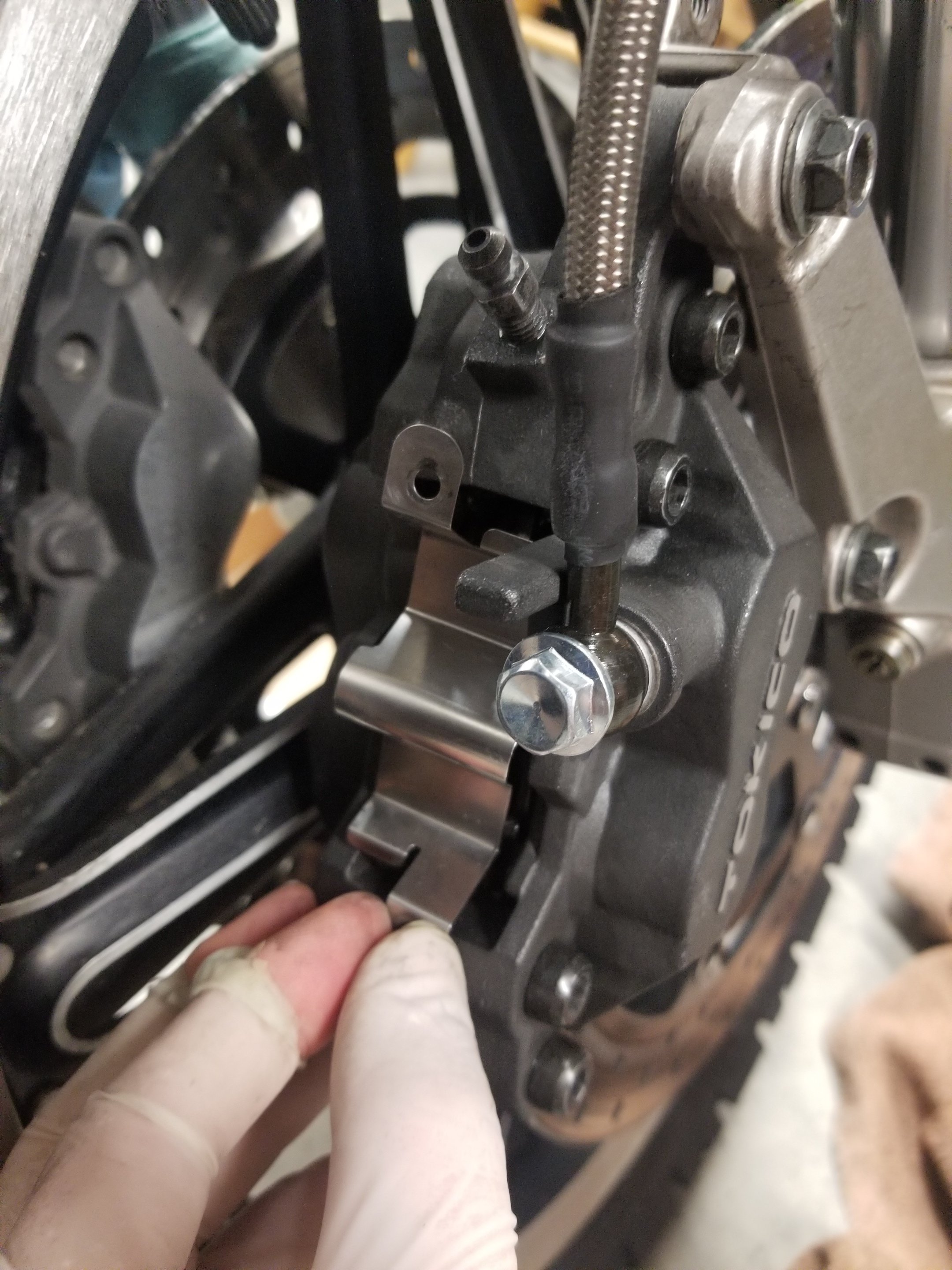

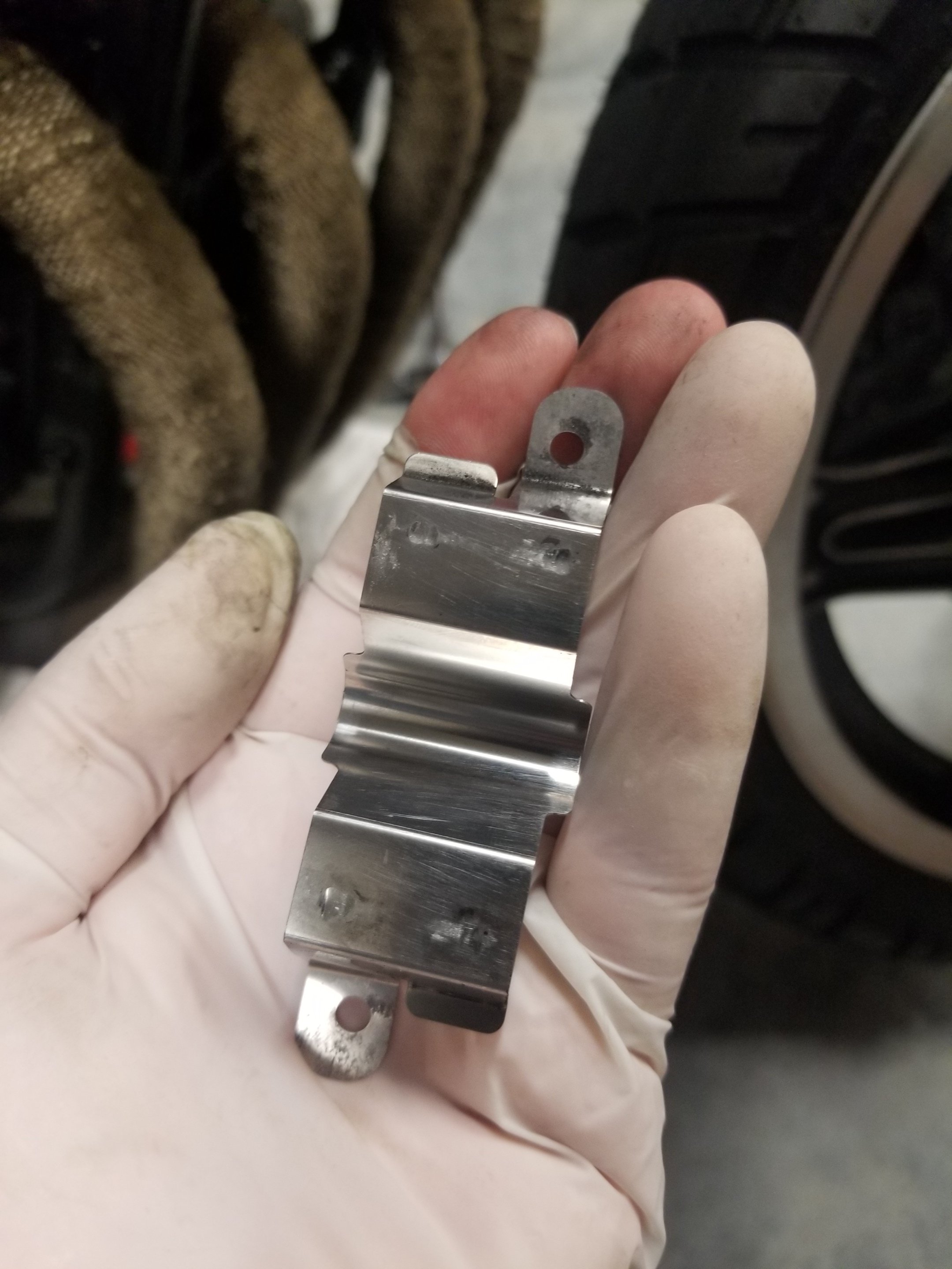

However, I noticed something else .... that this metal plate that goes on the back of the caliper has some pad Marks on it. Is this supposed to contact the pads? I thought maybe there to stop the pads from rattling and such, but then I thought wouldnt these divots prevent the pads from moving properly??
Might take this off and do a run without to compare.
