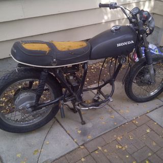

Here we go....picked up a 1975 CB 360 off a local guy for 500$. He had tried to get started on a cafe project, but never got to do much with it.
So we took loads of pictures while tearing apart. Might be good reference someday.
Have two engines which I will make into 1. The end product will be a cool little cafe/city bike to get around and ride regularly to and from the office.
I have learned a buch from many of you, time to pay it forward. Stay tuned.

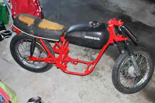

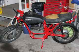

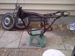

The bike was stripped down. Used a grinder to get all the little tabs I did not want to give us the clean(er) look.
Used a few cans of spray to give the frame a 3-4 layers of paint. Did the work outside and in the garage, then stored the frame by the furnace in the basement for a couple of weeks to dry. Maybe not the best choice for durability, but it looks good and did the trick for a budget ride. Might need to revisit a couple of parts like the kick stand.
Have proceeded to clean up the wheels using a combo of super fine steel wool, dish soap, and water. I also found that Mother's mini power ball is great to clean up between the spokes.
Got a nice pair of chrome clip ons from Niche Supply.
For reference, I am going to keep the tank, but will use a proper cafe seat - I might make my own, but fear I don't have the patience to make it happen. Other option will be to purchase one from RCC.
Tearing down a CB360 (engine was already out)
Battery Box and Tool box, pegs, and brake assembly.

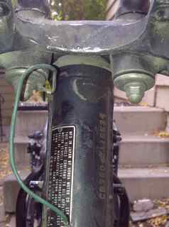

Tearing down a CB360 - more as-is pictures.

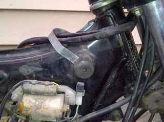

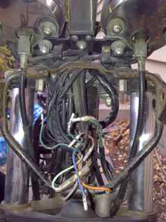

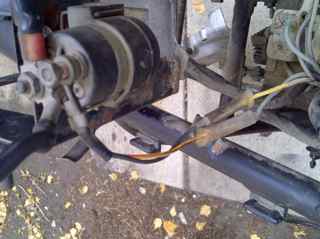

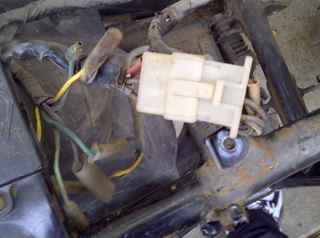

I was concerned that I might never figure out the electrical stuff...so took lots of shots.

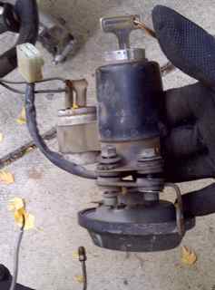

Ignition lock.

Back up to rolling stock.
Nothing is tight yet...just for satisfaction that it can be up and running in no time - Ha!. Regardless, nice to see.
