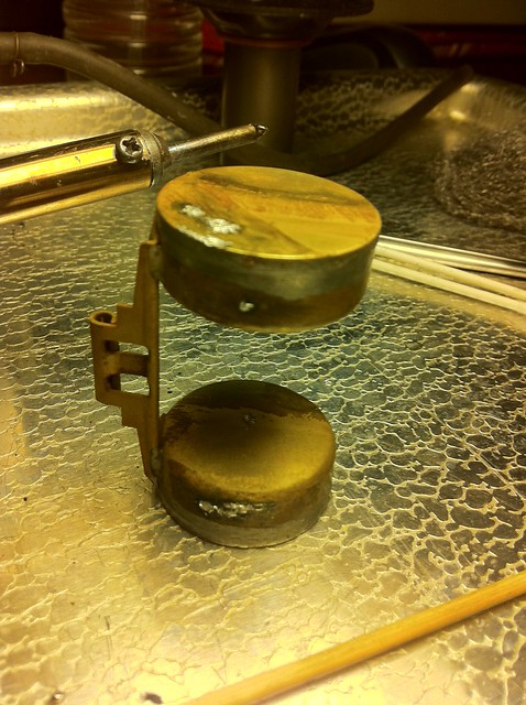

As the PO said, there was indeed a problem with the float. It contained a small amount of gas that I surmise got in via the microholes pictures below. There was some gummy substance on the float that I guess came from a previous repair. In what seems to be a major theme of this build (and a lot of others I've seen), I began re-doing a previous fix the correct way. I peeled off all the gummy stuff, drained and cleaned the float, then soldered the holes. To prevent soldering off-gas or smoke from getting in the float, I had to remove a small solder on the inside of each round part, which I then re-soldered when I was done with the microholes.
Float Holes by RStutzman, on Flickr
Soldered Floats by RStutzman, on Flickr
Please excuse my shitty soldering. I ended up cleaning these up before reassembly. I also polished the carb bodies with the aforementioned solution and some various grades of steel wool. They cleaned up really nice. here's a before/after comparison with the left/right carbs.

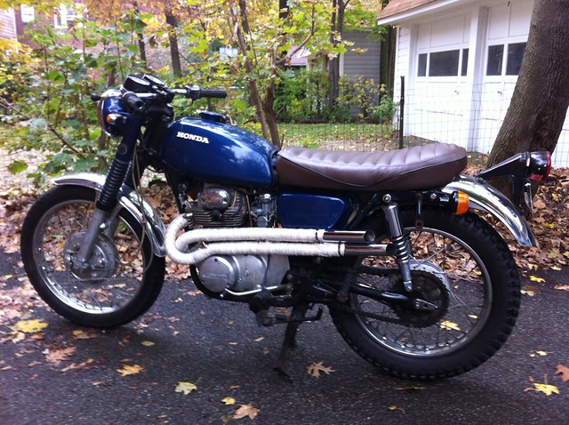

BarnBurner - great looking work on the headers. Those are the stock headers, with the mufflers cut off right? In the pics before you wrapped, the pipes seemed to no be as straight to one another as they did once you wrapped.
Did you do anything to adjust that or is it an optical illusion with the new heat tape? Bike's looking good!!

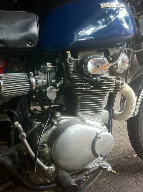

Thanks, brother. You are correct - those are the stock CL headers with the 10lb mufflers cut off. Your eyes are also not deceiving you. The earlier pictures of the chopped pipes showed them as crooked. This was because I didn't line them up properly. The high pipes curve a bit more and are right next to each other, so you have to have them just right in order to line up with each other. I clearly did a better job with that post pipewrap.
Also, thank you for posting your reply. I really need to get back into working on her now that summer is quickly approaching and having a build diary here on DTT is a good way to keep accountable. Here's a more current pic of her but, as always, there's still loads more to do, including fixing the stupid gap between the tank and the seat, switching out cables, tires, etc.

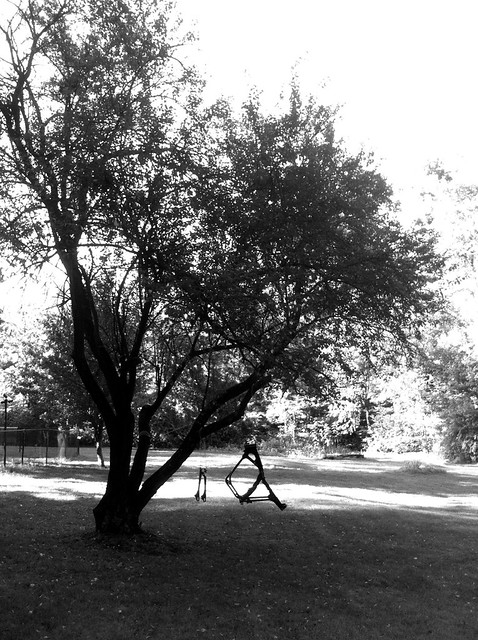

I got the entire frame/swingarm blasted for about $30 bucks. I probably could have stripped them cheaper myself but sometimes it's nice to let others do the dirty work :D . I then hoisted them up in a tree in my backyard (no booth available) and painted everything with a paint/2k clear mixed rattlecan that I picked up from 66autocolor.com . This stuff laid down like glass. The black looks nice and deep like professionally sprayed color plus it's got the fuel resistance of Spraymax 2k clear. I couldn't be happier with the product.

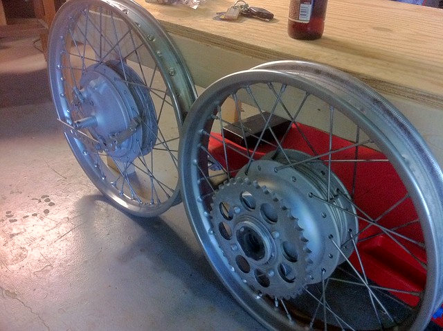

I also managed to find time to bead blast the rims and hubs, which turned an awesome clean matte silver. I'm debating painting the hubs/brakes and spokes black, though.

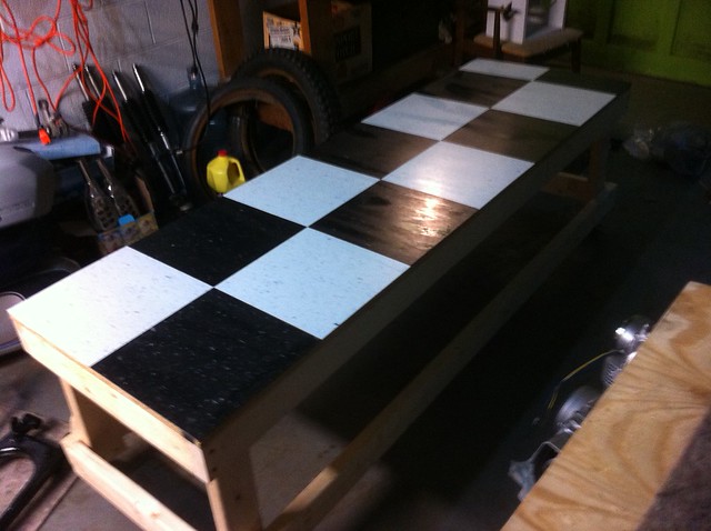

Finally, here is a picture of my finished bike table. I built it out of standard framing lumber and 50 cent linoleum tile from Lowe's. Whole thing probably cost me about $35 ($15 was the casters). Since this picture was taken I've added a lower shelf for all my clean/painted parts. I just received some bronze swingarm bushings and an All Balls Steering Stem/Bearing Kit in the mail so I will probably start re-assembly this week!

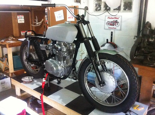

Thanks, Gents. The bike is coming along slowly, but I did manage to get the All Balls steering stem bearings installed last weekend, and get the forks rebuilt. I also just received a new pair of tires (Dunlop K70s), tubes, and rim strips so getting those mounted is next on the agenda. I'll try to throw up some pics when i get home from work.
So I finally got my front end put back together ;D I had previously tore everything down and cleaned/painted the trees and fork lowers. The fork tubes were chucked up in my South Bend lathe and lightly sanded/polished using automotive high grit sandpaper. The chrome steel rims were glass bead blasted leaving a nice matte finish then I had new bearings and seals installed and new rim strips, tubes and Dunlop K70s fitted. The forks were put back together with new seals and the whole thing was reinstalled with an All Balls tapered bearing kit.
CL350 All Balld Tapered Bearings Installed
For the record, the CL350 takes the fat washer that comes with the kit (below is visual, albeit blurry, confirmation - new bearing is on left).
CL350 All Balls Tapered Bearing Kit
Being a bit of an impatient person, I quickly threw on the wheels, my original scrambler bars, and a 69 cb350 tank I picked up at Mid-Ohio, then stepped back and took it all in.
CL350 Dunlop K70
Not too shabby, huh? You probably can see that the front brake is mispositioned and that the rear brake is not even mounted, but I plan on getting new brake shoes so the wheels will be coming off soon anyway. Hopefully, I'll also get to start glassing a tailpiece here soon. I'd like to do a flat tracker inspired piece that has just a small kick up in the back and flat sides to match the 69 cb tank. I have seen people use 750 tail pieces welded to stock seat pans (user Clem's Garage I think), but I want something a bit lower key and very well-fitted to the frame. Plus, I cracked my mower hood the other day so I need to learn how to glass anyway (replacement John Deere fiberglass mower hoods are hundreds of dollars!).
I also need to decide on color. I have some ideas but would be interested in some opinions from the DTT community. I'm looking for a something that evokes the 70s but that's subdued a bit (no metal flake or bright colors). Anybody got any ideas?
Picked up a cheap pair of gloss black BikeMaster superbike handlebars from z1 for like $15. I like that they aren't as gangly as the original scrambler mufflers, but something seems a bit off and I can't put my finger on it. Any thoughts?
CL350 superbike handlebars
