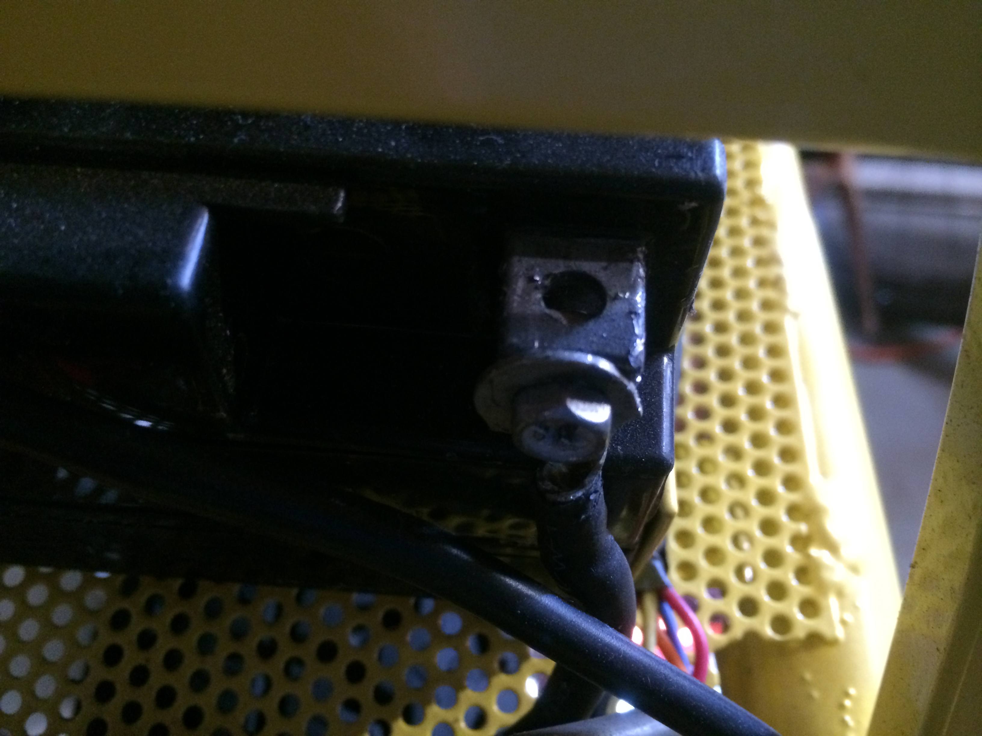

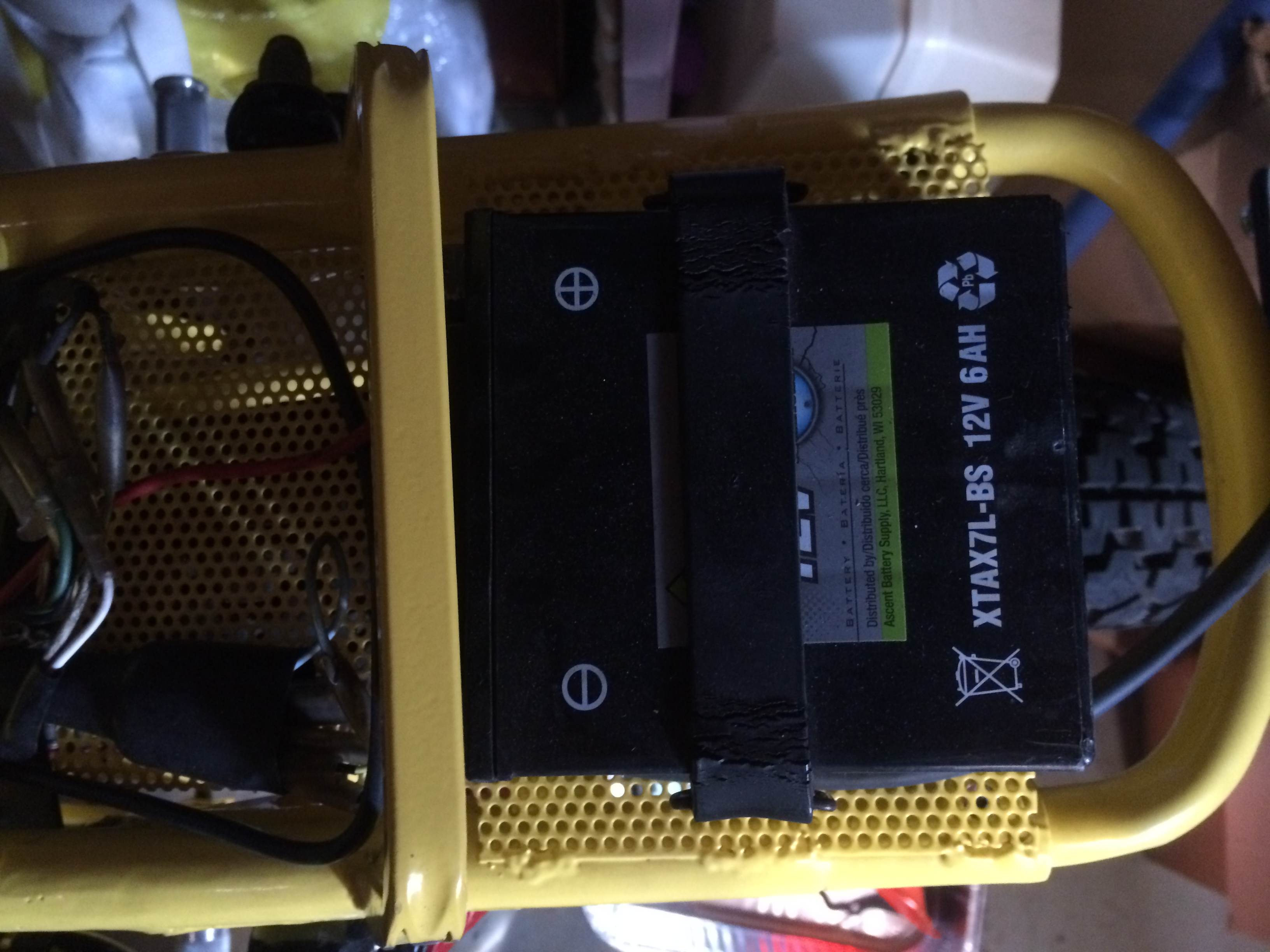

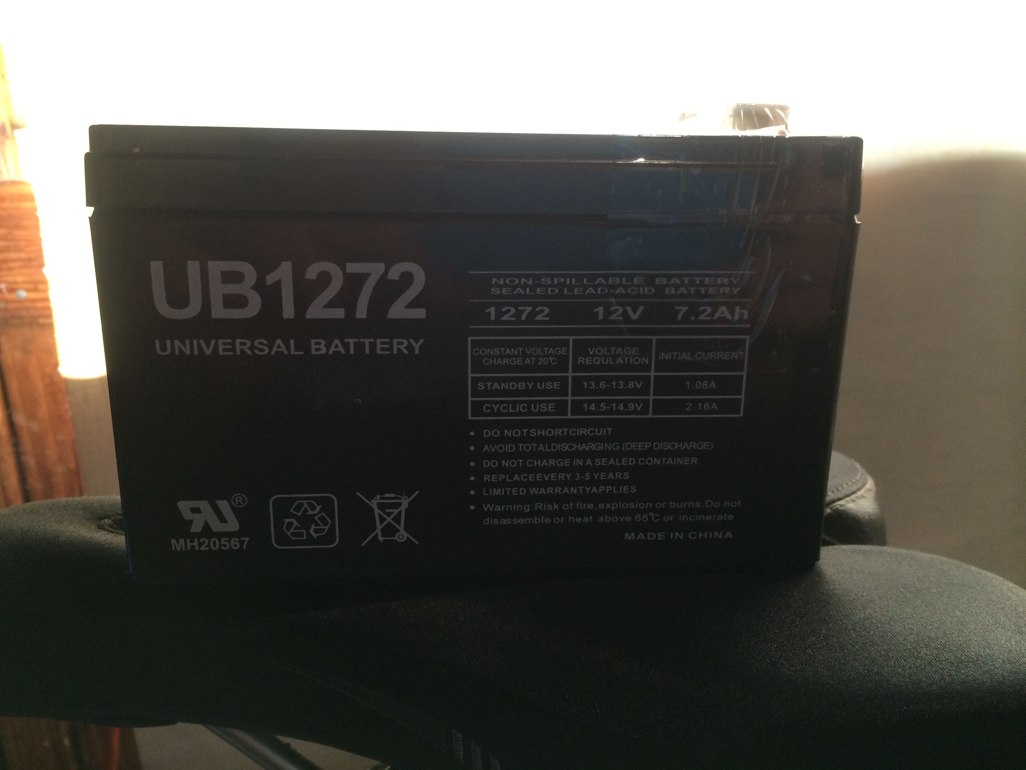

Ok so I just got my battery delivered to me. Just a few questions. Can I install it as is or do I need to charge it first? I don't have access to a multimeter for at least a week so I can't check the voltage. Also the connectors are different then what I have now so I assume I can just cut off the old connecters and put on new ones, right? Or is there some funky black magic I am missing. I am going to attach some pics of the old and new battery. It is the one that Sonreir linked to me at Amazon.
The first pic is the new battery the second one is the old battery.
The third one is the old connector and the fourth one is the new connecter. When I removed the plastic it was the male end of a spade connector. Also can I lay my new battery on its side so that I can fit it in the exiting battery box, thanks.

Yep its all good, should have a decent charge on it. and yes you can lay gel batteries any way you want. Get her hooked up.
you need something good to connect those. dont need it popping off. I can't help w that.
Mine has the same bolt/lug connections as your old battery.
