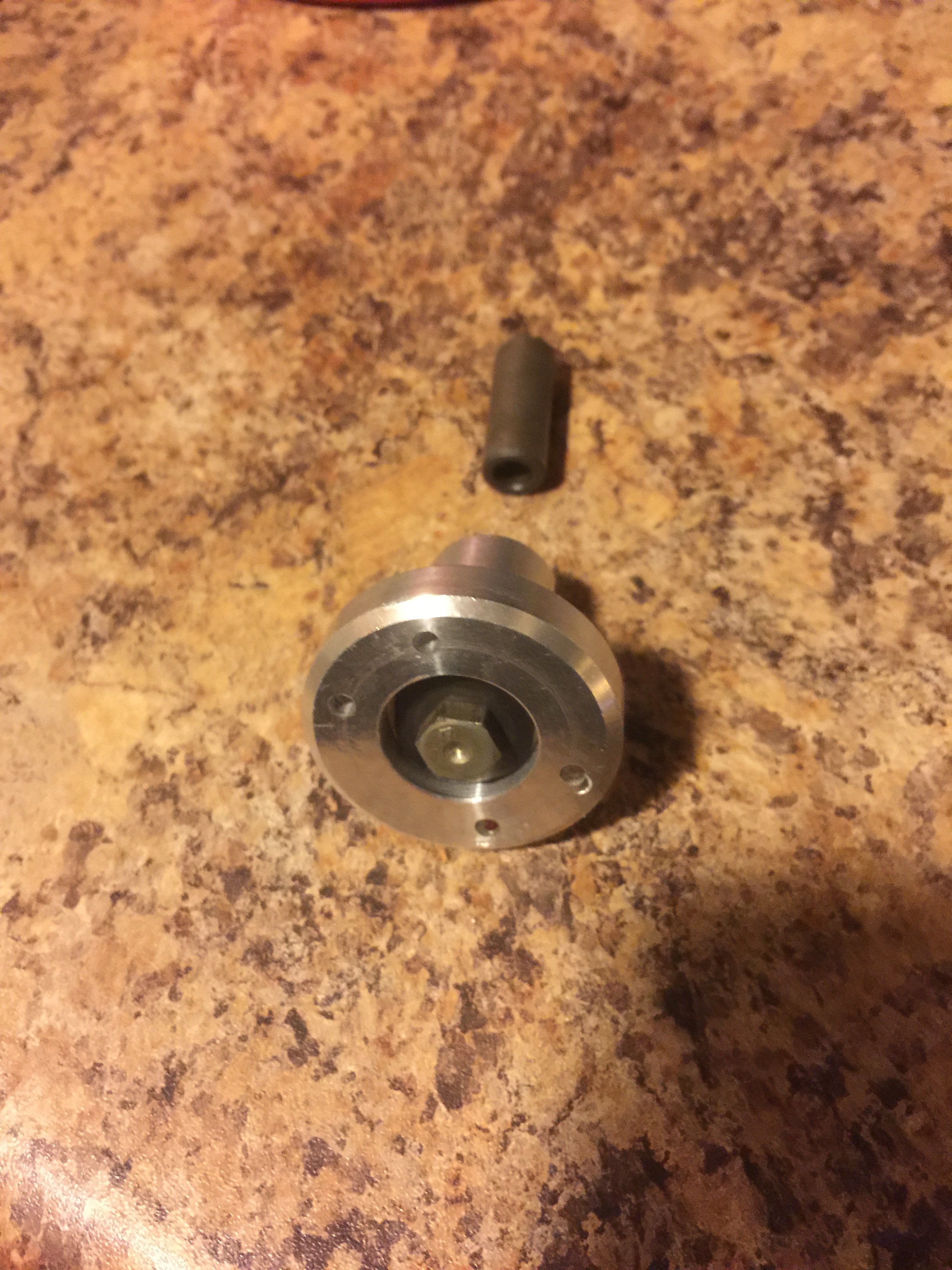

The first picture shows the pamco assembly on my bike with the e-advance (couldn't get the bolt to stay in since I can't tighten it down, the bolt originally fit in the center). Please ignore all the dirt on the bike...
Second picture shows how I was trying to set up the pamco plate with the circuits at 12 and 3 oclock.

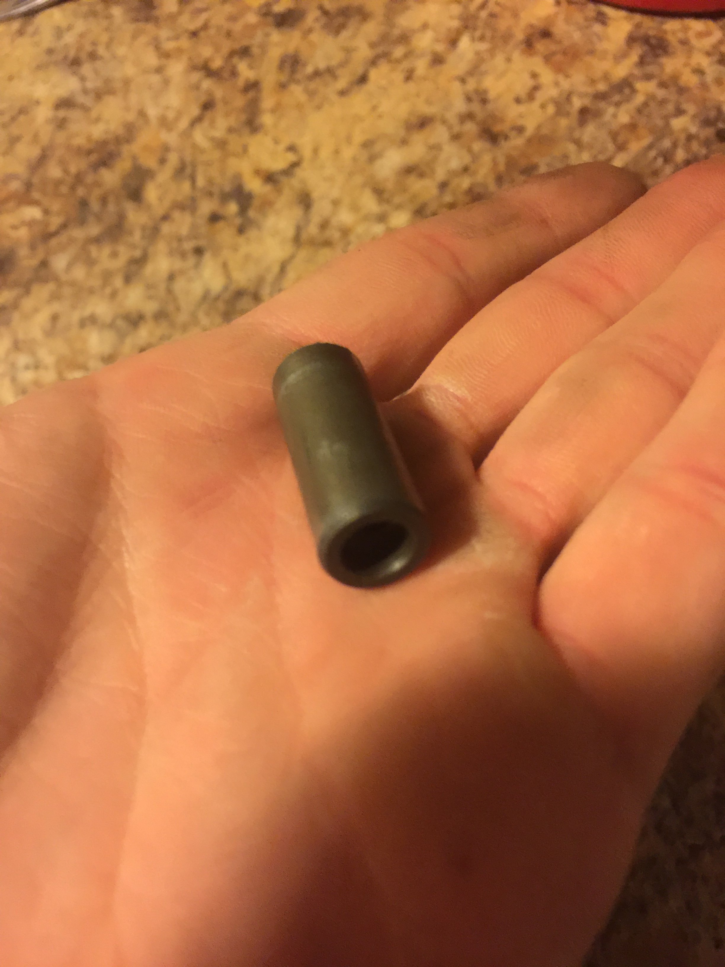

Third picture is a better image of the e-advancer unit with the bolt and the broken piece of camshaft that came off.
Fourth and fifth pictures show the actual piece of camshaft that came off with the bolt.
The crazy thing to me is that the piece of camshaft doesn't look sheered, it looks like it just snapped. I can't really understand how it happened...any ideas?

A cam is hardened, so it has zero flex. Somehow it flexed and snapped. Did it happen while running at some point?
Hi Irk- Thanks for your reply. This didn't happen while the bike was running, I've actually been trying for the past few days to get it running but haven't been successful. It happened while I was tightening the bolt that connects the advancer to the cam, outside of where the points sit on the left side. I really wasn't over torquing the bolt, just getting it snug when I felt the thension give in my ratchet and when I pulled the bolt out I saw part of the camshaft on the other side.
So am I basically looking at buying a new camshaft + doing a top end rebuild at this point? Any advice on where to get the camshaft? I might also need the number for a good psychiatrist after all of this...

You're fine on compression, I wouldn't fix what isn't broken. You're only taking the valve cover off to replace the cam. No need for total disassembly. You can get the pistons down enough to inspect the cylinders for condition. Won't hurt to check specs, but I wouldn't even pull the head unless necessary with your compression numbers.
The cam isn't 'all hard, it's actually pretty soft cast iron with only the lobes 'hardened' (they are still pretty soft really)
You tweaked the extension and cracked it, the break is too clean for it to have been cracked previously. If cam is good, just have an extension turned up in steel, drill and tap cam then screw it in place (probably more expensive than getting a good used cam tough?)
