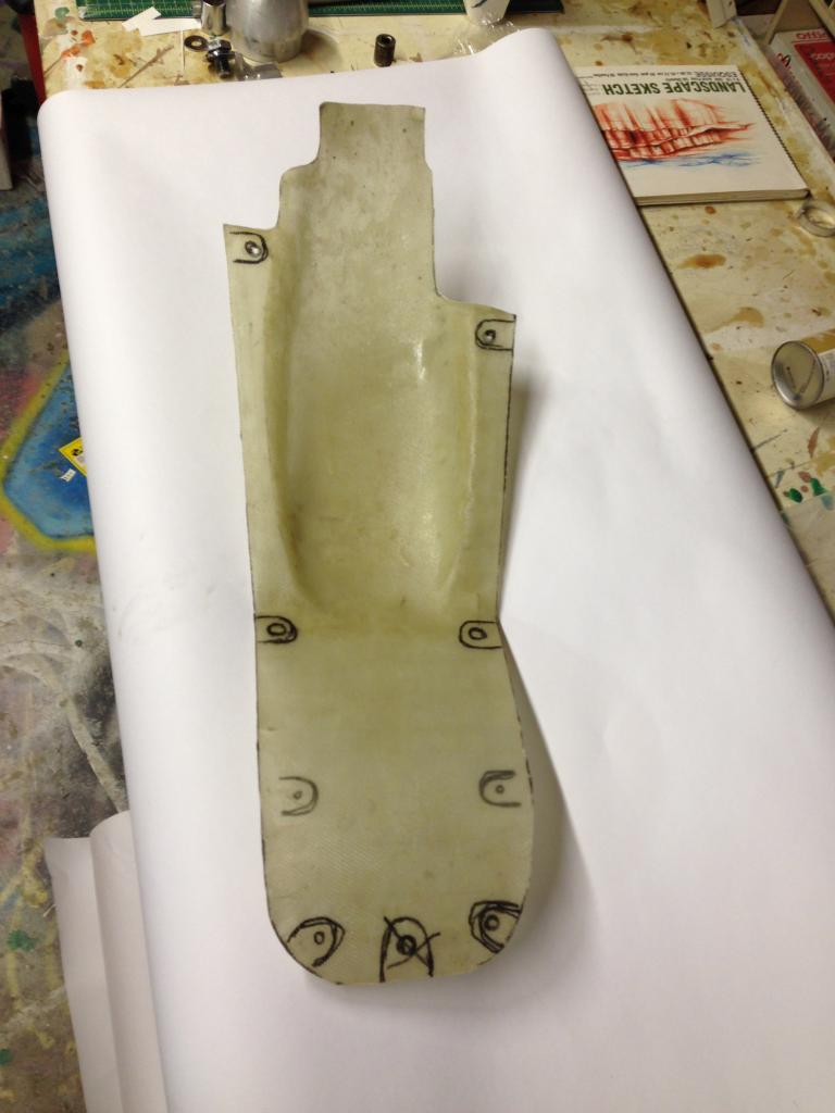

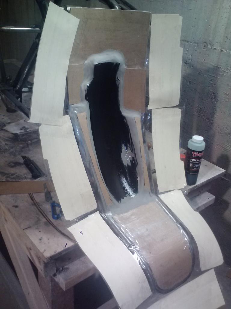

Luckily the fibreglass is so thick on my seat, I think I can skip the carbon fibre sheets :/ probably added another 10kg lol
