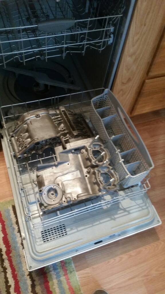

Thought I'd get away with this, but I got caught. May the odds be ever in your favor ;)
Busted washing in the DW is priceless mang :o I dip in barymans dip exclusively and now sent to vapor blast if it's cost effective.
Pick whoring again: But ain't they sweet :P

I recognise those cases as I've just rebuilt a 305. I didn't use dishwasher though
