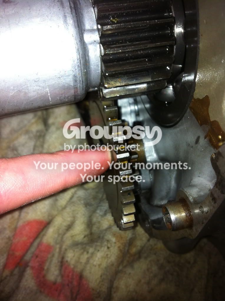

Don't listen to this guy, he's gone senile looking at all the girls in his avatars. I kid, but seriously, that girl is enough to drive a man mad. Anyways, lucky for you, I've had the exact same problem. In my experience, and those that I learned from, it was a small gear that is out of whack. The gasket for the clutch cover has a piece that has to fit behind this gear without pulling it away from where it's supposed to go. This is all very confusing, so here's a few pictures to try and simplify.
Here's a shot of what the gear looks like when it is pulled away from where it should be and will prevent the cover from going on.
I'm guessing this is you problem.
Here is what it should look like. It's a bit of a bugger to fit into the other gear, but keep spinning and pushing and eventually it will fit in.
Now, once you have your gear slid in place, you kinda have to finagle your cover on. The gasket has to go behind the gear and then you press it on to the rest motor. I'm sure you can figure it out.

You sir are freaking brilliant. I have been driving myself insane over that, doing the same steps over and over, expecting different results each time. After several hours I did what any American would do and went looking or meat and beer. I came home, saw your message and on the first try I had that )#($*)(#@#)($ gear settled back in there and the cover slid right on! Thanks so much for taking time out of your night to post that up and help me out. I really, really appreciate it.
