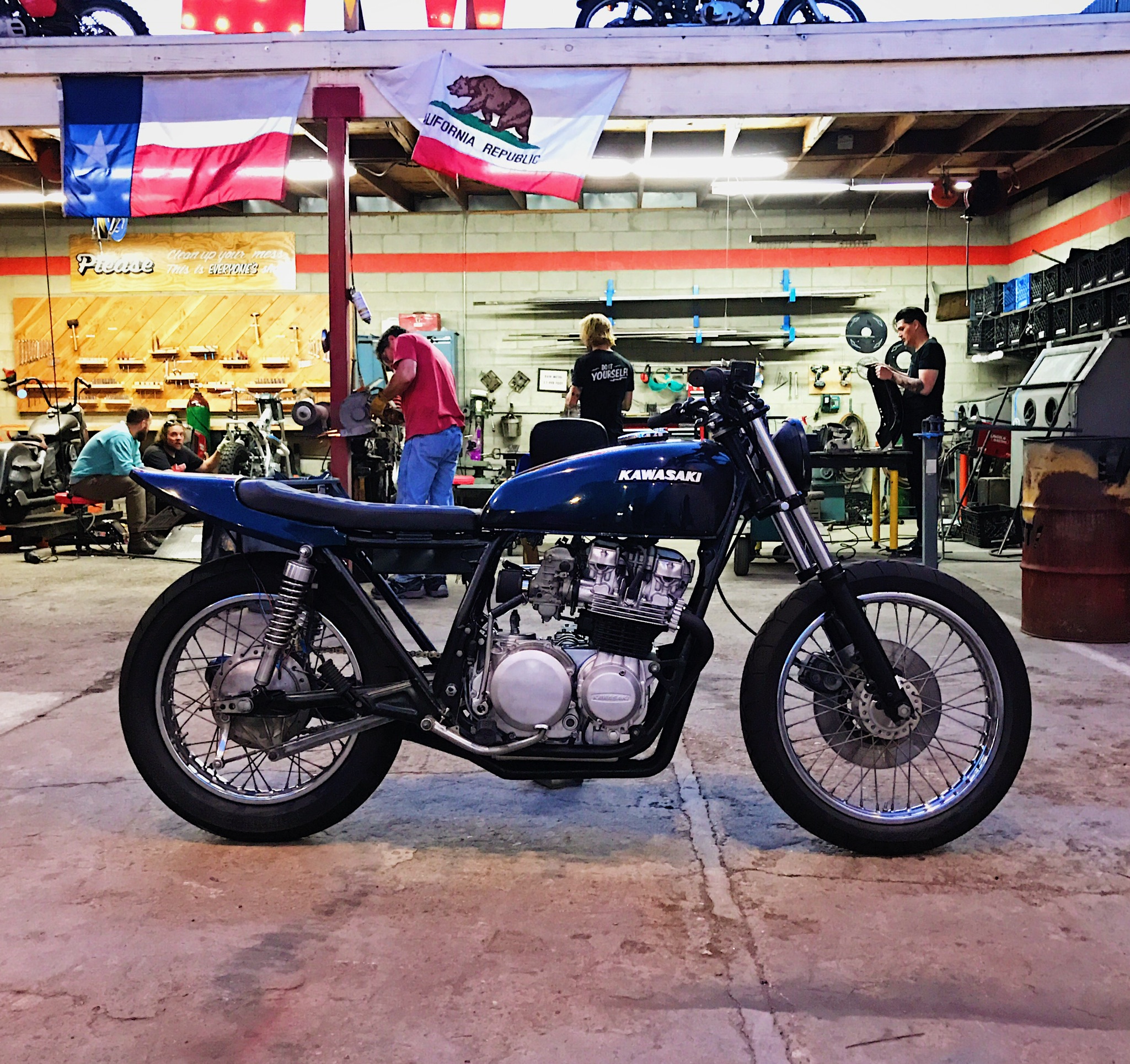

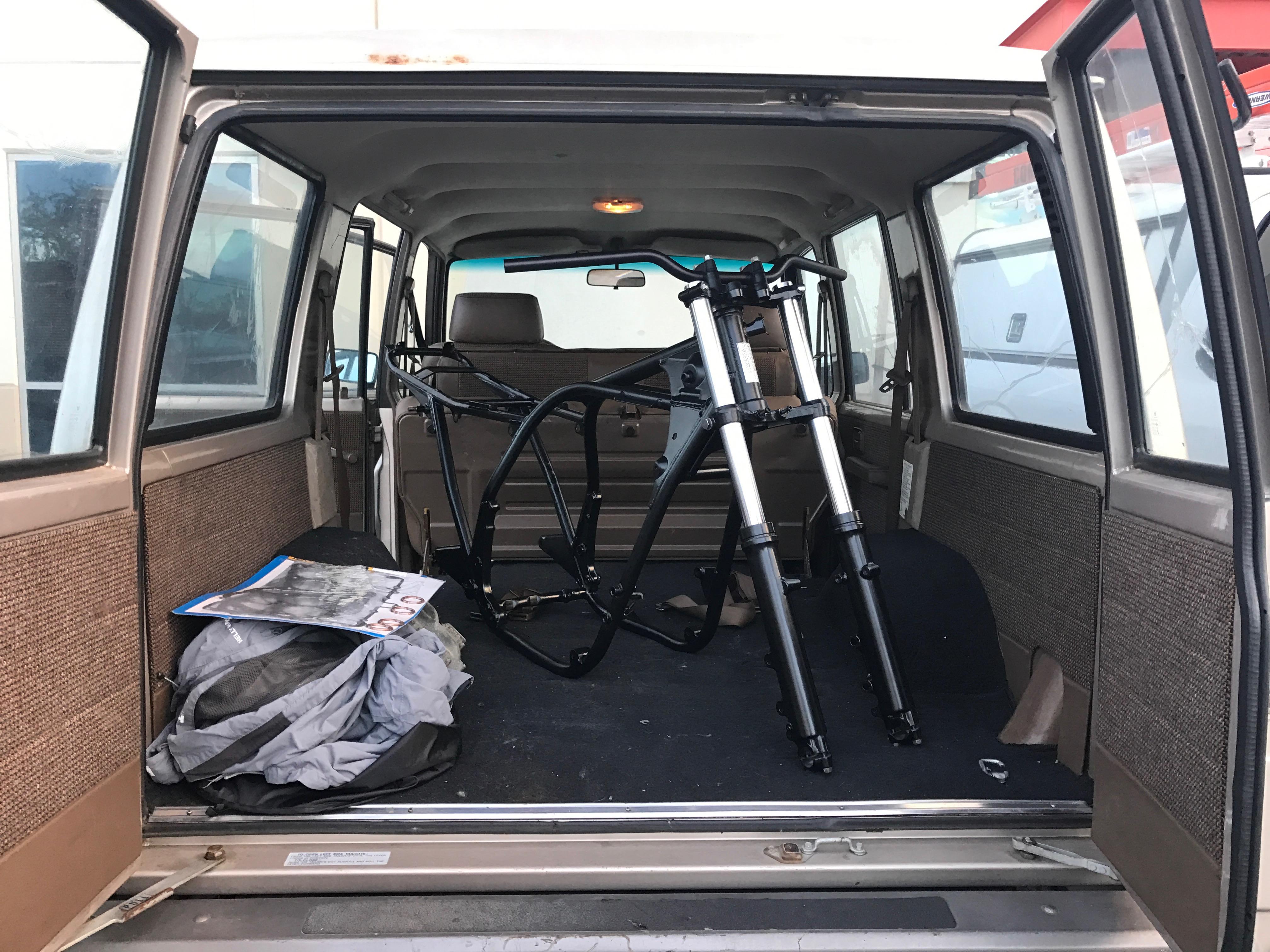

Decisions decisions...It's turning into a bit of a money pit haha, but I should have the engine back next week! I got the new Conti tires installed, frame painted, and all the controls and headlight mounted. New braided brake line, and master came together awesome and feels great just rolling it around the shop! I can't wait to get this thing on the road!
The dyna S ignition and green coils came in along with the 3 phase rec/reg, so as soon as I get the motor back in I can get it all wired up! Hopefully since just about everything on this bike is new, it will come together smoothly....but I doubt it haha.
Anyways. Next week I'll make the stainless batterybox and seat pan. I was able to get it all mapped out. Just need to decide on a seat layout. Not sure if I want the bump for the passenger further up, or pushed all the way back. Leaning toward the thinner setup.
Photos following! Let me know what you guys think about a seat setup.

Have you considered a longer swingarm? Maybe only +1 but somewhere in the +1-2" range would really balance the bike out. Also keep you from flipping with all that new power

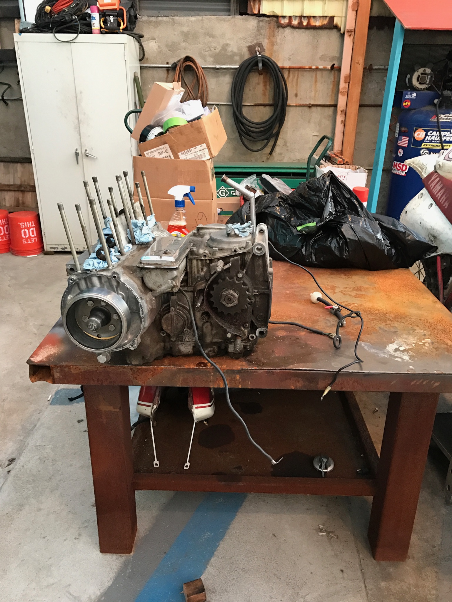

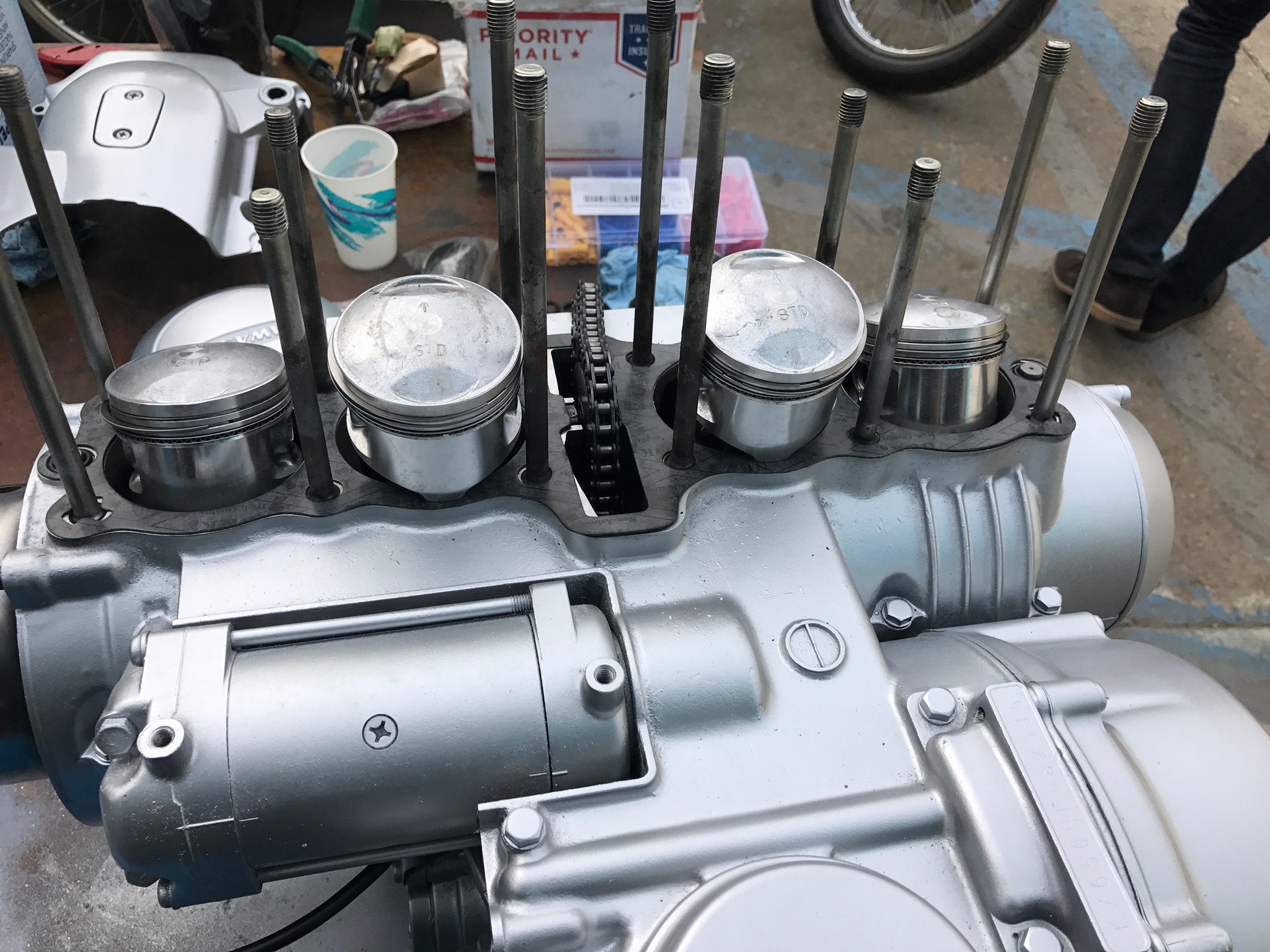

Been a bit since I updated this but I made some major headway on the KZ.

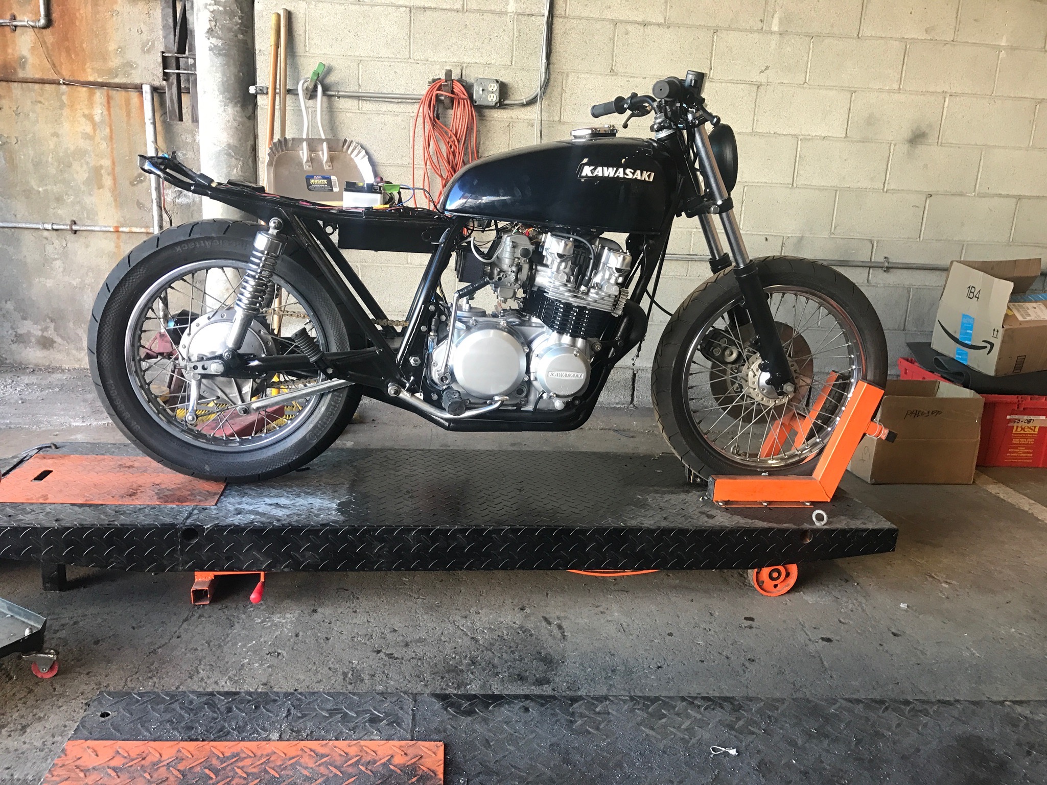

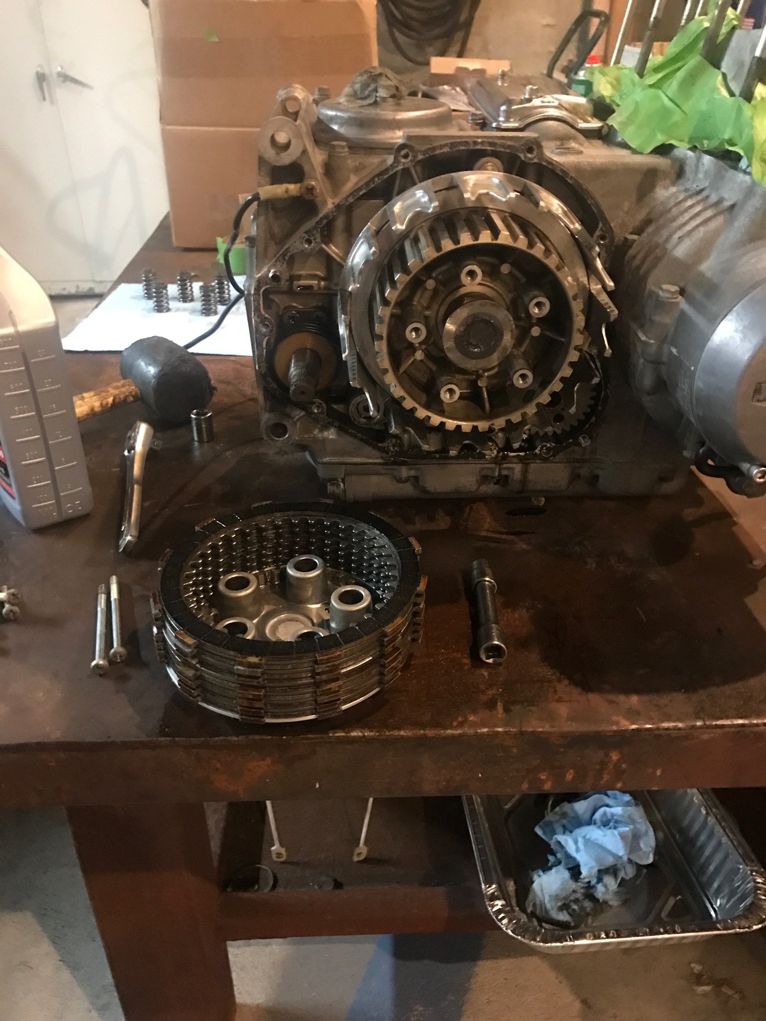

The motor is back in the bike and has all fresh new parts! New pistons, rings, clips, valves, guides, seats, head was shaved by 0.020" and everything is ultra clean! Boyko Racing really helped me get the head all sorted and cylinders honed. I shimmed the valves (I cant believe the range for all valves is 0.08 to 0.18mm! I set them all at 0.10 to be safe) and got all new gaskets and mating surfaces cleaned. I installed all new stainless bolts so there wont be any more rusting on this motor and torqued to spec. All new polished hardware and motor mounts so everything looks the part. The new stator for the 3 phase system is done and wired in with the new 3 phase reg/rec unit.

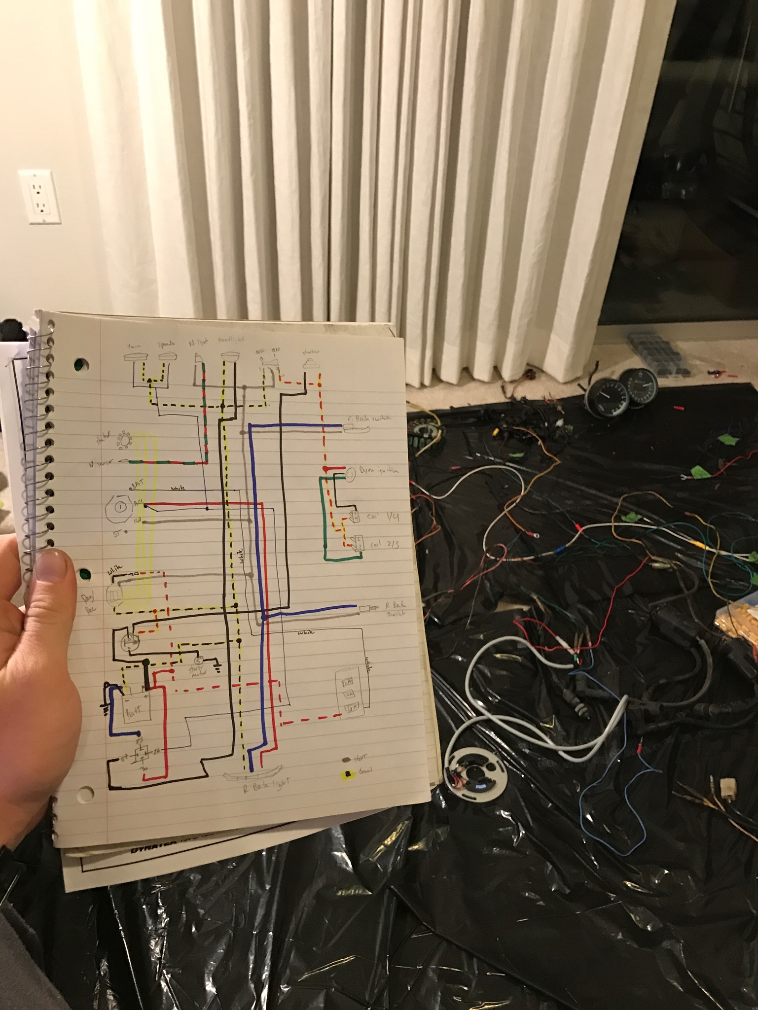

I rebuilt the whole wiring harness in my apartment last week and made sure it all lined up properly with the Dyna S ignition and 3 phase charging system. I just need to drop it all in the bike now!
I'm hoping to get the wiring all hooked up and running properly this weekend so then I can start the bike next week! Still need to drop off the seat to be upholstered but, but thats about all that needs to be done.
Cant wait to get this thing running! Its nice to have fresh new parts haha! Pics Pics Pics!

This bike got good reviews for it's handling back in the day, I wouldn't put a longer swingarm on it just for looks.
I've read that too. I've kept everything stock for now as far as fork and shocks go. I'd like to preserve the stock geometry. If anything I've just made the whole thing lighter so hopefully it'll be a hair more nimble bike.

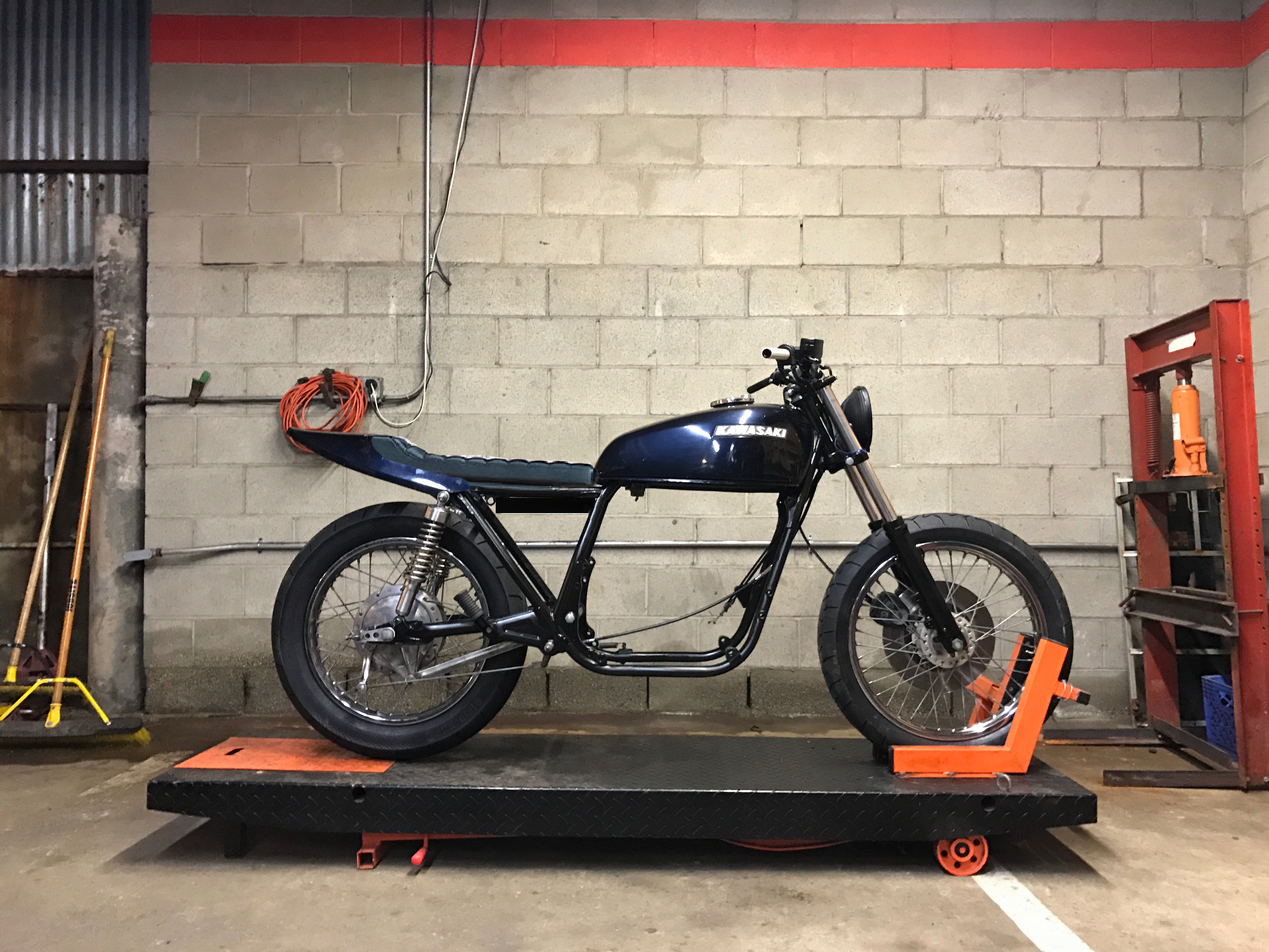

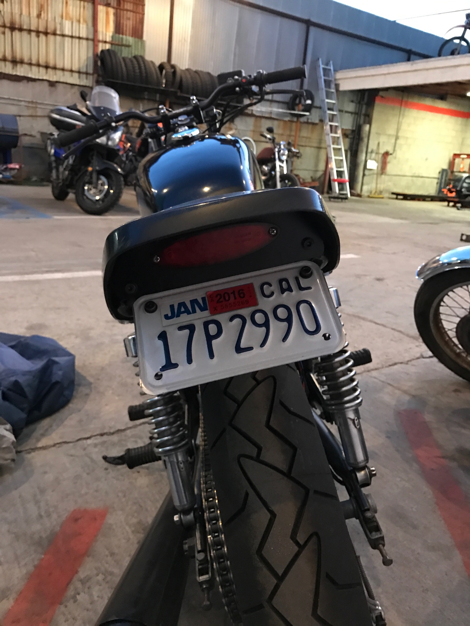

The bike is alive! Got it started but still need to fine tune jets. All electrical is solid and running. And seat is at my upholstery guy and should have it all by the end of the week!
Photos attached! Its in its final push, so hopefully I can get on it this week!

I'd "spring" for some new shocks too. The factory ones are horrible. Looks good.
I agree with Doc. Those factory shocks will literally Spring and jolt you out of your seat. I got Progressive 14 series on mine(oil), standard spring rate. They are great for my weight (170); however, I kind of wish I got the 12 series (nitrogen). Standard spring rate is good for minimal load. If you weigh a lot more and/or will ride with a passenger often go with heavy duty spring.
Hagons are the other brand that KZ650 riders swear by.
I agree with the Hagons, have bought several and they work well. Also, I've said this before, it's your bike and $, but why design a bike who's sole purpose is to pick up every piece of debris and throw it at your art. Fenders can look good and serve a purpose.
I agree and you can tie the fender in with paint as well.
