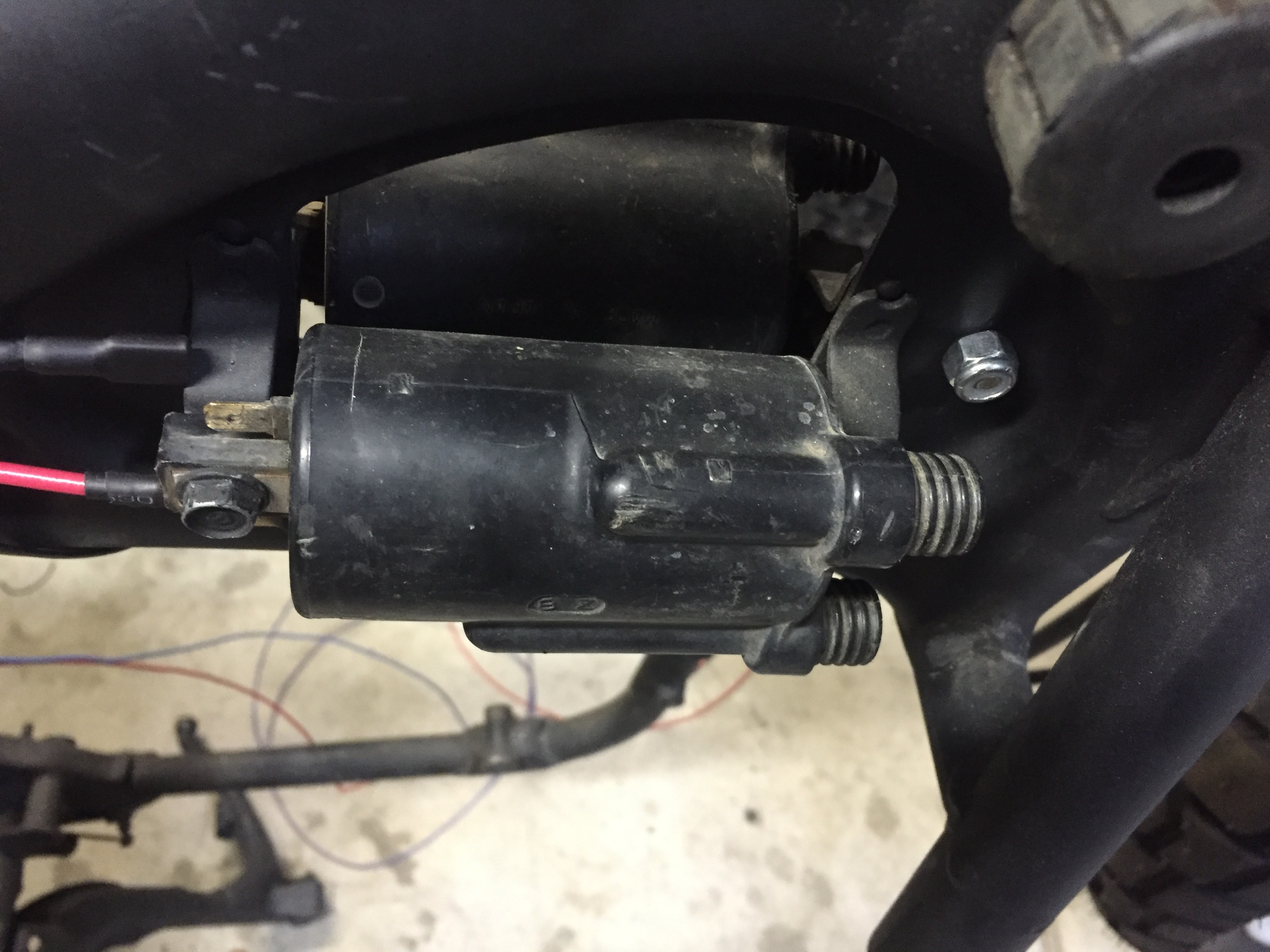

I have a split ignition coil on my 1979 cb650, so I need to replace them desperately and as always cheaply. The bike is being bored to 61mm (due to corrosion from sitting) so the plan of buying nice new coils has gone out the window because I have to pay for that now. If anyone has coils they want to get rid of let me know!

post up some images of what you need so i can get you the one that mounts up without issues
ok i got a set of 2 offa gs1000 suzi they look good no visible damage ill ohm ttest them in the morning
they look more like coils you would find on a honda 4 than those goofy ones you got there

Sounds good! let me know what you find out. my current ones hit 2.5 and the cracked one is 2.5-what ever the hell it wants. my manual calls for a 3ohm coil so those are obviously past due! I sent you a pm as well.

those "goofy ones" are the same as all 3 of my cb650s have
