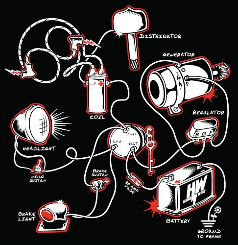

Your bike needs like ten wires to run. Search for SOHC Honda four wiring diagrams, there are some great ones out there.
I found this graphic on some other motorcycle forum. It's pretty much that easy.
If you're building a 47 Knucklehead. If you're building a 70s Japanese bike with signals, there's at least twice as many wires.
