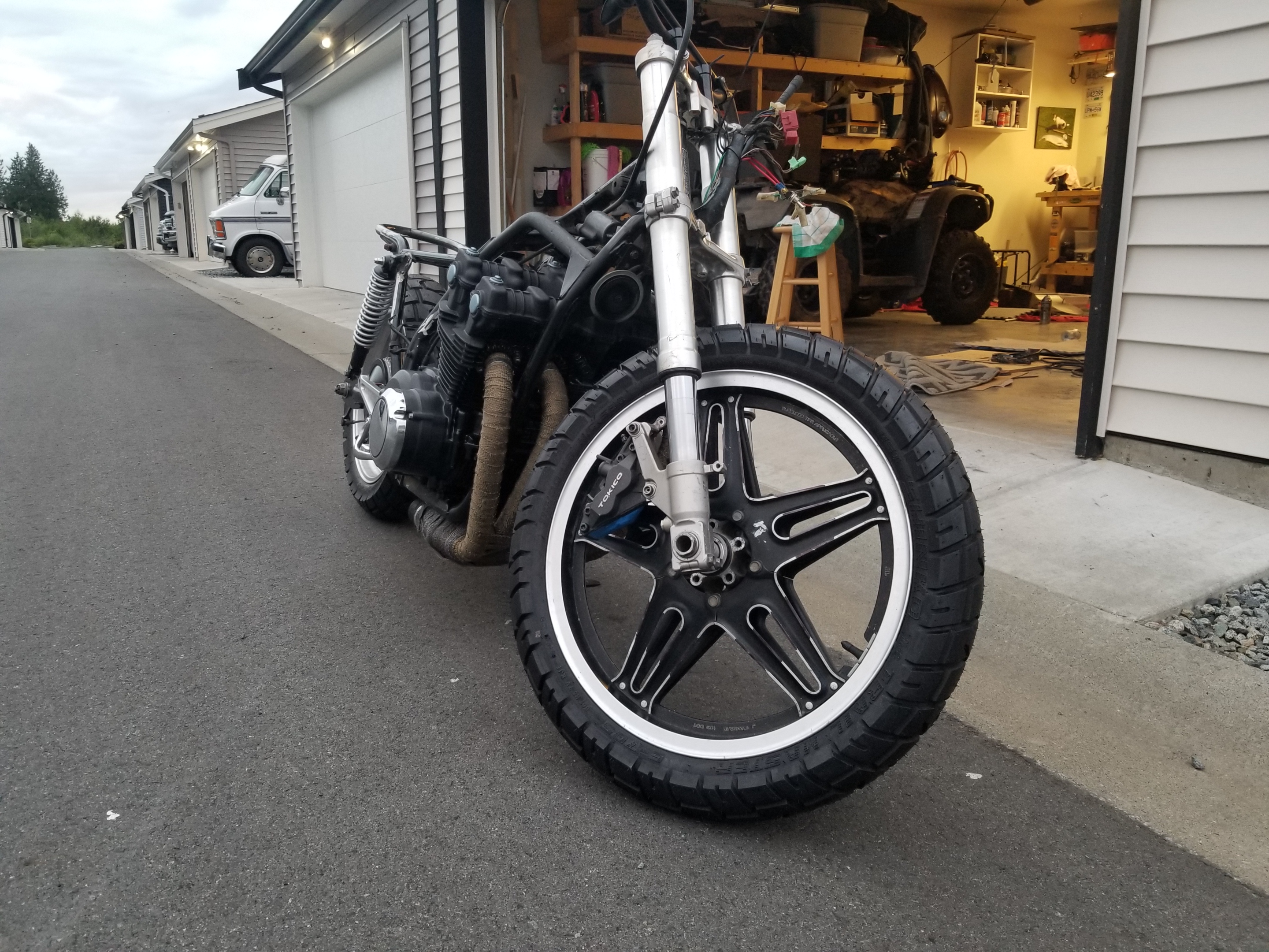

Sorry to resurrect an older thread, but Google directed me this way. I have single disk, newer reverse comstars on my 79 cb750 limited. Did anyone find a way to make these work? Are they not as wide as the twin disc versions the OP had issues with being too wide/caliper clearance issues? Any help would be greatly appreciated as I'm gonna go this route myself. Comstars just have the look I'm looking for. Thanks!
Post pictures of both sides of your wheel hub. It really depends on that. If the wheel hub is the same as dual disc, there is no reason it wont work. If the hub really is different, then it's easier to get a new wheel to start with than try and make the original work.
I was able to get reverse comstars to work with GSXR fork. No need to ditch them and go for standard comstars.
