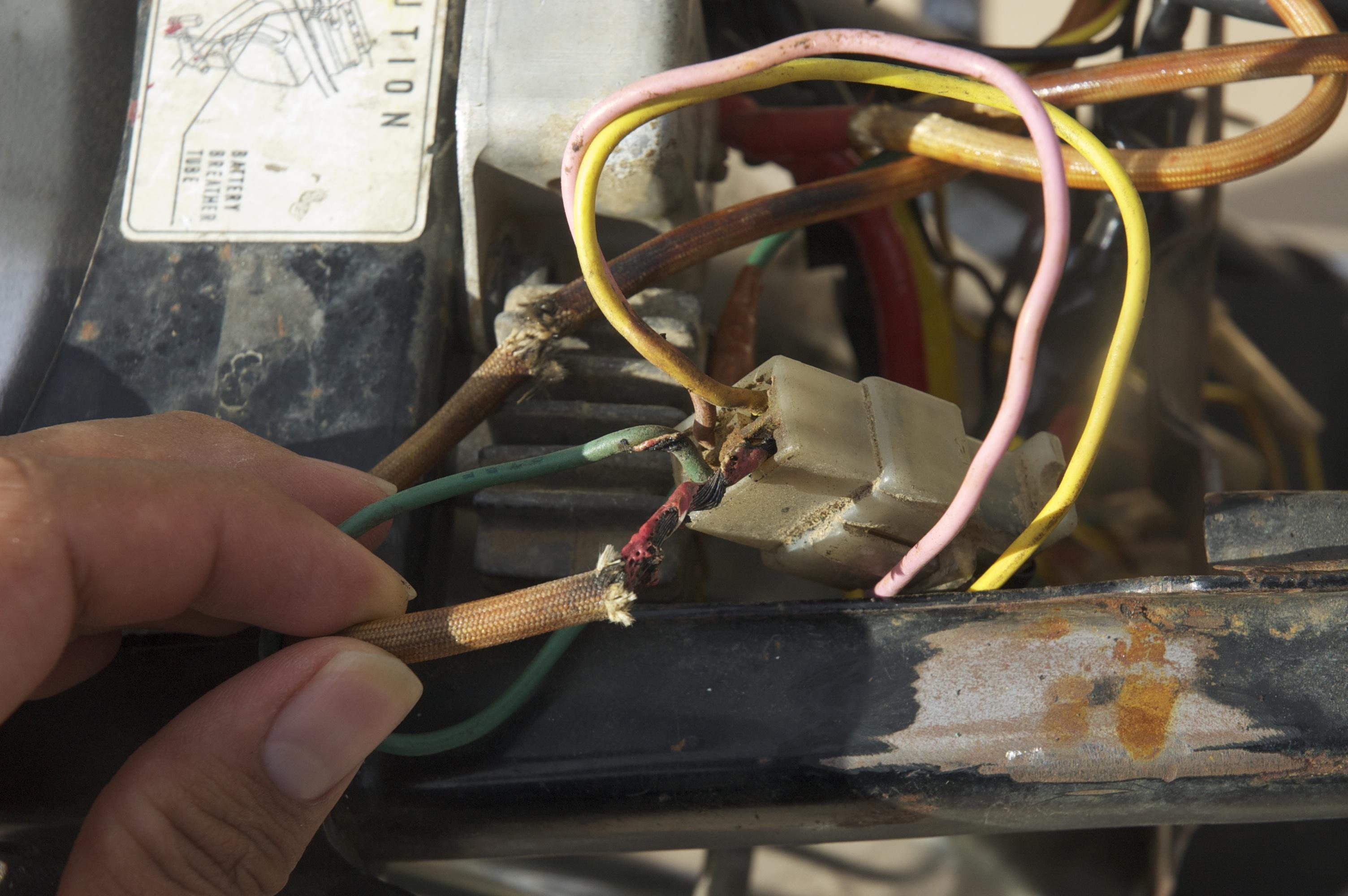

So i Charged my bike and connected them wrong and now bike won't start. i checked and found what looks to be fried wire. is this salvageable or should i get another one?
That looks really nasty. Find a new plug, cut the cancer and solder the plug ends to where the cable is fresh. also check you did not fry anything else...
