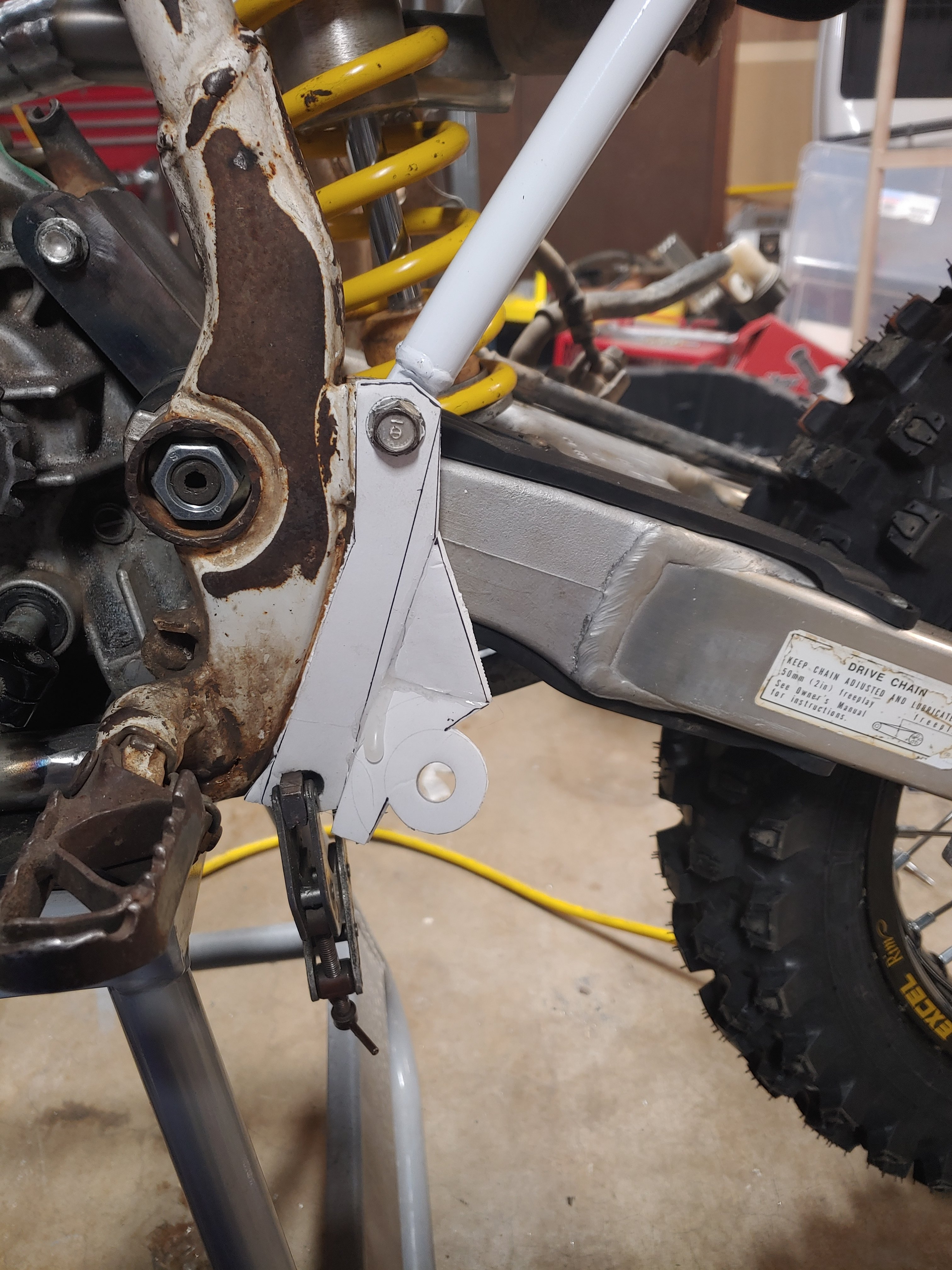

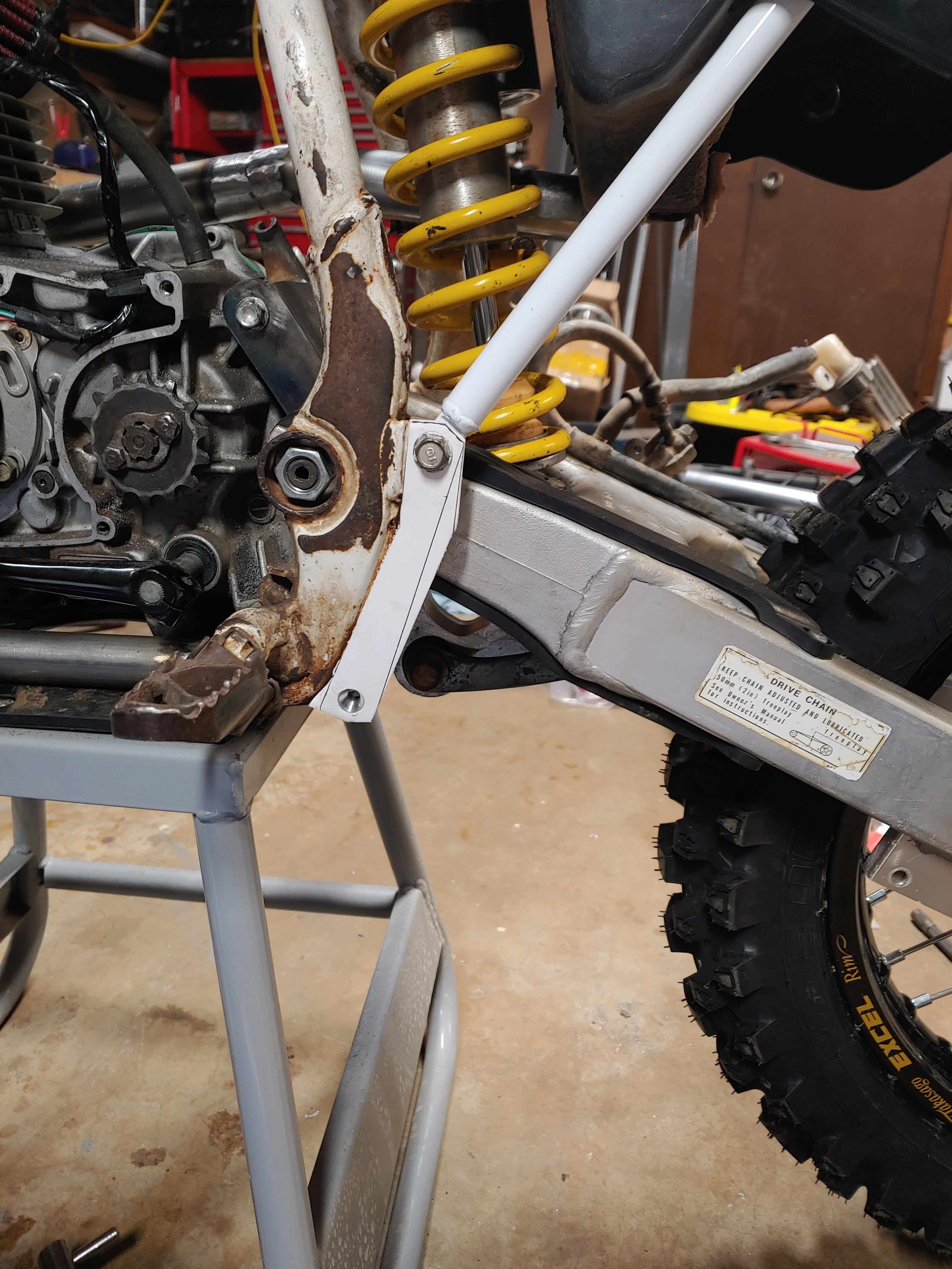

Well some progress on the kickstand bracket. I think I've got the foam template about done. Kickstand should sit far enough out to be stable and tuck in pretty decent when up. Foamboard and dowel rods made it pretty easy to visualize and figure out the swing. Length will be determined with the bike on its wheels with the bracket done in metal.
Theres a little more work on the bracket and I'm making the top of the kickstand, but waiting on some small DOM to take the leg itself. Once I make the leg I'll figure out the spring. I'll probably get one for some other enduro/dirt bike and positiin things to work with it.
Thanks! It's a little closer now. I added the triangle brace in and started sanding the welds down to make it look nice once painted. The top of the kickstand is done, just gotta wait for my tube.

Some progress made today. Kickstand now has a leg, and forward travel was limited because it went too far. Some things you can't tell until you commit to metal and can actually test it. It's going to get shortened another 1/2" so that once I add a foot it'll lean a little more than it does now. That should make it useable on the trail and not just pavement. Spring should be here in a few days.
