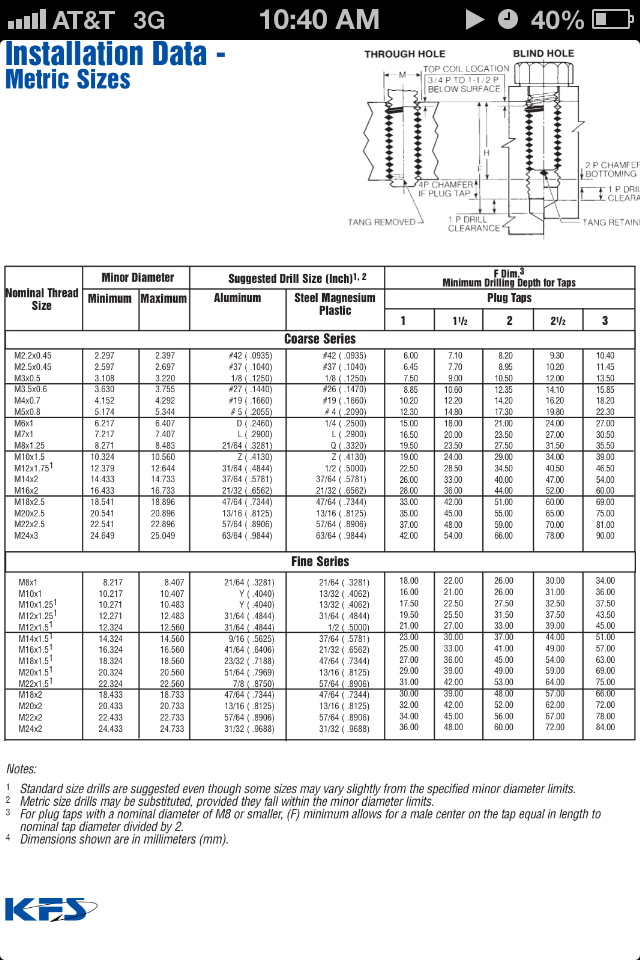

On the subject of helicoils, watch out for a wrong drill size called out on 10mmX1.25. it calls for a 31/64 which is for a 12mmX1.5 instead. It should be a Y drill!

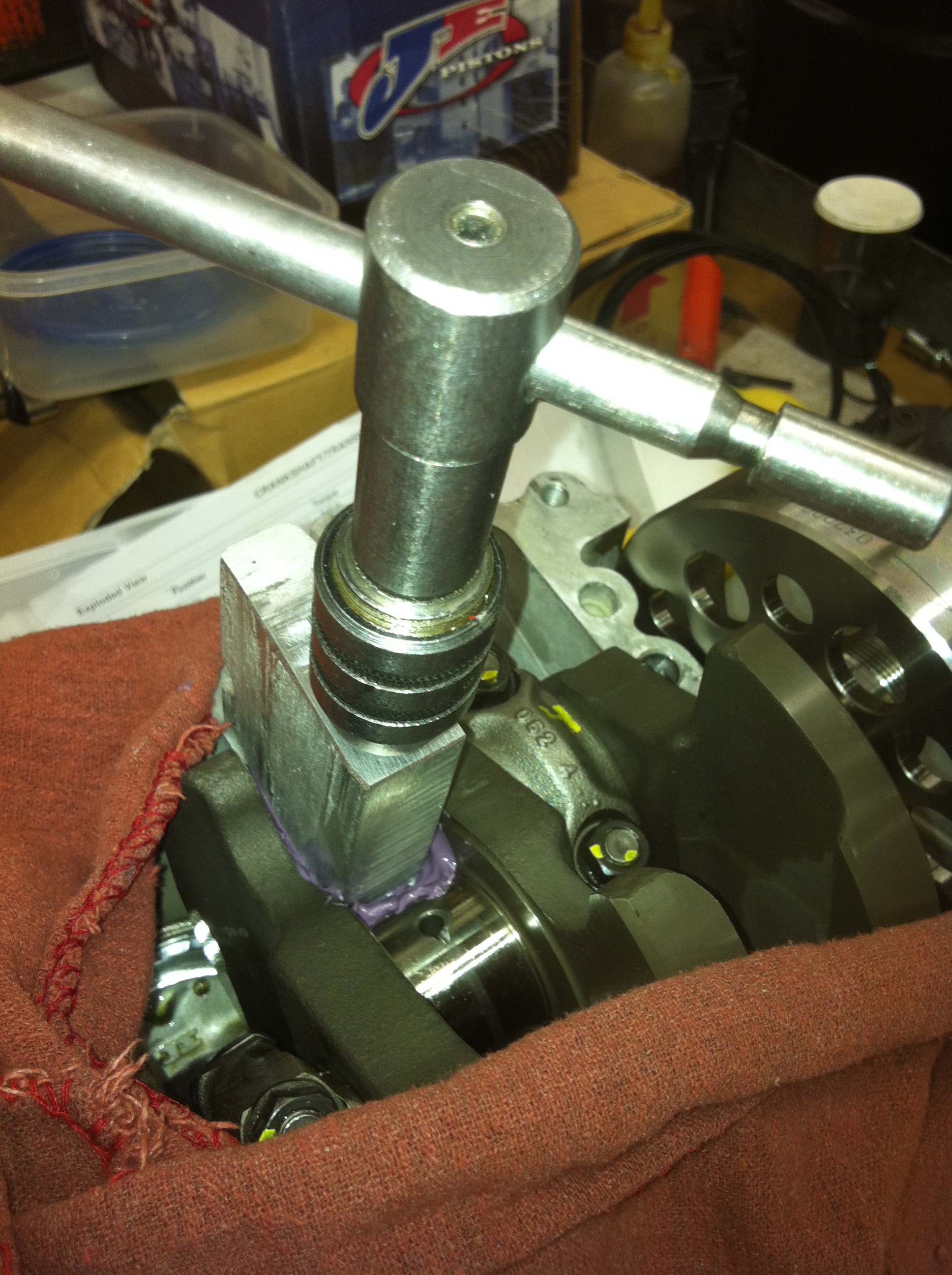

If you have the room a drill bushing, can help you guide the drill, giving you a surface to reference from, using the flange against the head surface.

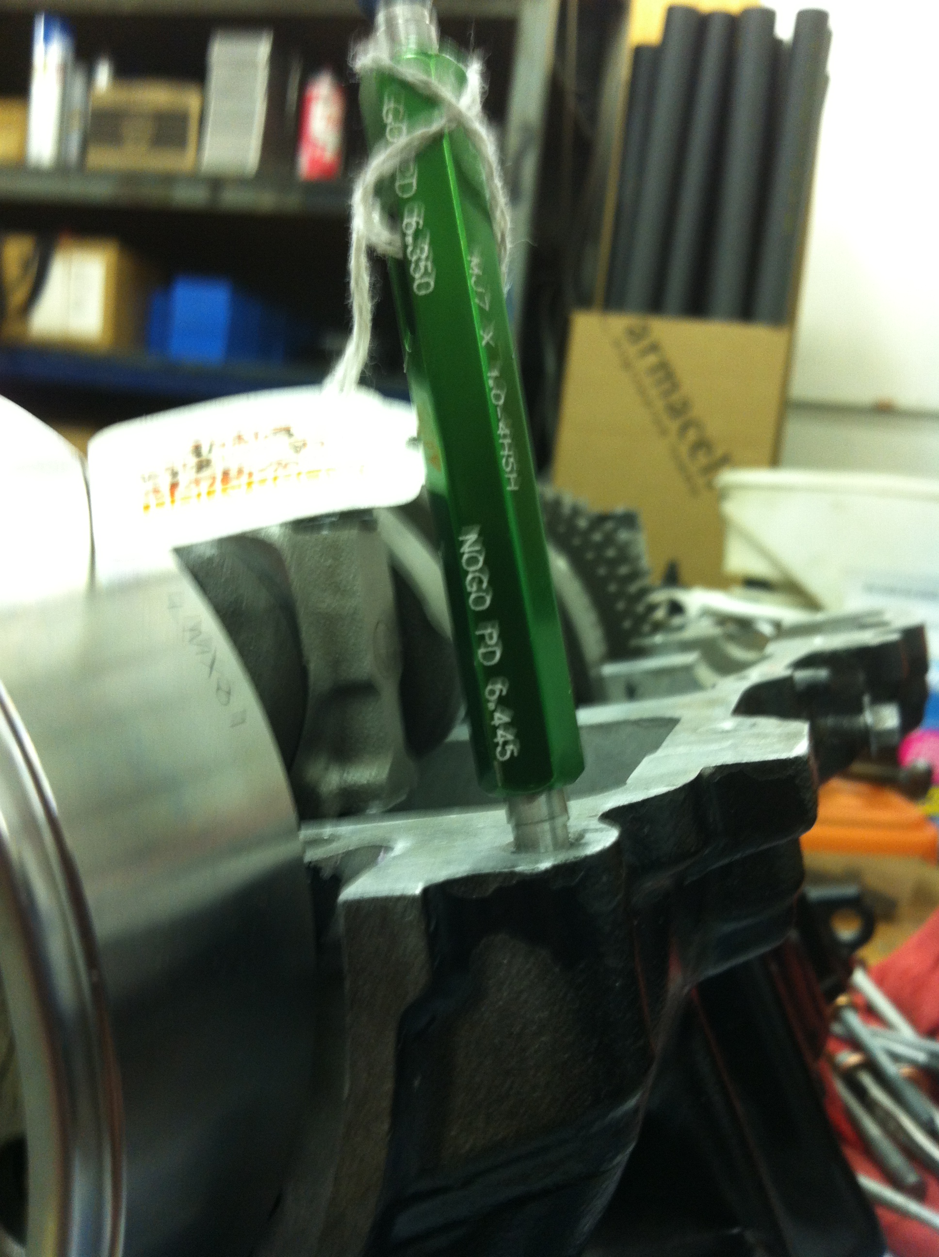

Then use can use a home made tap guide, yours will have to be round. I just counter bored a block for the thread cutting teeth, with the stem having a guide bore. A thread insert, like in the head repair thread, is a very good repair if you have the room. If not, you will to use a thread insert of a helicoil type. The insert shown in the head repair thread,
had a locking ring that was pressed in place. Factory threads sometimes use roll form taps that will allow a no go gauge to fail the thread. Also factory threads can be inferior to the bolt specs.
