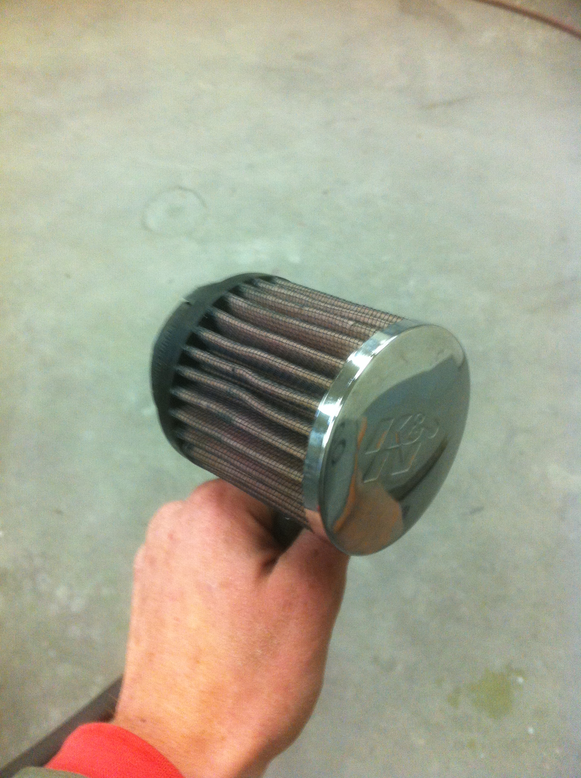

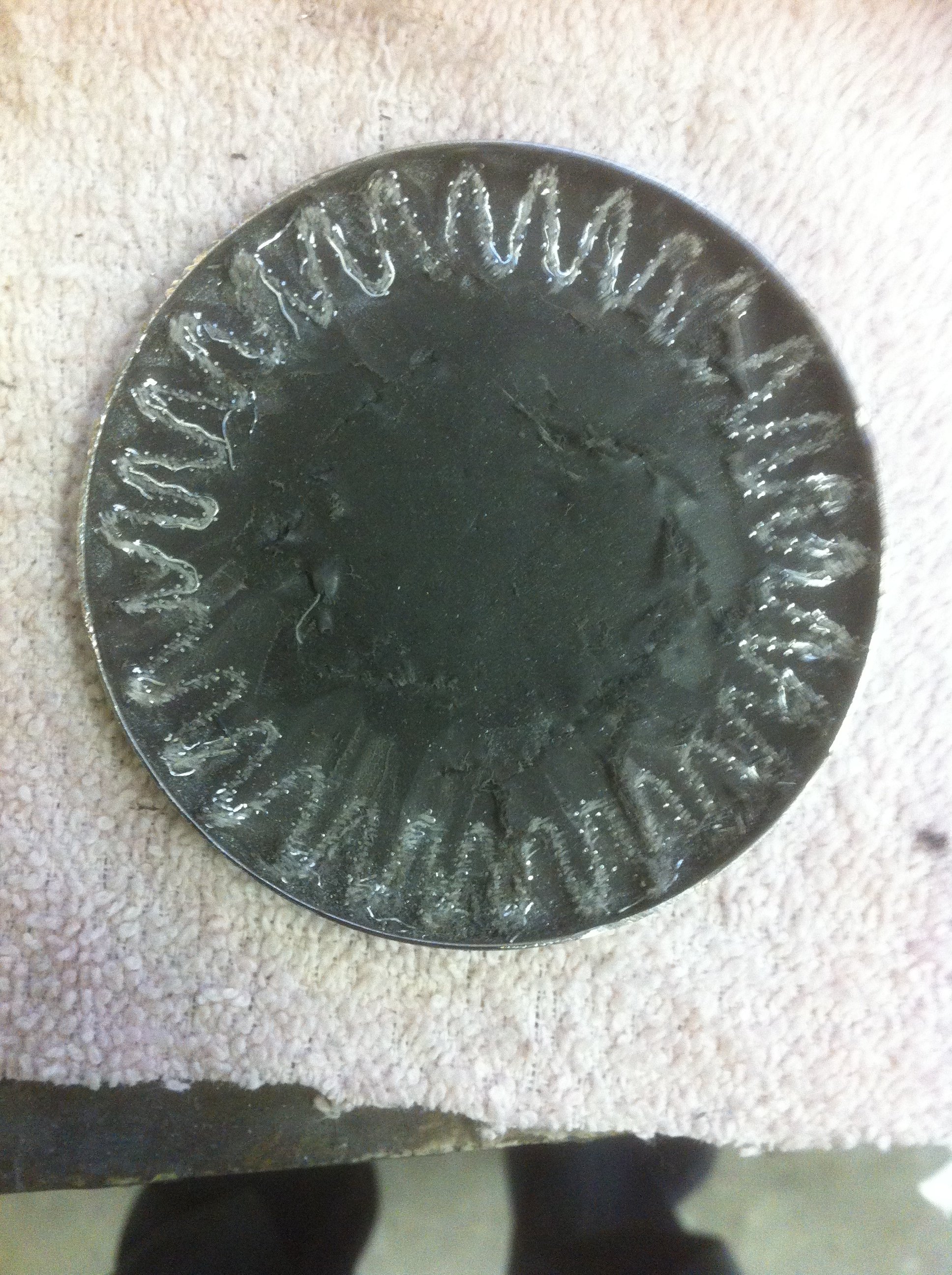

Holy S*** after weeks of beating my head against the wall trying to figure out why my bike was bogging hard, this thread just answered it all. I checked/tried literally everything trying to get this thing running properly, and turbulent air was the problem all along with the k&n pod filters. I tried putting the factory air box boots on, and voila. Bike runs perfect. So, that being said...... Here are the mods I made to my k&n pods. First off, I wanted to shorten them up for two reasons. 1- Clearance issues to my "fake oil tank" made them really hard to get on and off without scratching the paint, and 2- wanted to cut back some air flow to mimic factory air box. After cutting the pods open, I ground out the rest of the cloth/mesh filter from the chrome filter caps. I had some velocity stacks kicking around I shortened, and just happen to fit like a glove into the rubber boot of the pod filter. I RTV'ed them in, then ran a thick bead of RTV on the chrome end caps and glued them back on the ends of the filters. I already had tried the equalizer line between the two filters because supposedly, these bikes like a common air source, so I left that alone. So basically, I have pods with velocity stacks inside, and an equalizer line. Took the bike for a ride today, and its running perfect. Thoughts?

as far as your filters you have created something with a great deal more restriction than any stock airbox
you are certainly losing a lot of horsepower on topend,because it takes air to make horsepower
did you ever even ride the bike in stock tune ?
that is, stock airbox and pipes ?
Machine gun exhaust tips, google it. Just simply drilled pipe. Without knowing the specs on the filters, or the velocity stacks as far as diameter, length etc., how do you know its a "great deal more restriction"? There's a lot more that goes into making horsepower than just air. Save your fingertips, I'm not going to start an e-pissing match with you.

You'll probably find the total surface area of both K&N filters is similar to the single stock foam filter - BUT - both carbs breath through the single foam filter so the airflow is more than likely restricted with single K&N on each carb.

the stack stuffed up inside the cut down filter is the major restrictor that i see
the air is working too hard to find its way
