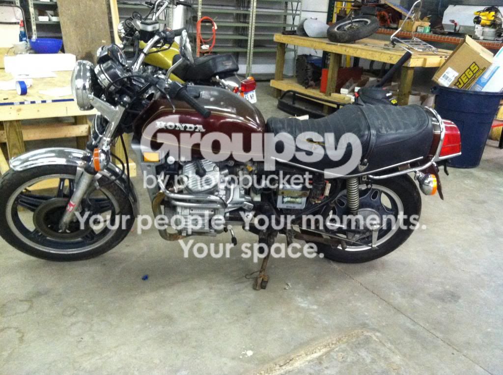

The plan is to make a street tracker out of a 1979 cx500d. I got it for $350 and it runs so time to tear it down.

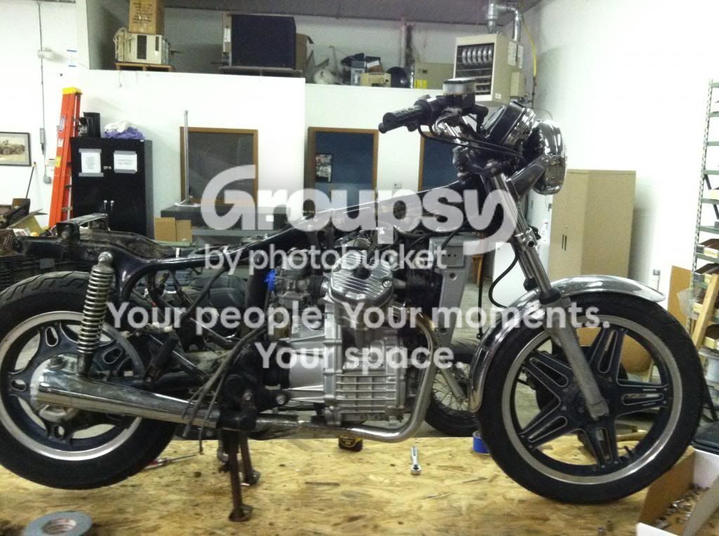

So I put it on the table and got to work...
This is how it started
and this is how it ended.

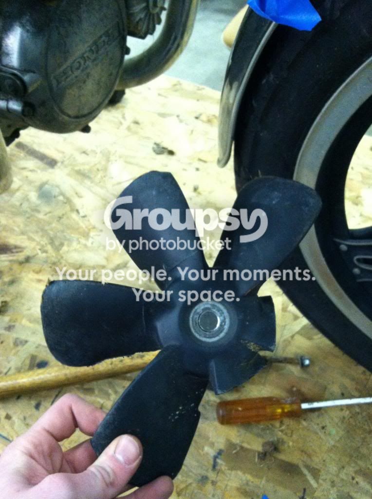

So the easy part it over and I pulled out a radiator fan blade from a crack so the next job is to remove that and find what's up.
Once I got the radiator off I found this.

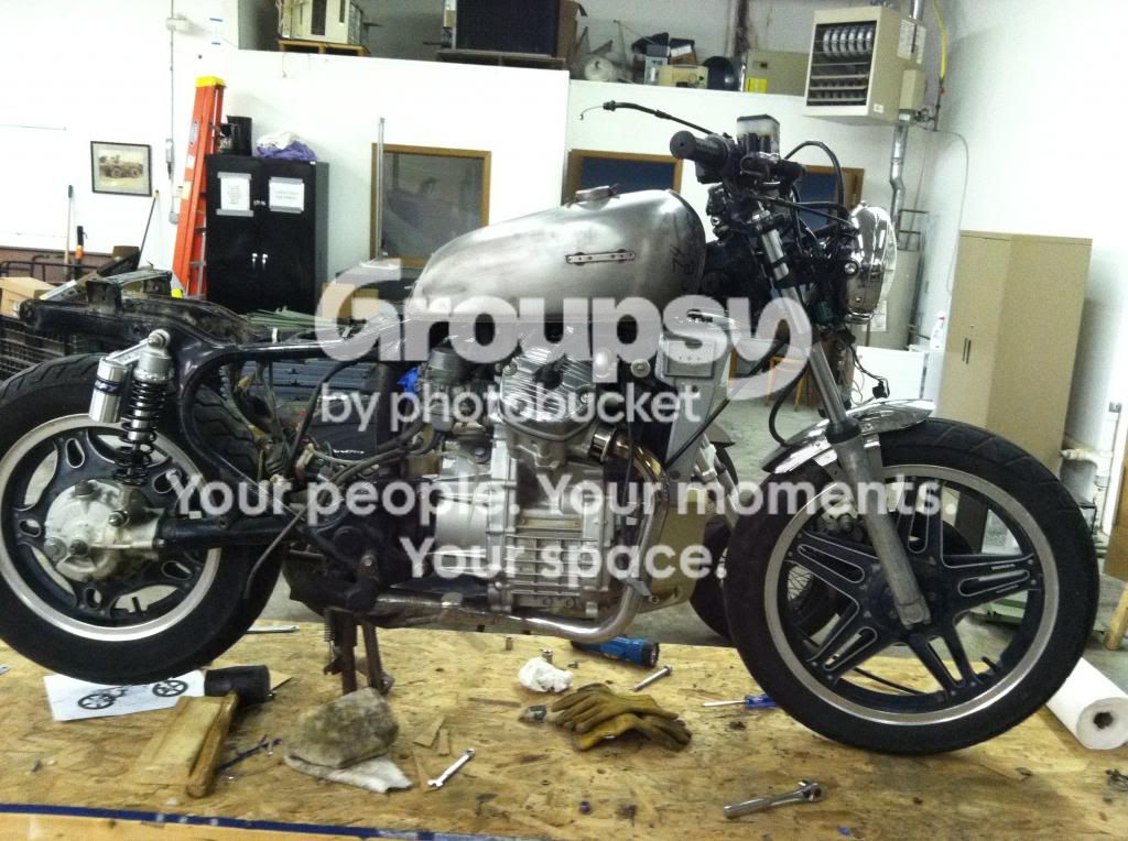

I decided to order a cb360 tank because the cx engine is so awesome I have to show it off. I plopped the tank on, I will have to move things around to get it to sit lower like I want, but I think it looks pretty good.
I have finished trimming the fender, but didn't take a picture.
Working on the headlight bracket now and will start on the seat pan shortly.
I'm thinking of using a pair of xl250 handle bars that were lying around.

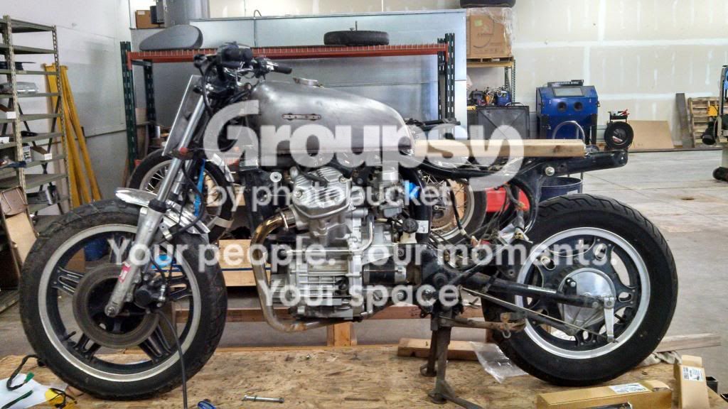

One week into the build and its already staring to come together.
That was about a week of progress, so at least right now I seem to be making progress.

where it sits at the end of the day
I don't like the headlight where it sits today I want it a little higher( to be aligned with the tank) and closer to the forks.
I'm thinking of putting some of the electronics in the gap between the triple trees and the tank to give it a cleaner look.
