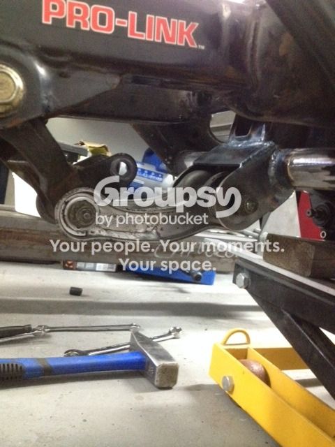

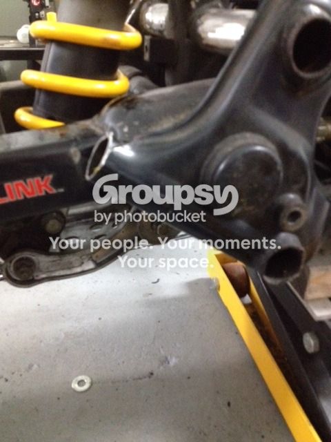

Alright, managed some progress today with mounting the lower link to the frame. I did try and use what was on the CX650 Euro frame but just couldn't get it to work right so I needed to make my own. I had some pieces order from my metal supply the other day and then also turned out 2 pieces on the lathe
Well you can see it in the pics below

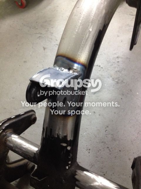

Now onto todays work........so I managed to get the upper shock mount built and welded on

it was very utilitarian and quick + if the bolt ever breaks the shock gets caught in the upper mount
