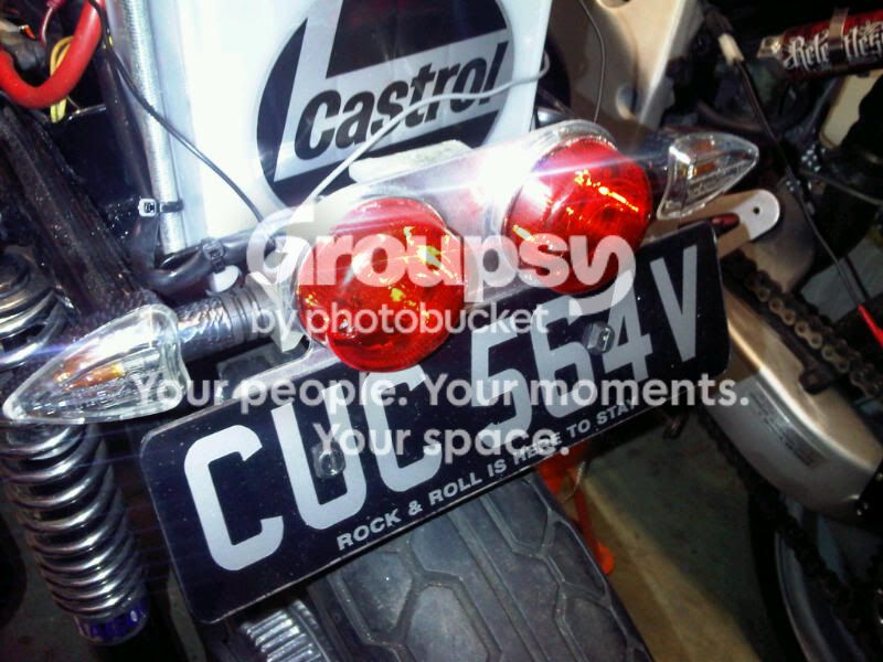

My new indicators arrived during the week and I think they are a massive improvment on the old ones i mocked up with
I also will be dumping the old warning lights cluster
