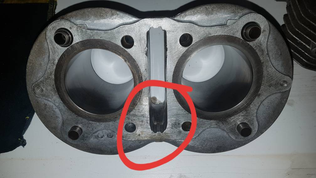

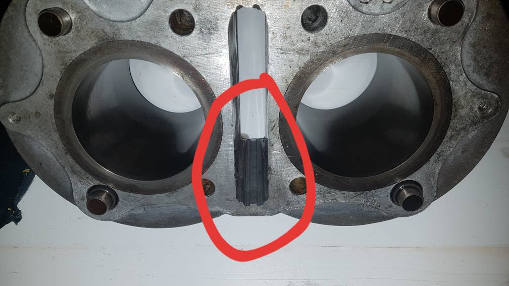

I am guessing the PO had welded the outside to reinforce the damage on the inside as it is on both sides. Do you think this will be an issue down the track or should i look at replacing the jugs?

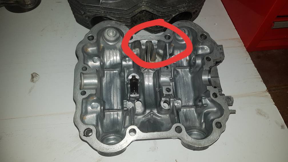

Here i have circled the seat for the cam chain guide, i am guessing the guide came loose at some point and has bounced around causing the damage. My question is, has anyone had this issue an would it be worth having it repaired or should i be looking for a new head?

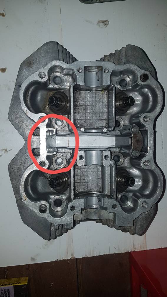

Here im guessing the PO has tried to smooth out the pitting on the combustion chamber, now i dont know a great deal about engines in general but the engine isnt going to run evenly if the combustion chambers arent the same size, correct?

The weld repair on the cylinder head seams fine, I would be concerned about the tensioner mount. I mean luckily heads for the cb360/cb250 are plentiful in ebay.
As for the tensioner that's just what they look like... old Japanese motorcycle welding wasn't what it is today
If you want to see a bodged tensioner arm, wait until i get mine out
Sent from my SM-G930F using DO THE TON mobile app
it looks like it was machined for a squish band? except that the bands are very unequal. weird stuff, I'd get a new head.
Its probably a cb360 head they was "repaired"
The 250 heads didnt have the squish. But the 360 ones did
Ok so new head it is... when buying the head would you recommend finding one as a whole, so rocker cover included?
