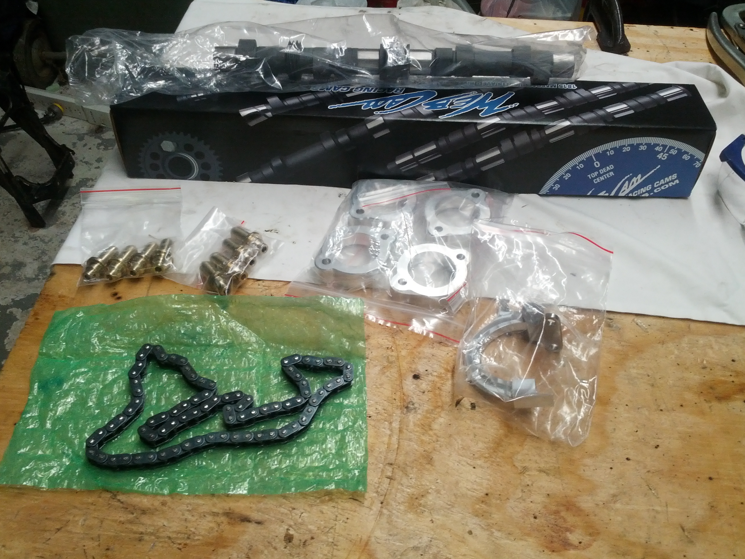

Got some parts in last week and I was pretty excited about it.. got my cam back from Webcam got the #3 hot street hardweld. Plus i got new double vleve springs from them as well. Then my parts from Kevin at ttr400 came in: exhaust flanges, heavy duty race cam chain, billet cam chain adjuster, and bronze valve guides.
Now the only thing left is to get my jugs bored and honed.. I am thinking about sending my jugs, pistons, head and valves to Golden Age Motorcycles for boring and honing plus get the valves and pistons some dry film lubricant and ceramic coatings for cooler temps and longer life. Might get him to do my valve guides and surface the head and jugs so its less likely to have the typical head leaks.
But I guess until I decide to do that I might break down the rest of the engine and see about changing the cam chain and adjuster while also looking at the crank and bearings for wear.

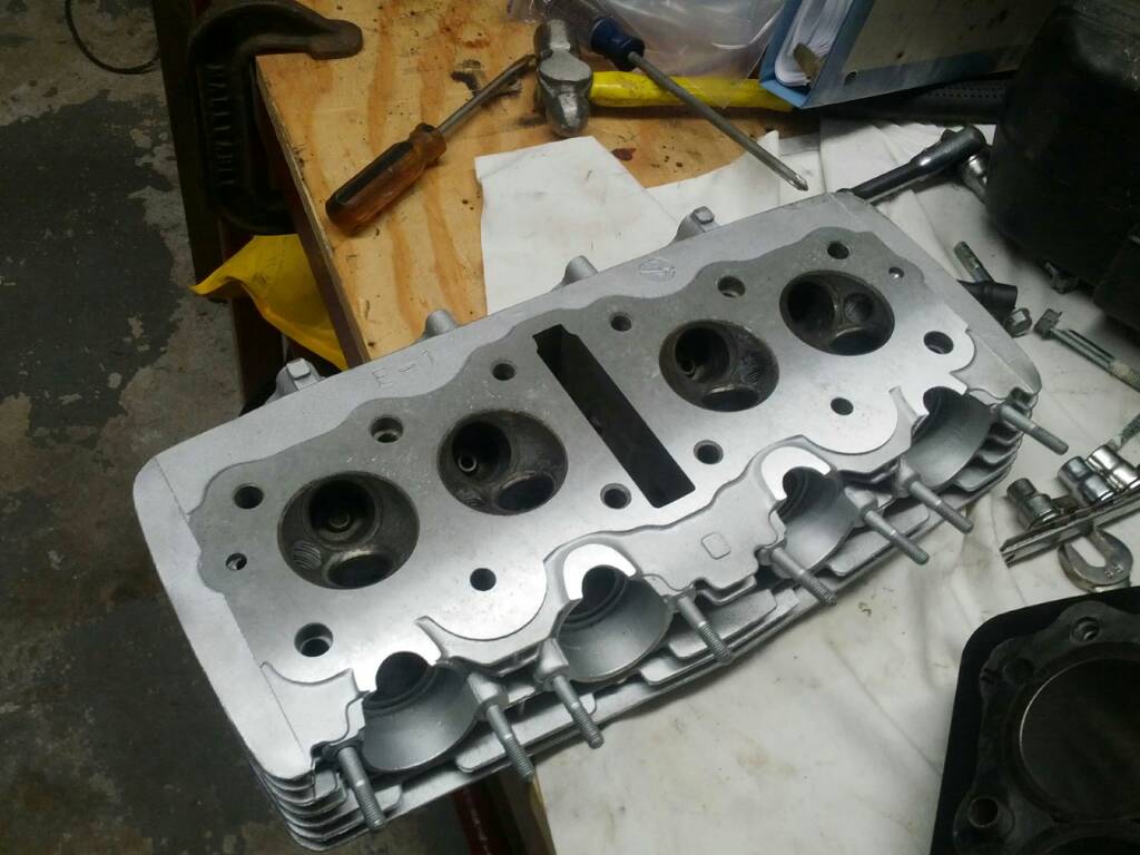

The jugs are being bored as of Wednesday afternoon, my pops dropped off the pistons and my head(getting decked) so they should be done by the time I get home! I'm pretty excited, I still have to break down that clutch and split the case to check the rest of the vitals for condition and what not. Only 4 days and a wake up till I get home! Also, 2 weeks till Barbs!
Re: "Dago Roller" Resurrecting a 350F gently
Just picked up my newly bored jugs and surfaced head! Pictures to come when I get home!
Shit looks nice, man! Was the head cut?
Yea I got the guy to surface it so its flat again. Hopefully it reduces the chance of head gasket leaking like they are prone to doing. And thanks!
Yea... I just fired my bike up the other night and even with brand new surface and new gaskets (good ones too) I had some oil dripping. I have to figure that ish out.
If you just put it together and its leaking. You might have to retorque the head bolts. Everything is going to settle in a "stretch" (in a sense) so it will loosen up slightly. Give it another torque down per manual order and specs and hope it seats better.
