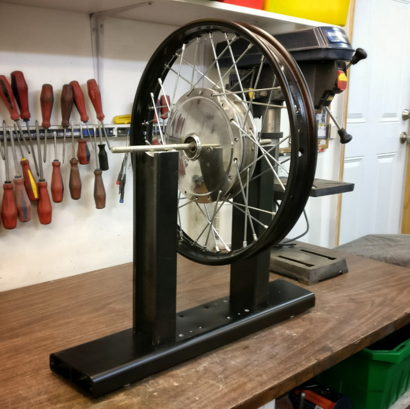

To true and balance the rims I made a wheel stand and spoke wrench, worked great.

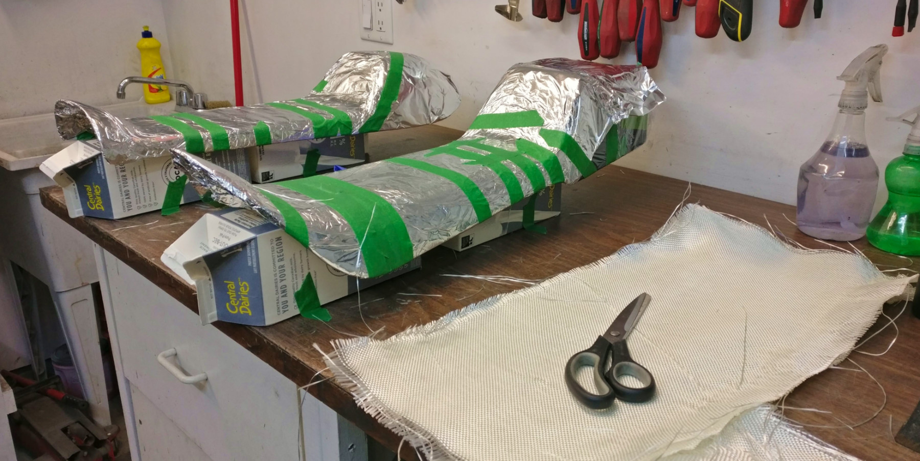

To create the pan, I covered the seat with tinfoil and just laid the glass over it, then cut it to size. Made one for the MB5 while I was at it.

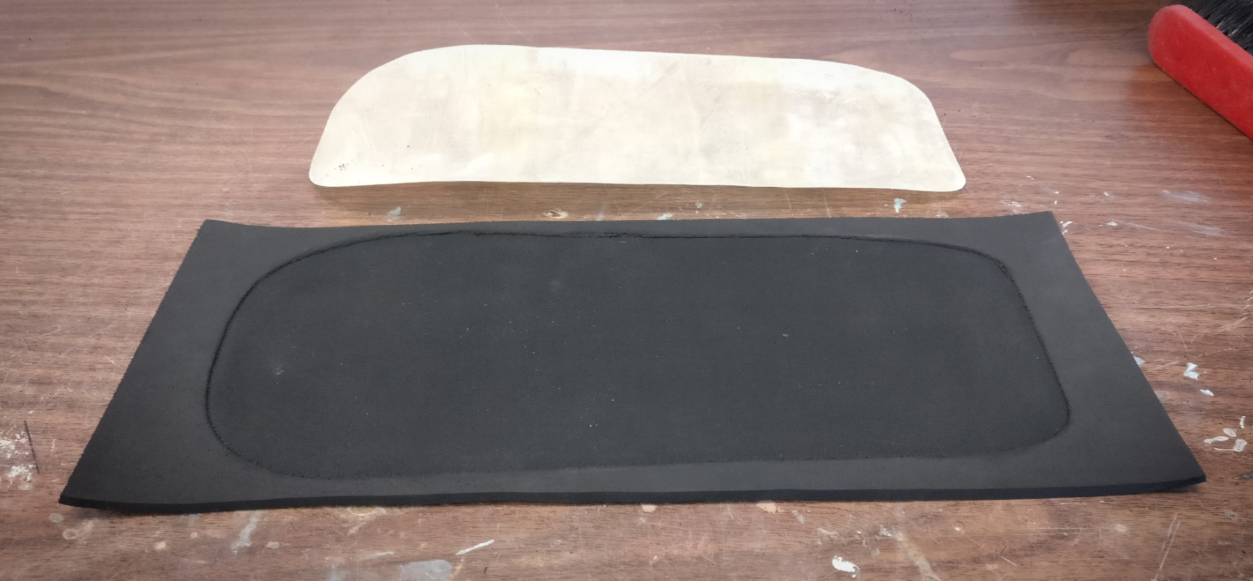

Then after gluing together three layers of the foam using 3M Super 77, I used sandpaper to create a recess in the foam so the fiberglass pan could sit flush. I didn't take a picture of the 350 version but here is one of the recessed section on the MB5 version.
After gluing the fiberglass into this recess I finished it off by cutting the foam to fit and then used sandpaper again to do the final shaping and smoothing. Pleased with how it turned out.

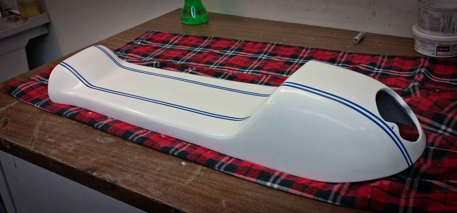

I was able to get a bit more done today, managed to get the stripe put down on the seat pan. I finished the tank last week and have that clear coated. I'll wait to clear coat the seat until I have another part or two ready so I don't waste a can of SprayMax 2k, its too pricey to only use half of it.

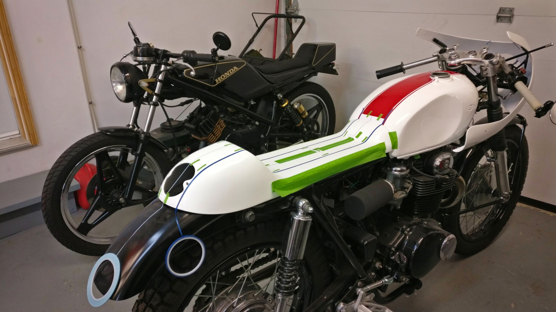

I find stripes look easy enough to do until you actually do them and realize how it can be a bit difficult getting everything straight and symmetrical. Took my time with it and mapped it out with some painters tape and such. Seems to look straight enough. Next up will be the fairing but I first need to finalize its mounting hardware.

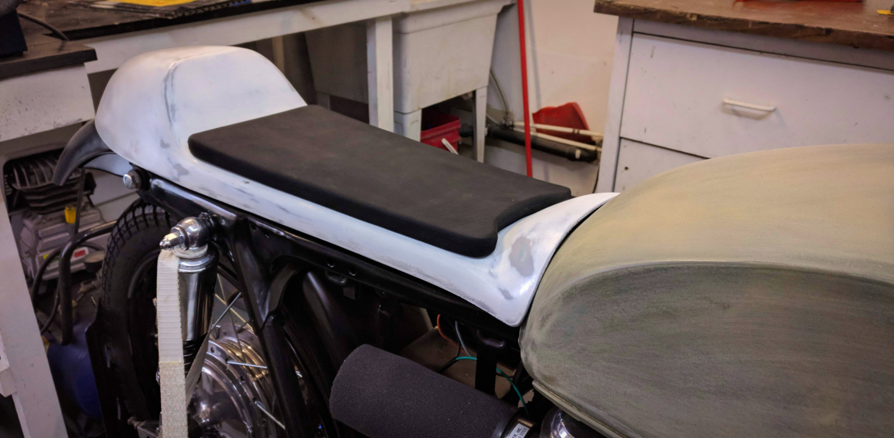

Threw the seat cushion and brake light lens on to see how it all looked.
