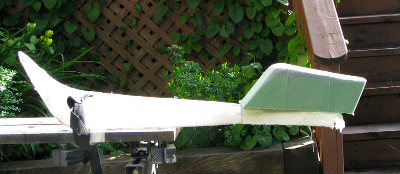

I was playing around with it last night and decided to use a similar shape to the stock rear end (tapered box). I have it almost shaped out now in foam, hope to finish shaping this weekend and get some glass on it. Will post some pics then. Thanks for all the feedback.

Made a bit more headway with the seat too. Finished shaping the foam and laid a few layers of fiberglass. I actually just came in from doing the fiberglass and don't have any pics, will get some tomorrow.

looks good. What do you use to hold the blocks together and what do you use to shape the foam?
Re: Project DEET- Mini Smoker
I use 3M Super 77 spray adhesive to glue the blocks together and also to stick them to the pan. For shaping I just use sandpaper (40 grit for rough shaping and 120 for finer touches). It sands really easy so any power sander would probably be too aggressive unless I had to take off a lot of it.
