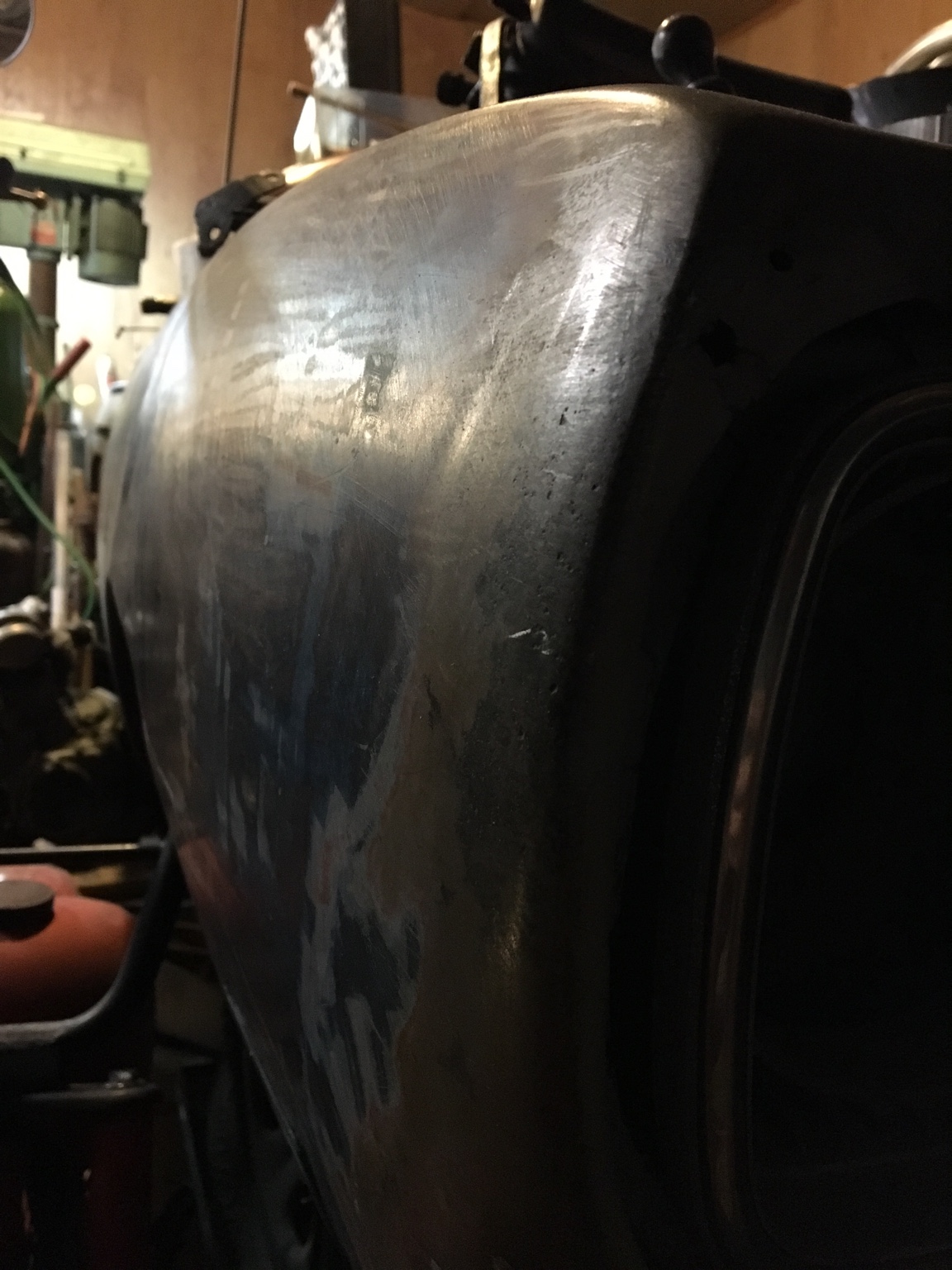

Dent in Tank best process
A damage like that needs to be hammered out then rolled in an english wheel to get smooth metal, which means opening it. Too damn much work! I'd just go with pulling it and tin/lead brazing.
I have the exact same issue with my tank. After much research and probably too many phone calls the best method I have found, that will pull sort the crease to near perfect with as little filler or brazing as possible is a metal worker who will open the tank up from the bottom via existing welds and reweld when done. This will obviously not be seen as is opening from initial welds and will be underneath the the tank. I hope this helps. Let me know if you have found a better method and your results.

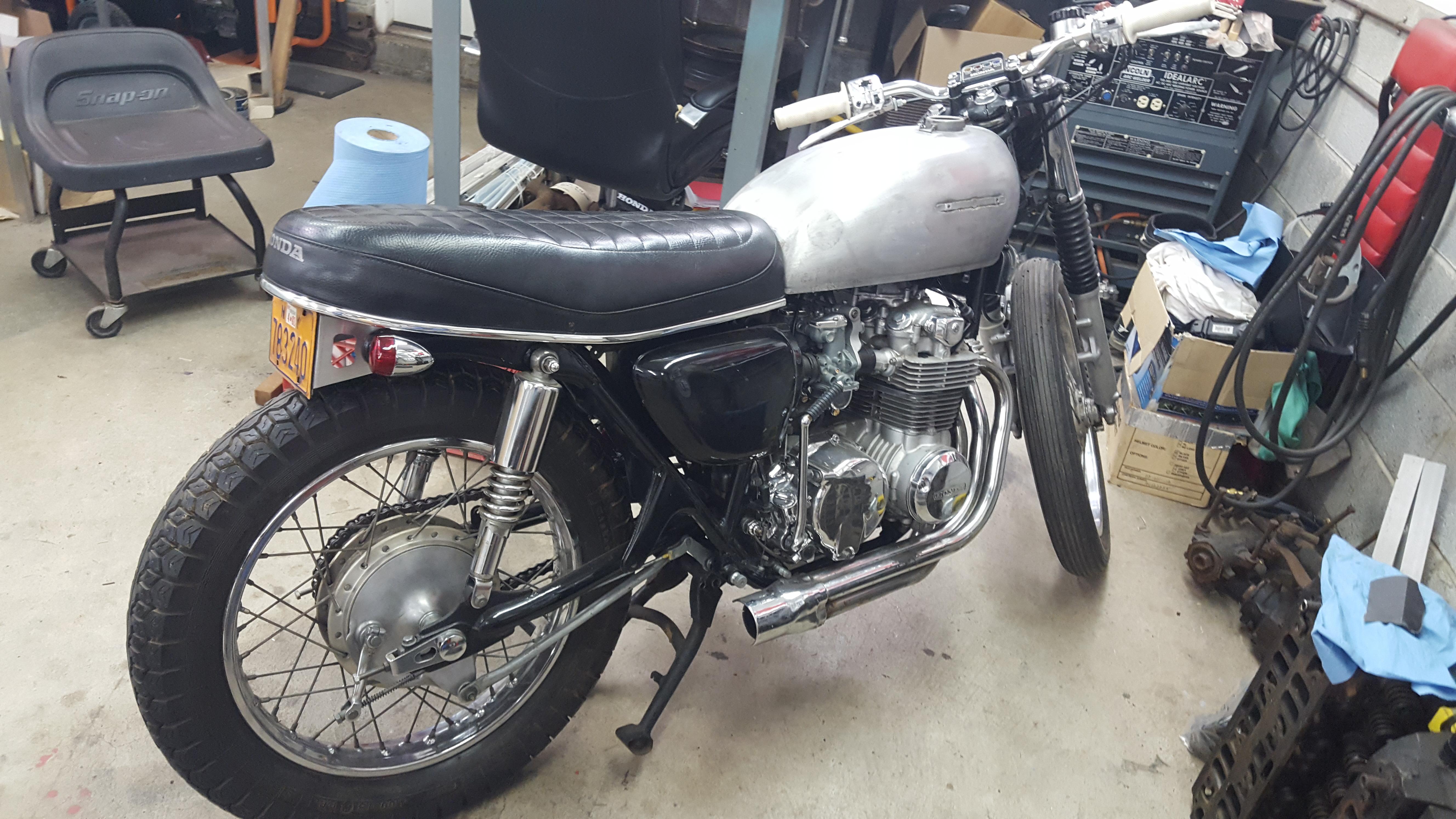

Yeah that's a hard crease. I got a fancy study welder since I knew I would use it a lot on my other cars/bikes. I would use the washer or stud method to pull it out gently(be sure not to pull too much and disturb the overall shape of the tank), then use lead, body filler, or both depending on what you want. My CB tank had 1 inch diameter holes for some home depot sight glass contraption someone put on. I welded them up and then leaded over the dents/weld. Might keep it raw for a while, the lead blends in pretty well

This thread is pretty old....but maybe I can help someone else out in a similar situation or at least provide some info. Plus I just like talking metal.
I read a lot of "feesable" solutions in this thread, but the best and fastest method, in my opinion, is to cut an access hole in the tunnel just big enough to squeeze your hand in with a dolly. Then use a hammer and slapper in a dolly-on/dolly-off technique to remove the dent and smooth everything to no-filler finish if desired. If any shrinking is needed you can do a couple of small heat shrinks and then re-planish with slapper and dolly to smooth everything out. Then weld up the access hole and you're all set. Cheap tools will work just fine, and you can have your local welder close up the access hole for cheap, just cut neatly.
The next best option would be a stud welder and slide hammer, but those are expensive, or time consuming to make. You would also need to use more filler with this method, but that's not terrible as long as you keep it 1/16" or less.
A rod through the filler neck would be tough to get a crease like that out. Especially because the tank tunnel doesn't leave much room to fish the rod in and work.
Do not try to shrink using a rosebud tip as I read somewhere in this thread. It puts out way too much heat to be isolated and precise. A welding tip works best.
Cutting the tank up and using an English wheel would not be a sensible ouption, as the posting member said. A hammer or slapper on dolly is the same as an english wheel. The same goes for a planishing hammer.
Also heating and hot-working metal is a poor practice. You will distort the entire panel. There will be a wide spread shrinking effect as the metal cools, and because the metal will be so soft you will get thinning and stretching wherever you try to work.
