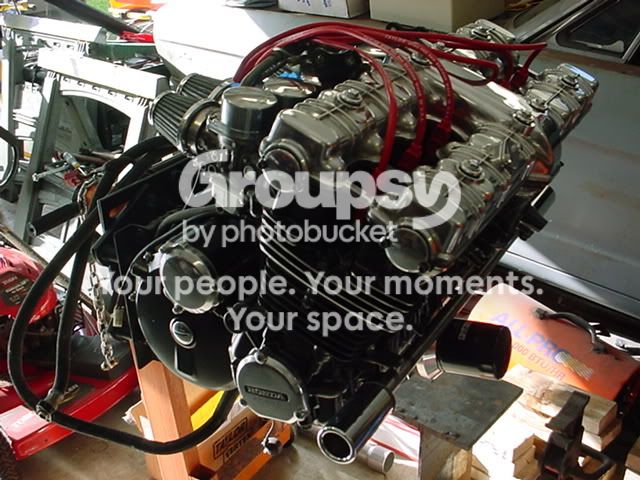

Why not make your own tach drive cover? I removed my tach drive entirely. Made a replacement cover out of aluminum, drilled the retaining holes, polished and installed it. Look on the right front of the cam cover. Tach drive gone!
