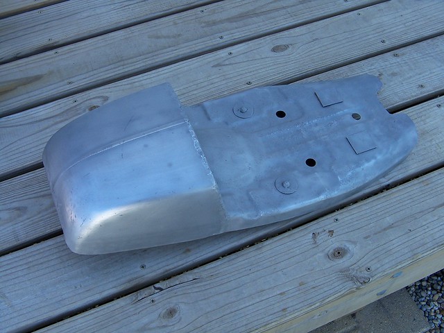

You could just make something on a stock seat pan. This is one I did using an old gas tank for the bum stop, but you could do it in fiberglass.
http://www.dimecitycycles.com/dccdiatribe/2012/01/dcc-tech-tip-building-your-own-fiberglass-cafe-seat-video-w-herm/
I'm sure you've seen this?
This is a good idea.
I suppose you could also make a fiberglass mold of the back of your tank then make plugs to experiment with.
