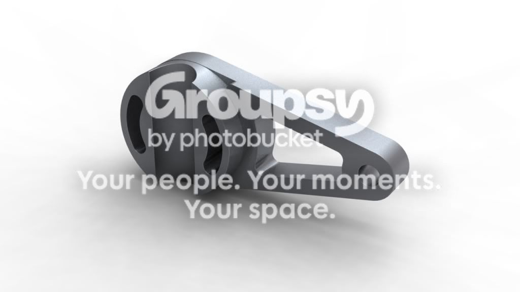

Well, if I get some downtime here at the office today I'll get started, I'll wing the dimensions for now, and they can be adjusted later relatively easily. I'll use the dimensions provided in the image to get relatively close. In terms of styling, I can do these exactly the same as the other ones, and we can make iterations later as well.

I'd say you should try to give it more of an old school look rather than new and machined. Make them look like they were supposed to be there in the first place. Maybe some tube shapes rather than machined arms, less details and instead of having the machined relief in the main arm, make it a hole or completely leave it out. Just some ideas...
Okay, I just finished up the brackets for the frame. For now I made them set up for .75" tubing, my reasoning is that we can use half inch material, and if we want to use it for a 1 inch frame, the brackets can have spacers in between them to make up the difference. I think that solution is a bit better than taking up the extra spacing with rubber bushings. People were mentioning having a pin that fits into a hole in the frame, like a throttle, but I haven't done that yet and it could easily be added later. This is going fast so I should have a rendering by the end of the day.

That's as far as I got, but the thickness of the material looks way off, those are 1/2 thick pieces.
I'm thinking the clamp doesn't completely surround the frame tube. I'm assuming there's some sort of gap on the original pieces that wouldn't require it to be 1/2" of original thickness. That way it could be like 3/8" thick and still have a little gap if it was clamping onto the 7/8" bar as well as be able to grip the 1"? Thoughts?
3/8 seems appropriate. I'll get on that.

Exactly! This is why they probably have the radius for 1" in the middle, but are flat enough that they can easily clamp down on both a 1" and the 7/8" tube mentioned before.
The picture above is looking good! I do have a question though. I assumed the long holes are curved are there to allow for a little adjustment as to the angle of the arm that sticks out, correct? Would this require the holes on the arm that the set screws are attached to be closer together so it has a little movement or are they supposed to be at the very ends of the elongated hole so they don't move? I've never seen these before, and I'm new to custom rear-sets, but I would think you'd want a little adjustment to adapt to more bike options? Just throwing out some ideas so correct me if I'm wrong...
