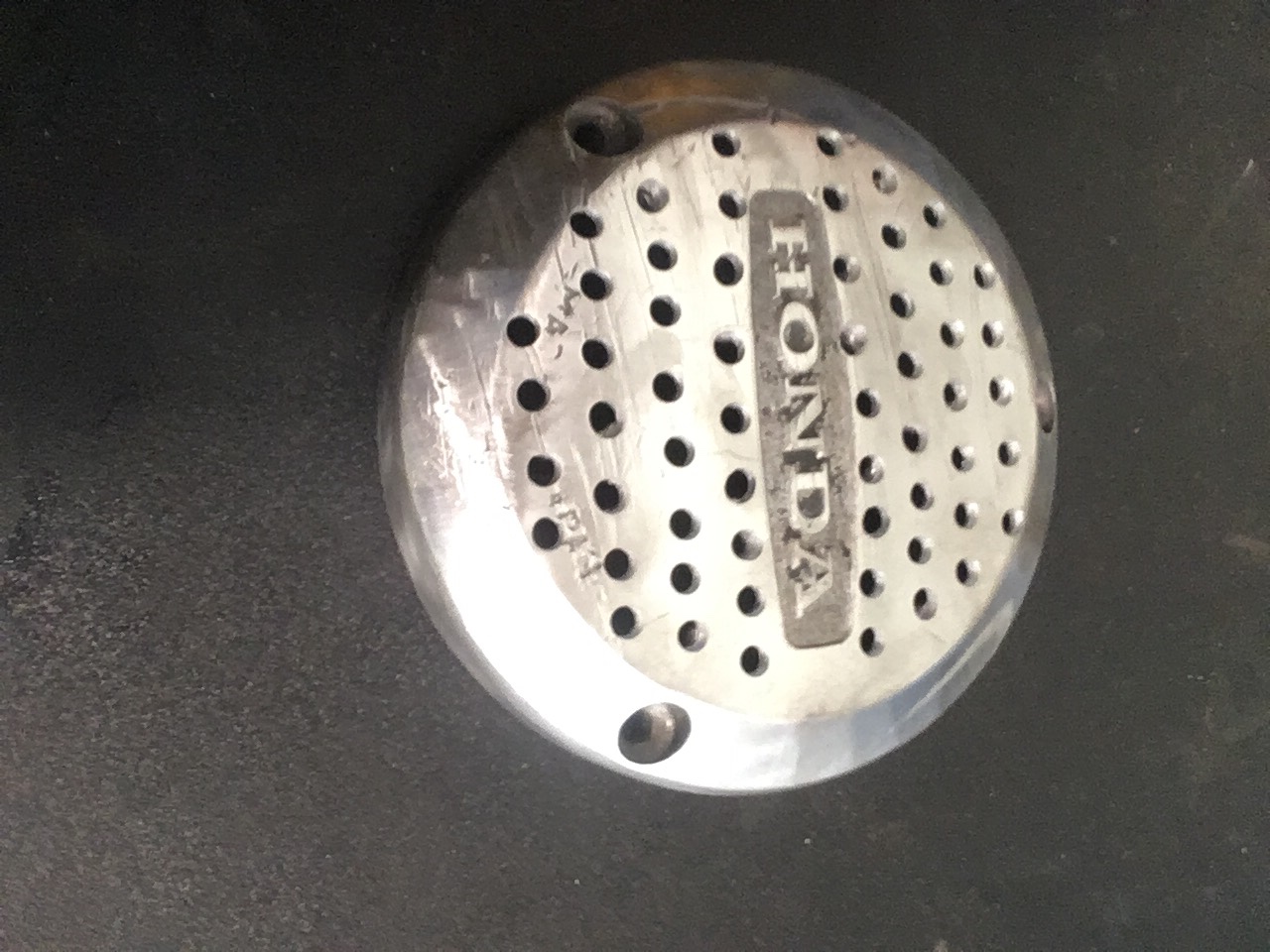

Here’s my next test. Since the bike runs with the cover off, my theory is it’s a heat problem. I’ve drilled out a cover I had laying around

Time to buy a nice simple DYNA S and see how that goes.
BTW. how hot is the ignition when it fails?
I may end up doing just that. I haven’t taken a temperature reading, but it’s not any hotter than the motor would typically get. I live in the city, so traffic and redlights are the norm.

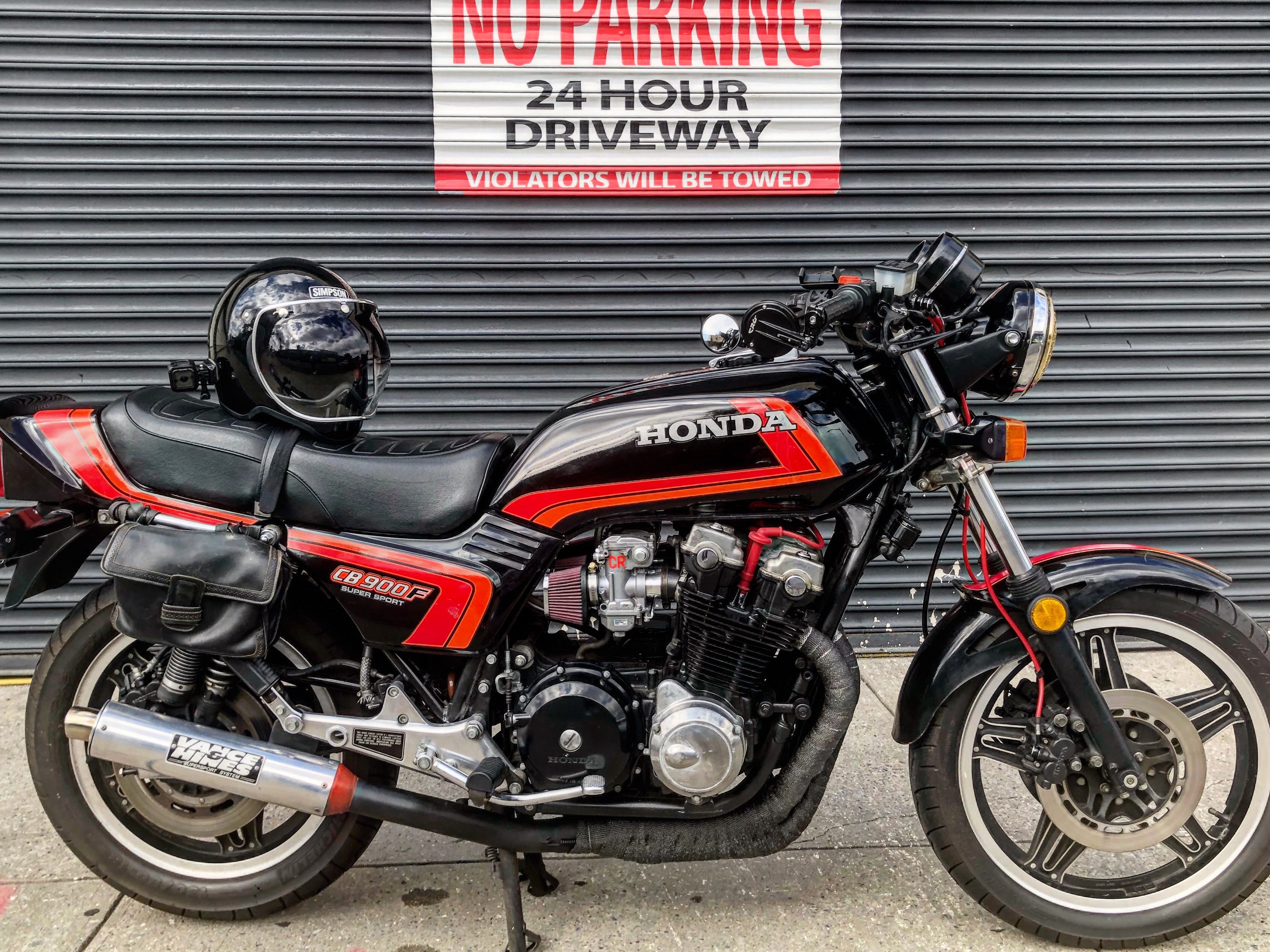

I think you and i conversed about this. I have a 900f pictured below.
When I first bought it, batteries kept dying, all sorts of shit.
I bought the Cycle X 3 phase thingy (its really a brit charging system) installed it myself with a new battery, and havent had a problem since (well, the battery DID die thereafter when I had to ride 2 up with a friend whose bike broke down in the dead of night. With my headlight on and the extra load, it died just as we got where we needed to go. I ran it a while after with the headlight off and it was fine).
There maybe be an issue in your particular bike that is causing this.
