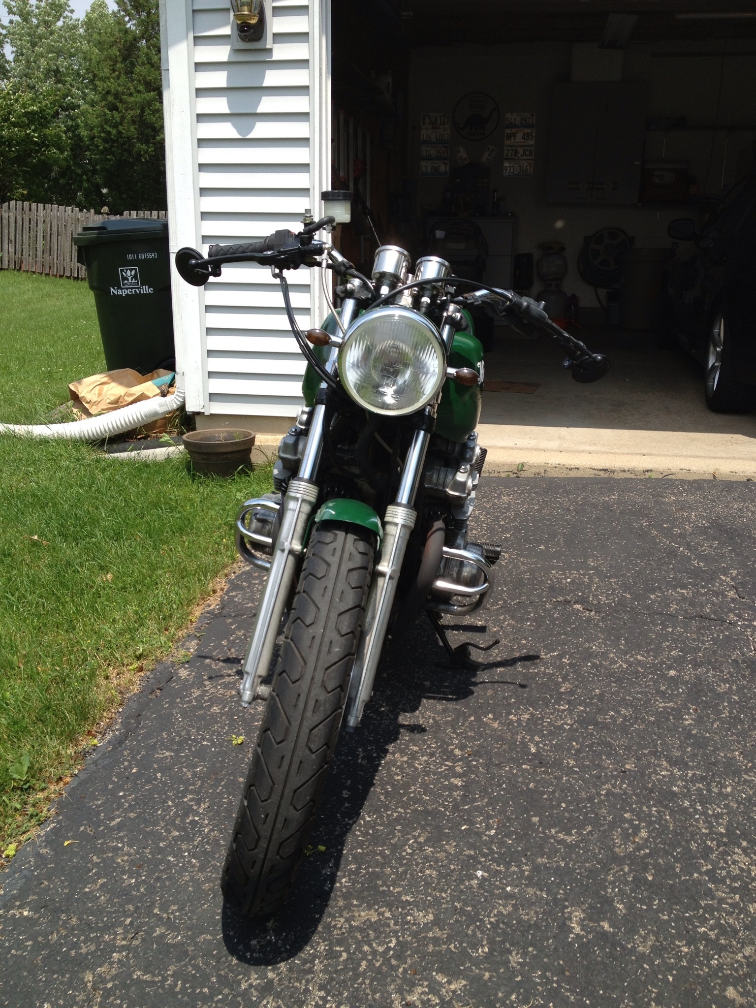

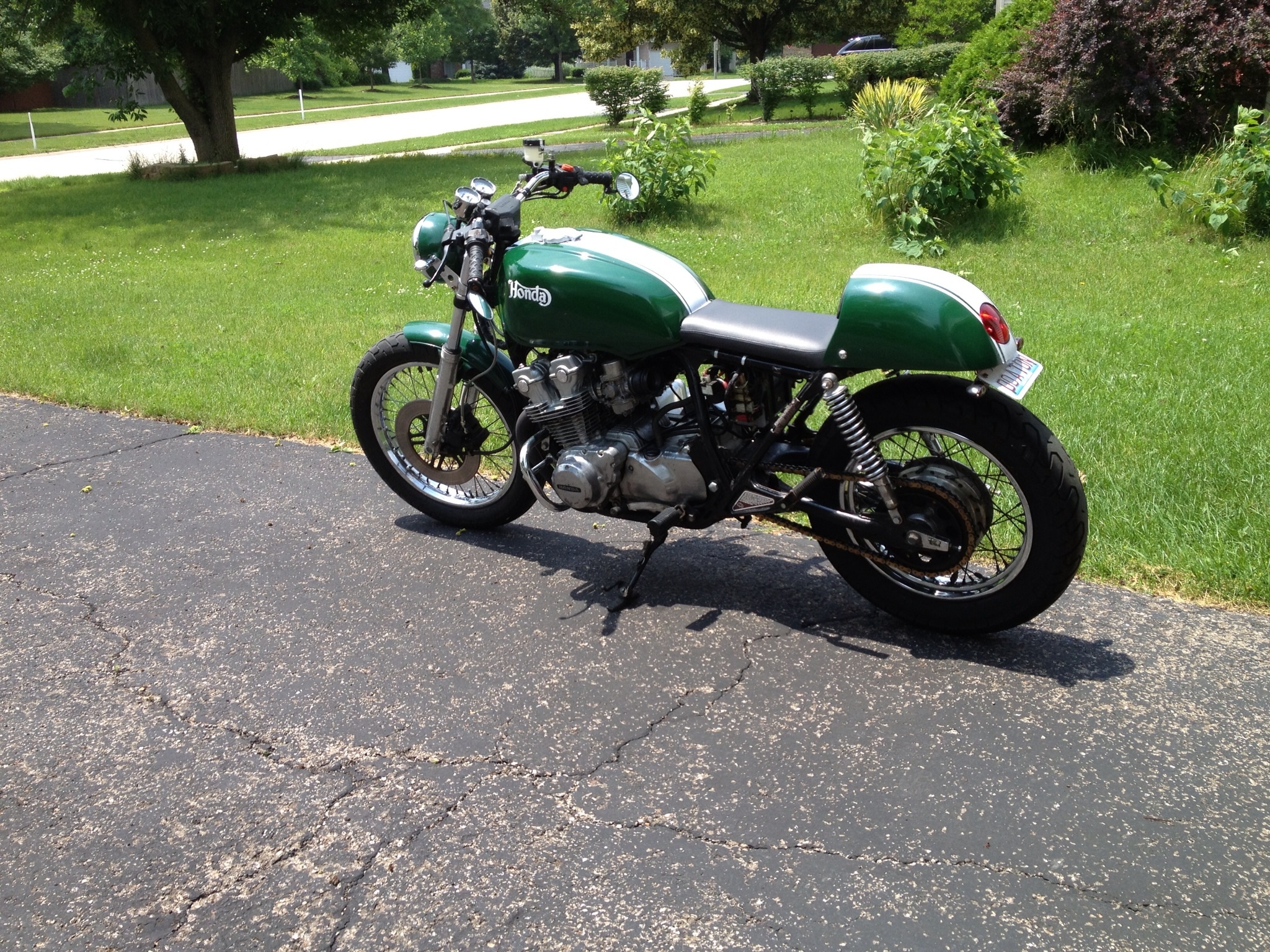

It's been a while due to work, school, family, life , etc but I finally got her about 95% done. (But they're never really done, am I right? Lol)
Without further adieu, here's ___________ (she still needs a name)
They are never 100% complete. You build and ride and modify and tweak and ride and change and so it continues as you work out what you and the bike really need to do to work together. Often the changes undo what you did first time around to improve comfort or it's the search for better handling and performance that sucks you and your wallet into that black hole.
Other times it's the "look". What looks great first time round sometimes looks old and tired 10 minutes later. Other times we build what we had in mind and decide that we don't enjoy riding it and change it around to make it work. It's like any relationship - you both keep evolving until one of you stops changing and the other starts to look for a new play date.
