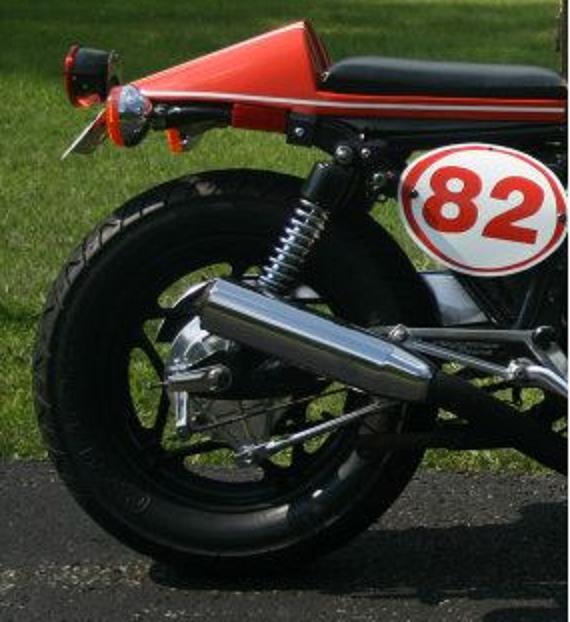

What rear wheel you got on there rocketrich?
Good lookin DOHC.
rocketritch said:
Stock comstar.
Dude: I don't think so...
Looks more like a Zooks snowflake that I've seen mounted on other DOHC CB750's but not quite... that's why I asked.
Stock Commies are more solid than this... last pic is my Zook's rear, close but no guitar. Hmmmmm.

Then I am stumped as well. It is a 1982 Nighthawk 750sc, and the wheel matches stock photos on the interweb.
Ooooohhhhh, there ya go. That's what I needed. Thanks !
Nighthawk I did not know.. That make sense, stock wheels for a SC then.
Now you got me wondering if those will swap with regular plain old everyday Comstars (reversed or original). They look to be a hell of a lot lighter. ::)
