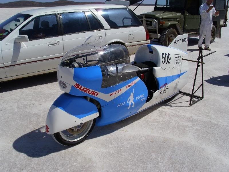

You can see that the rider is fully encased by the fairing and the fairing comes to a point in the rear. Though you can't see the front side, you can bet it's as circular as possible (including around the forks and front tire). There's likely to be an air inlet for the engine, but that's about it.
[/quote]found a pic of the front

Sonreir I have been reading the posts of http://www.landracing.com/forum/index.php/topic,7612.0.html
And they said more time needs to be spent on developing the tail like Bret did on his bike.
However they like other forums have criticized Bret's design because it is sucking him off the bike...so he duct taped his hump on his leathers and fixed the problem. (Love this guy)
"Most of us that have raced LSR bikes have know for some time that the "back end" is what it is all about
When we used the windtunnel back in the early 1970's for the 125c.c. Can-Am effort we saw what a
special long tail did for Aero. What we did not know at that time was how to get the chassis to work
with the long tail........Brett and Joe got the bikes to handle....they have solved this problem. Also until resently the rules did not allow for a "long back end"....Thankfully the "officials" have seen the error in their "old rules" and the sky is now the limit for a sit-bike"
The complete string is worth a read...I have attached a pic of Joe Amo's bike.
